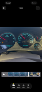

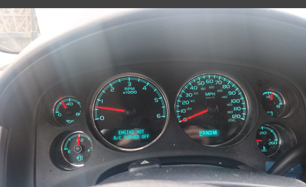

I have a 2008 Chevy Tahoe, purchased it about 2 months ago and trying fix all issues. However, this one has me stumped. I can be driving and the gauge will shoot over whichever way and say one of 2 things. Engine overheated Idle engine or Engine Hot turn off A/C. We have changed the Temperature sensor, the plug that plugs into the sensor, thermostat, the water pump, and the hoses. I haven't changed the Radiator yet or head gaskets. Has anyone else had this issue? If so, what did you do to fix it.

Strange that the gauge shows low temp but the message is for hot. Can you watch the PID for the engine coolant temp with a scanner to see what it's reporting as this happens? I bet the coolant temp sensor is still mis-reporting and the PCM reverts to "hot" as a default. Just a guess on my part.

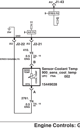

+1 on checking a scanner for the temp..
Both wires go the ECM, I would think a bad connection should only swing one direction..
(Unless as Fless suggested it may default to hot when signal is bad)
A leaking head gasket shouldn't swing stone cold.
Another bad sensor with the exact same symptom seems unlikely.
I wonder if it could be a bad ECM or gauge cluster..
Might be worth checking/cleaning the pins on the ECM and check yellow wire..
(If yellow wire had a break, that occasionally contacts ground)

I'd check that yellow wire real good before buying another ECM..

I changed it because part of the Custer was broken like someone hit it. But it has the issue before I changed it. No it didn’t have to flashed ect. There is a place in TX that programs the ecu to your vim, if we go that route. Right now we are going to chase the wire from the temp sensor to make sure there is no break in the wire to the ecu.
