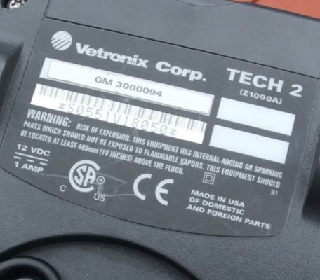

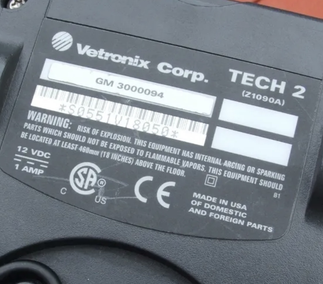

First of all, just because something is made in China doesn’t mean it is crap quality and second, the real Tech 2 is made in the USA. The real Tech 2 also weights about twice as much as the clone.
TollKeeper
Feb 21, 2010
3,600
7,571
Brighton, CO
Made in the USA with Foreign and Domestic parts... So not entirely accurate. The USA part could be them throwing stickers on it, the rest came from China. And those stickers could also be possibly made in china. As long as some assembly happened in the USA, they can say that. And it also kept the GM union happy.
I recently bought a Tech2 Clone from Canada used. Who knows where it came from originally. I used it just last night to recalibrate my HVAC. I used it when I replaced the head gasket, and after for a random misfire.
270 bucks well spent, although I wish I had gotten the hard case.

More like assembled in the USA of foreign and domestic parts. Connectors, chips, boards, lcd display and even the plastic housings made in china. Not profitable enough to make such a low quantity of those type of parts in a U.S. factory....unfortunately. Or could even be a slick trick and the sticker is the only thing made in the USA.

Geez, people just want to argue about everything. Whatever then, I don't know anything. I haven't been using real Tech 2's for the last 15 years or anything.
21,322
30,319
Bosch and Vetronix shipped production offshore by around 2010. My 2017 model looks identical to one made in 2010 and even has the same sticker as yours and mine was shipped from China.
After 5 years of near daily or weekly use, I have replaced the Candi, the VCI module, numerous OBDII adapters and the main cable and the PCMCIA card with the software as well. The Real Time Clock failed in the self tests years ago but does not seem to affect the unit. Amazon reviews tell of dealerships buying the cables and adapters all the time to keep them running.
It is my belief that the Chicoms kept making them after Vetronix moved on to the MDI and MDI2. They were probably thinking, why shut down production for something when there is still a market for it?
