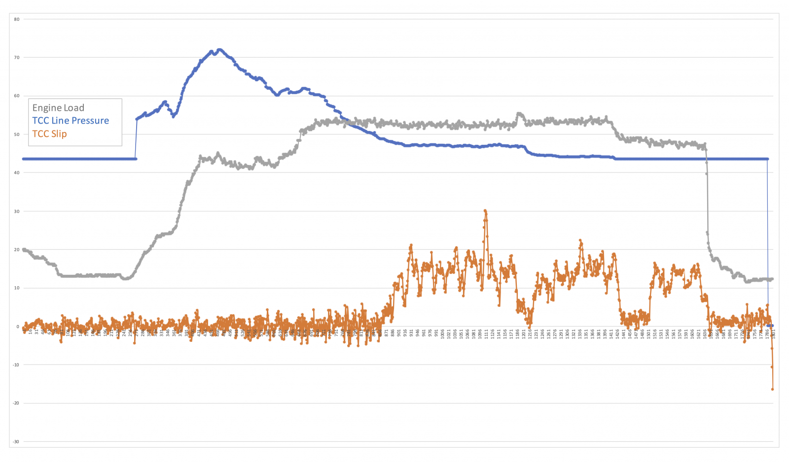

I discovered this on my 2011 Yukon 6L80 awhile back and forgot to share it.
This is primarily TCC engaged in 5th gear (or possibly 6th) in the sub 2000 rpm range, with desired TCC slip of '0' (programmed not stock).
At low load, the TCC line pressure has a lower threshold, effectively the initial pressure offset or minimum effective pressure.
As load is increasing (positive derivative) the TCC line pressure ramps up as it anticipates higher load and is trying to get ahead.
However, at steady load, the TCC line pressure continually decays back to the minimum, which allows for slip to occur. It is almost as if there is a separate desired TCC slip factor which is occurring inside the PID loop, allowing for the pressure drop. In any case, as you can see a steady low rpm load like going up a steady incline will not hold the pressure very high above the minimum.
Keep in mind, there isn't a TCC line pressure sensor. The computer is only estimating the line pressure, but you can still see that it is trying to decrease the pressure. So the only way to compensate for this in a tune is to increase the offset pressure and/or the gain so that the minimum is high enough to maintain zero slip under high load low rpm.
In any case, as you can see a steady low RpM load like going up a steady incline will not hold the pressure very high above the minimum.
So the only way to compensate for this in a tune is to increase the offset pressure and/or the gain,
so that the minimum is high enough to maintain zero slip under high load low RpM.

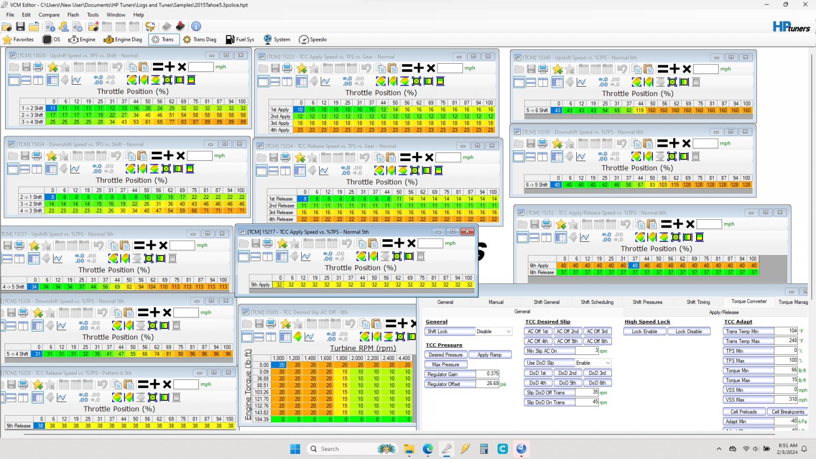

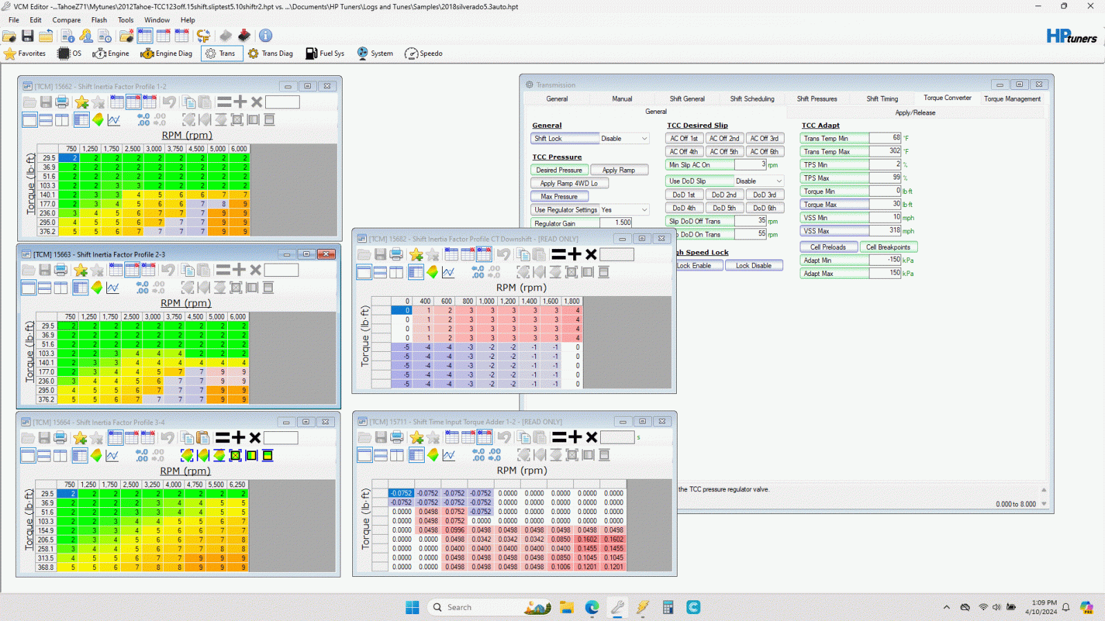

Here's some changes compared to the 2018 silverado tune. shift times, inertia tables and closed throttle downshift.
The gray '7' cells were 8's and 9's in my stock 2012 tahoe tune.
The red shift time cells are that much slower compared to the 2018 silverado. The blue cells are that much faster compared to the '18 silverado.
TCC adapt settings at the right..

Here is a simple answer from AI by pasting your graph and asking for corrections.
  • Orange (TCC slip) spikes to ~10–30 rpm as engine load climbs and line pressure (blue) holds ~45–60.
  • That’s classic: not enough clamp in the mid-load band and the ramp isn’t adding pressure fast enough once slip starts.

  • Duty to hold: ideally <85–90%.
  • If you still see 10–20 rpm oscillations right in mid-load: add another +10% to PCA 63–84 kPa at Line 1200–1500 kPa in 5672, re-cap 6.5 psi, and bump +20/+40 ramp cells another +5%.
This sequence directly addresses the part of the map your graph shows slipping (mid line, mid PCA) and tightens the ramp only where shudder forms—so you keep the smooth tip-out you worked on while erasing the residual buzz.
