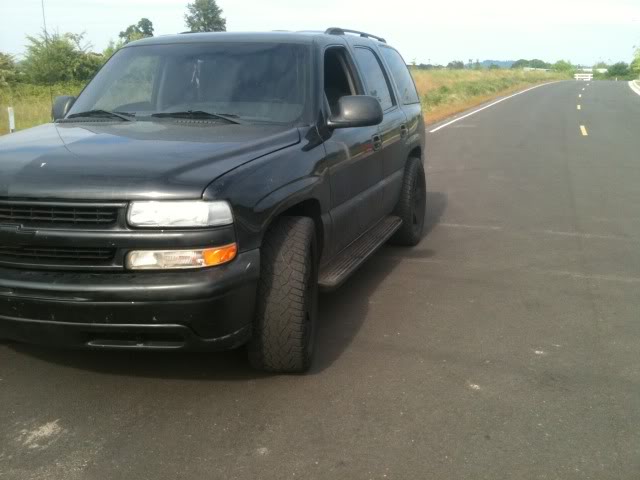

Under the front doors are two bolts that turn into the keys which push the torsion bars down giving more lift in the front. If you turn the bolt clockwise then it will lift the front so you shouldnt scrub, check fender heights too so your level f/r
Oh wow, nice! How many turns does it take? How much can it go?

It all depends on what your fender height is now and generally a alignment should be done after cranking. Best practice is jack the front end up but it can be done on the ground. It may take 2-10 turns depending on height now. You can crank them a lot more then needed to obtain level stance. Measure fender height on level ground then crank each key the same number of turns to get the desired level height or each one to reach the set number.

So your lowered?
You can fit 305/50s?? Nice ride!!!

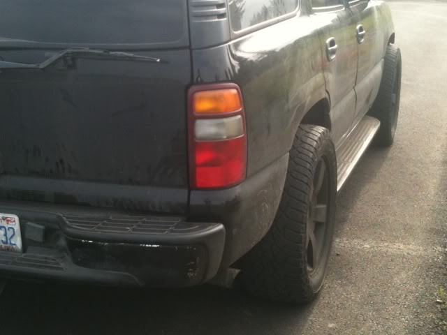

Damn tires rub like crazy in rear with 5 ppl in car. Had to cut out a bit of the wheel well liner, right where the shock bolt is in rear. Still may put on some spacers, but dont know if i need studded ones or not. Thinking 1/2"
