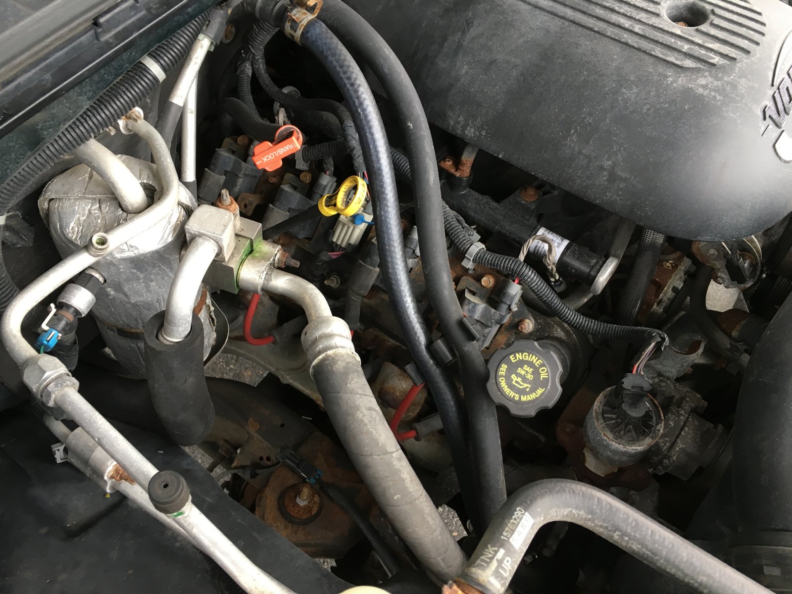

In the process of the fan swap, i also changed out the:
water pump w/gaskets
oem thermostat
valve cover gaskets/grommets
power washed/cleaned engine bay
and replaced some broken retainers/clips with new oem parts
Only thing i couldn't do was the front main seal. Damn bolt was stuck on there, so i'll have one of the techs from work take care of that for me. So fare driving the truck for several days now and no issues what so ever. Temps are dead on, a/c is ice cold and the power man oh man the power, lmfao.

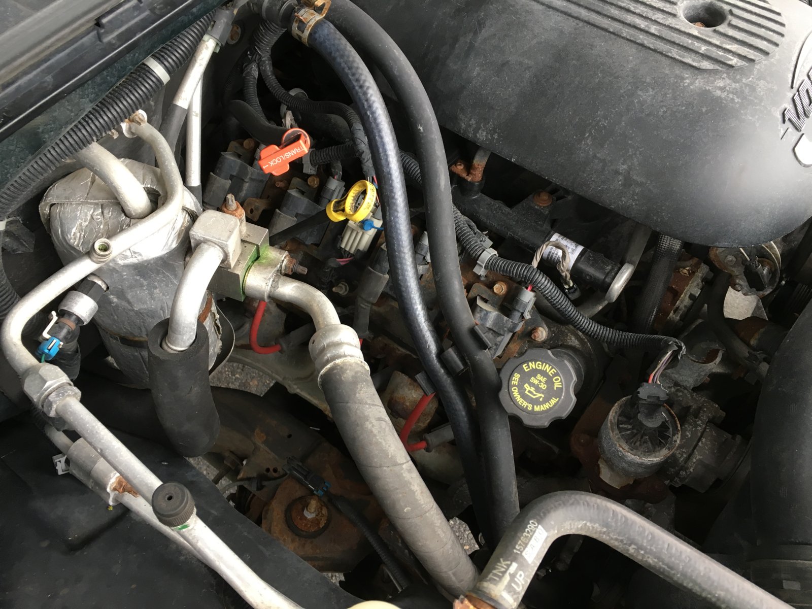

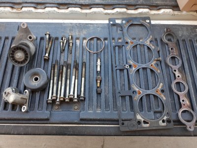

So the oil catch can was installed on 10/01/20 and working, also changed out the 19yr old belt idler, belt tensioner and a/c tensioner.
So noticed 2 exhaust bolts broken on the driver rear header, checked with a needle to see how far the bolt broke and it is flushed with the head.
Got with 2 of my co-workers to do the job, worst case they had to remove the head to take out the rear bolt that's closest to the firewall. So just had to get everything needed just in case they had to or not have to remove the head. Got the call a couple hours later, head had to come off as expected.
Used all OE parts with my special discount: 1 head gasket, intake gasket set, 1 exhaust gasket, 6 header bolts, steam port gaskets(Autozone), 8 long head bolts, 5 med head bolts, 2 short head bolts and an oil change.
Asked for pics but he forget to take them, so ill post up the old parts removed for proof. LOL

Here they are extracted and before in the head. Also the spark plug in the pic was split down the middle, so that was also changed out along with coolant sensor.

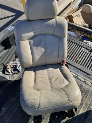

Putting in 2nd row buckets?
I always liked the look/setup better, not as crowded inside....wif wasn’t a fan cuz 1 less seat.. I changed her mind with the 19 yuk.... so much nicer imo and my family fits... f everyone else ..:)

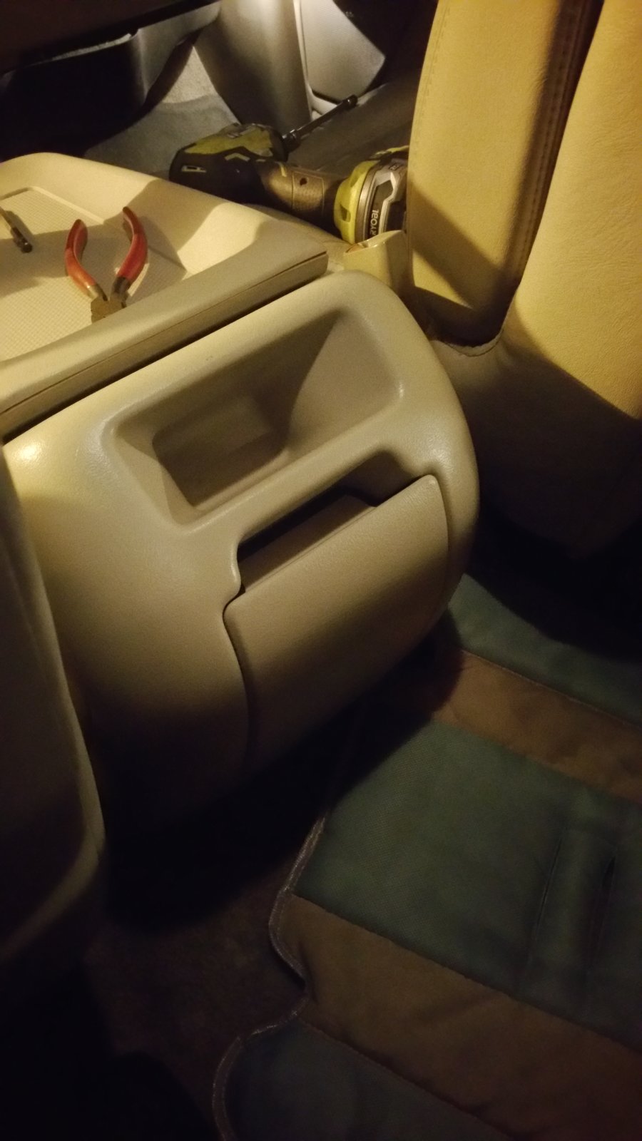

Swapped out the rear view mirror with another, the comp/temp lcd kept going on and off.
Replaced the rear half of the carpet with one that had no stains, and while I was there wiped down the floor before reinstalling the carpet.
Also swapped out the 2nd row bench seats that had the middle lap over seat belt with a newer year suv that has the middle shoulder belt.

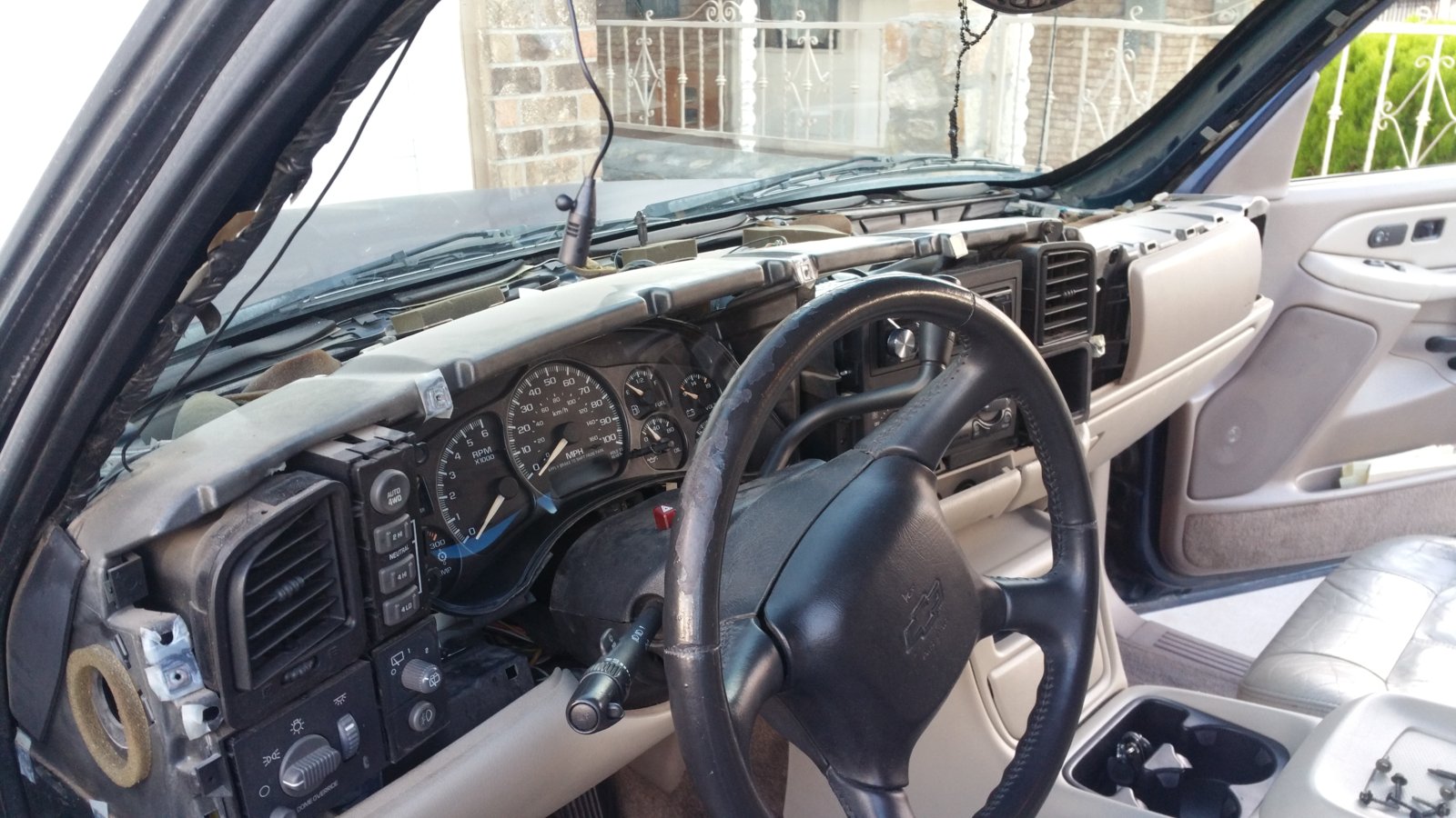

Changed out the front and upper a/c factory conteol knobs from an Escalade

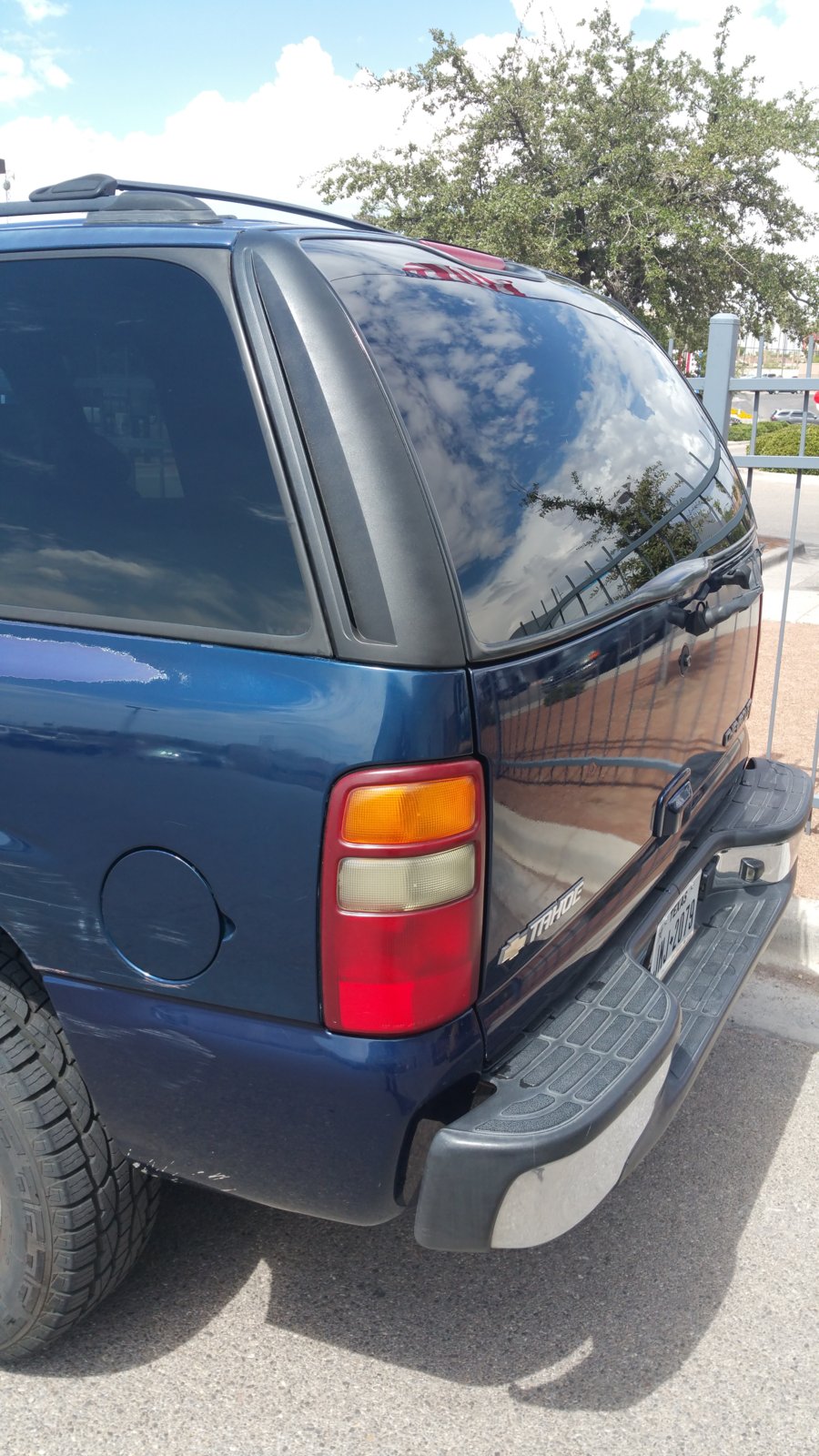

Did the rear hatch glass with molding from a 05-06 SUV
