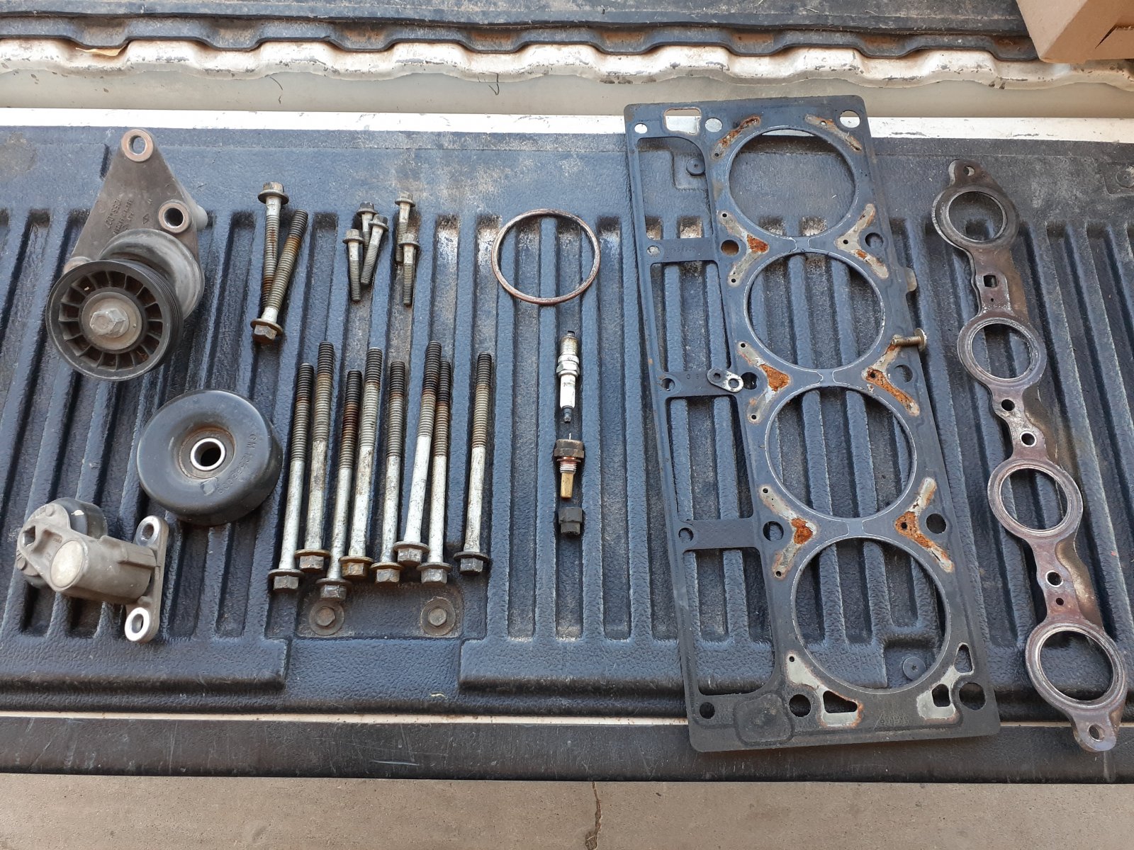

So the oil catch can was installed on 10/01/20 and working, also changed out the 19yr old belt idler, belt tensioner and a/c tensioner.

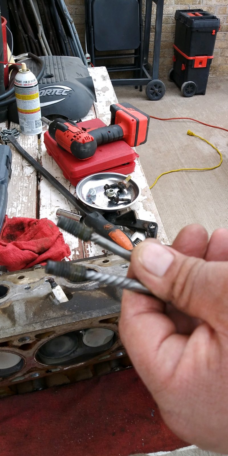

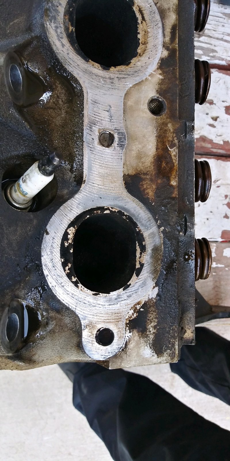

So noticed 2 exhaust bolts broken on the driver rear header, checked with a needle to see how far the bolt broke and it is flushed with the head.
Got with 2 of my co-workers to do the job, worst case they had to remove the head to take out the rear bolt that's closest to the firewall. So just had to get everything needed just in case they had to or not have to remove the head. Got the call a couple hours later, head had to come off as expected.
Used all OE parts with my special discount: 1 head gasket, intake gasket set, 1 exhaust gasket, 6 header bolts, steam port gaskets(Autozone), 8 long head bolts, 5 med head bolts, 2 short head bolts and an oil change.
Asked for pics but he forget to take them, so ill post up the old parts removed for proof. LOL

Here they are extracted and before in the head. Also the spark plug in the pic was split down the middle, so that was also changed out along with coolant sensor.

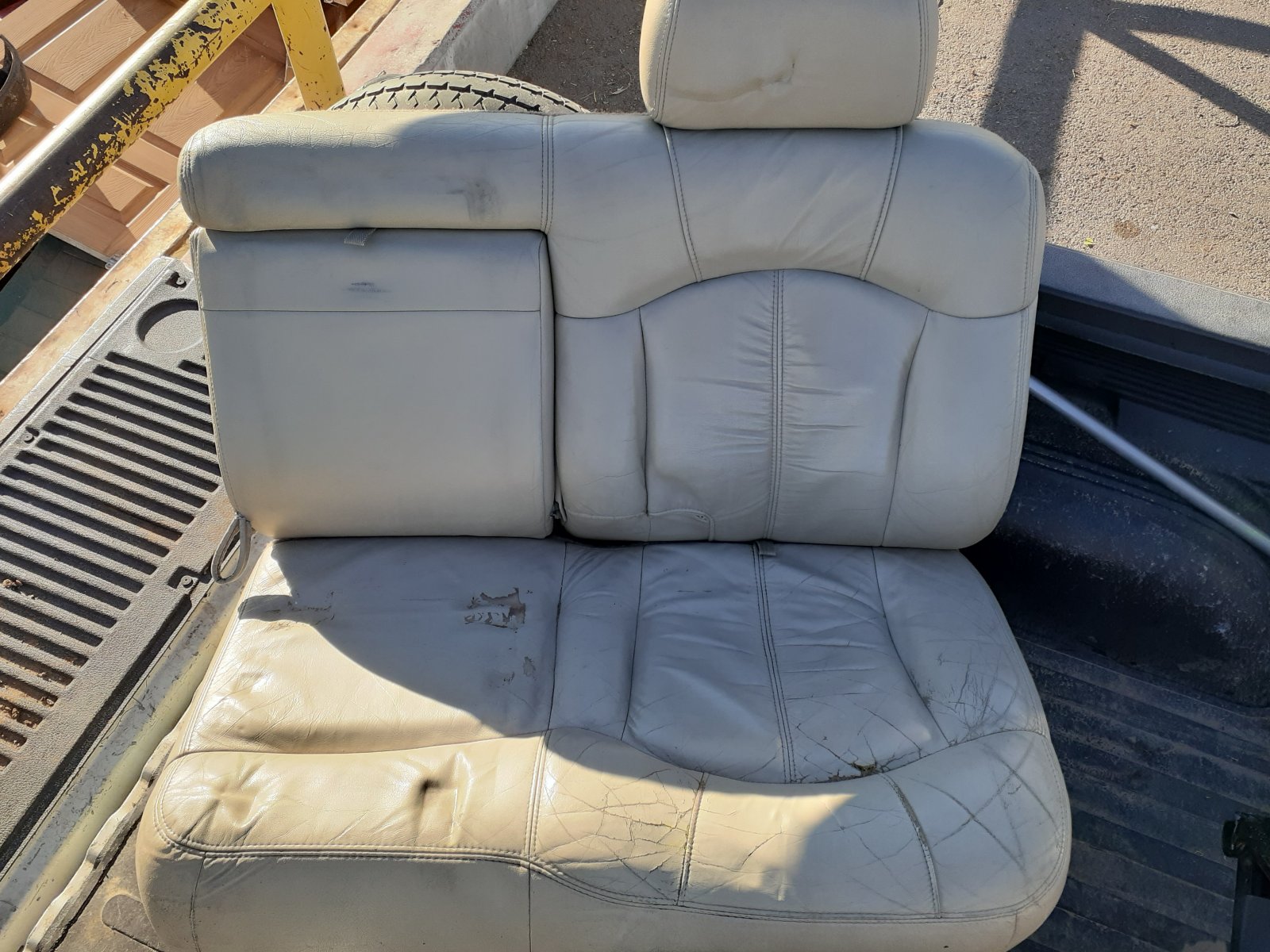

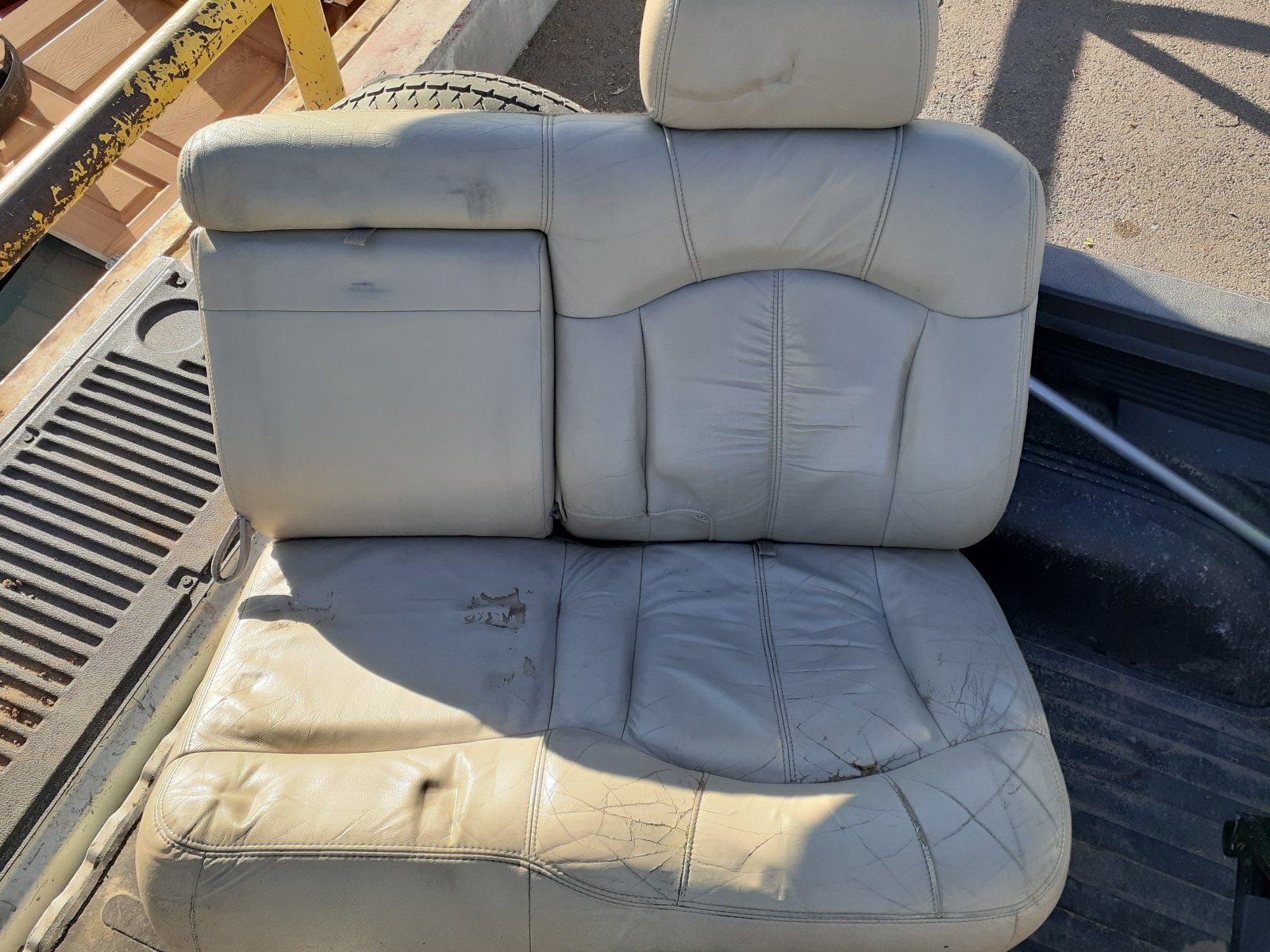

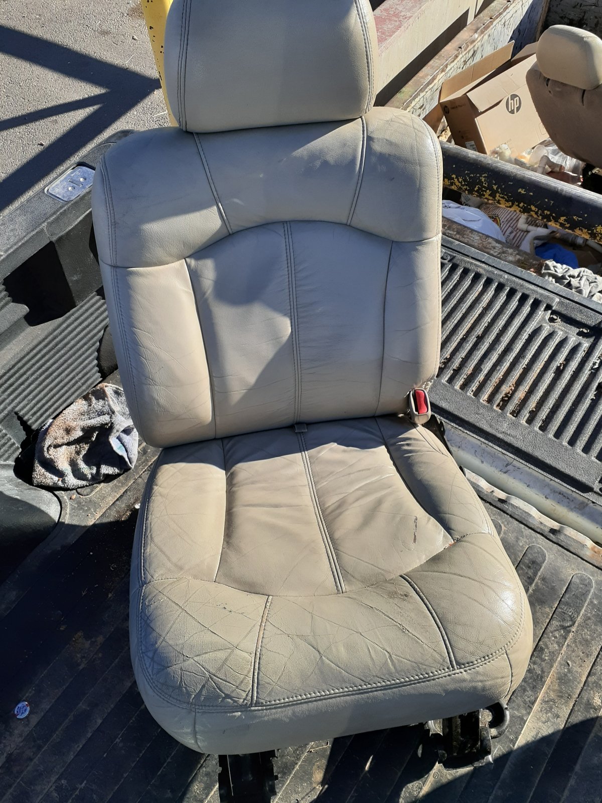

Also swapped out the 2nd row bench seats that had the middle lap over seat belt with a newer year suv that has the middle shoulder belt.
