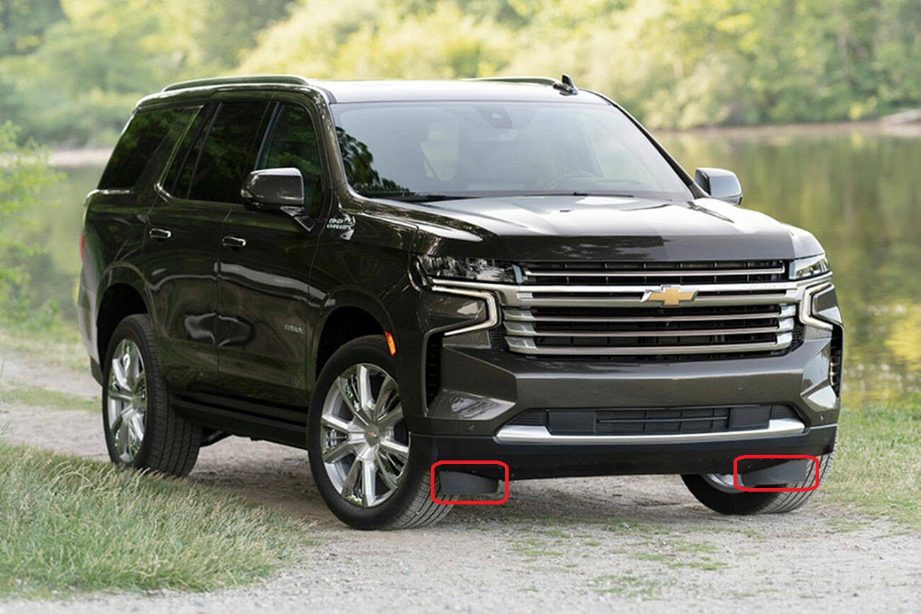

You were close enough, thanks. The explanation doesn’t make them look any better. If my 24 RST comes through with them I may have to deal with them the way n4gkj did. My current 2016 LT has the extended plastic skirt on the lower front but certainly nothing as crazy looking as these “spat” things.

I wouldn't mess with them at all. There not doing any harm. If you remove them it could affect your warranty as well as selling it later on. They're there for an obvious reason. Trust me when I say this they don't have tinted glass anymore so they can cut down on cost. Do you think they'd put them on if they weren't needed?

I don't think you offended anyone by trying to learn about a product. There are a number of members on here who gave you the correct answer: they are a product of the ever evolving CAFE game of mpg and credits the automakers have to deal with/play in order to sell lower mpg vehicles alongside smaller, higher mpg, vehicles.
They are designed to cut down on drag from air coming into contact with the tire. Direct air down and away, or up and over, to make a brick try to slip through the air. As mpg restrictions on vehicles less than 8600 gvw (read not commercial/heavy duty trucks), get tighter, these are ways to try and squeak out 1/10 mpg here and there........when you get a handful that work together, theoretically they will combine and improve the mpg rating. Which, when certified, helps the overall CAFE.
CAFE also includes many other mpg saving attempts incorporated into these trucks that have been the bane of some members existence.....AFM, DFM, Trans thermostats, 0w-20 oil, grill shutters, lower aerodynamic body lines, etc. All these add a certain amount of mpg gain in a controlled test environment - not so much in the real world with different driving habits, maintenance practices, etc.
While some have been quite good in justification, and the advancement of engineering and manufacturing processes, others have checked a box out of necessity, not necessarily to make a durable product.
To answer the question about voiding warranty. I don't belive it would make one bit of difference if you removed them however you see fit. It's a wind deflector, not an air scoop to direct cooling air to a certain component. (Some cars have scoops in the aero package to cool turbos, etc).
Long winded, but hopefully it all makes sense

Yes, totally makes sense, I appreciate you and everyone else taking the time to explain and educate me with this. If my new one comes through with them they won’t be there long. Thanks guys!

These things are needed to protect the hood of the car from waves when driving through puddles. On my previous Mercedes GLS car, they came off, I didn’t change them because it was very expensive. So after they came off any small puddle, much more water and dirt began to pour onto the hood.

Hey Ryan, my 24 RST is supposed to arrive at my dealership next week. My observation has been all the trims are coming through with spats with the exception of the Z71. What’s your opinion, can you live with them?

I say, unless you spend ALL of your driving time over 60MpH on the highways, take off the spats.
If you ever try to sell it, that's when you put them back on.

Totally agree. My only question is the configuration of them. Someone earlier stated they cut them off. If you have to cut them you won’t be putting them back on.
