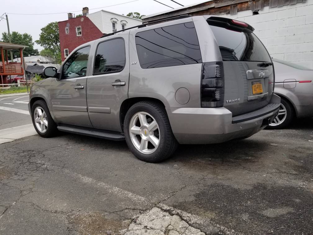

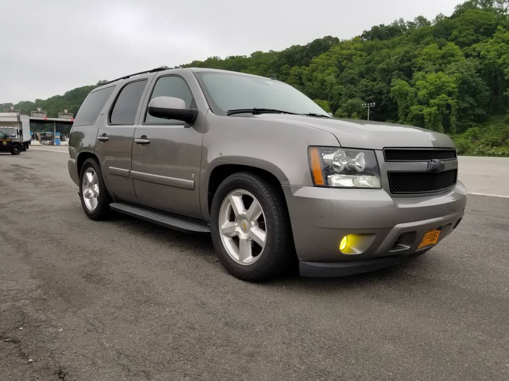

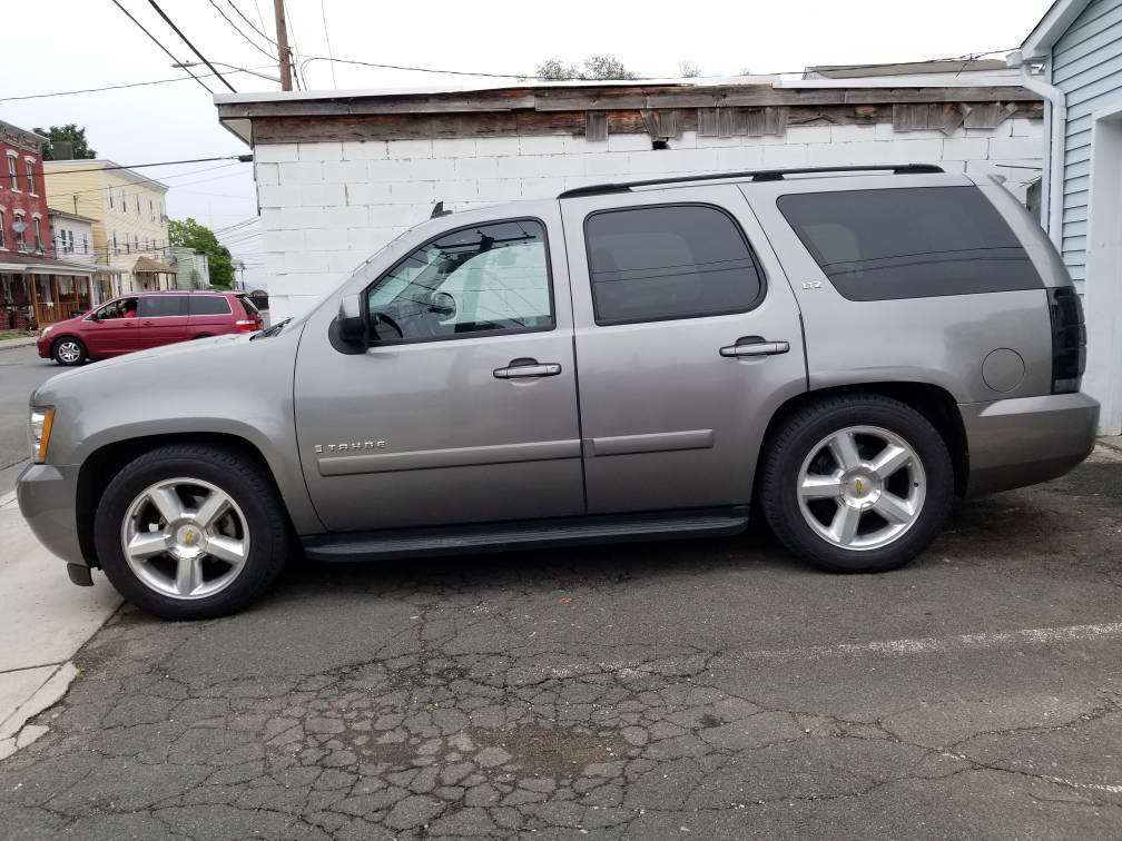

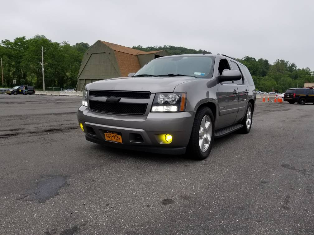

So here's my result. Not sure if my front shocks were bad, but my before measurements were about an inch or so lower than what most start off at. So not sure by looking at the pictures how much this drop is considered. Also want to go lower another inch in the front. Like the rake look more.
Also need to do the free travel mod badly. It rides great, but man when I hit dips on the road, it's a loud bang. Anyone know of a place in NYC that can get this done?
Results:
Before - After
FL: 35" - 33 1/2"
FR: 35 3/4" - 33 1/4"
RL: 37 1/4" - 33 1/4"
RR: 37 1/2" - 33 3/4"
Front:
- McGaughy drop shocks
- McGaughy Spindle
- Belltech Alignment Kit
Back:
- Belltech 5305 Springs at 4in.
- McGaughys drop shocks
- DJM Hardware kit
Still need to install:
- Helper bags
- Spohn Panhard bar
- Free travel mod
- Disable Autoride completely. Pulled fuse for now.

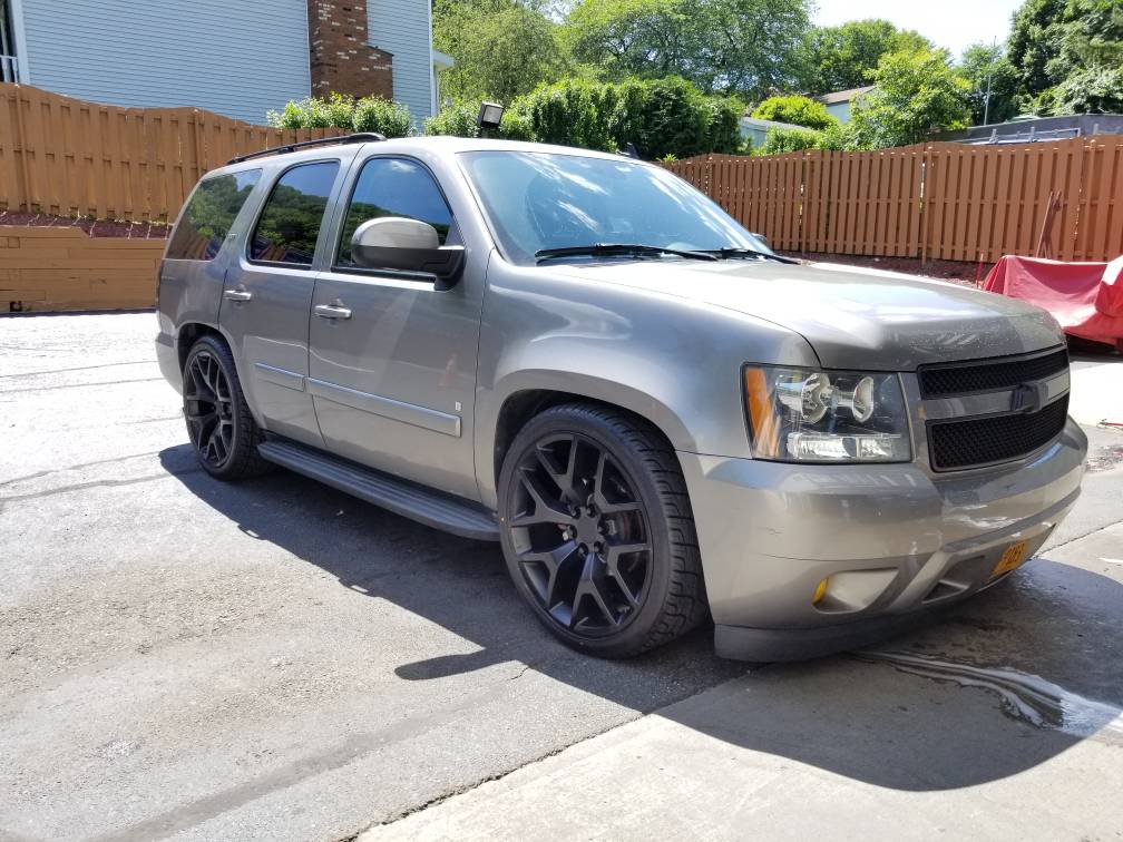

So I ended putting back the Autoride shocks in the rear because it was sitting a bit lower in the back and constantly hitting the bumpstops. Haven't done the travel mod, but it rides really good now and only sometimes hits.
Also installed my wheels. Rides really good and just rubs on full turn in the front.

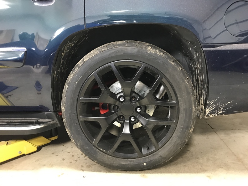

Looks great! What size wheels/tires?
67RS427
Apr 5, 2017
595
1,217
Thanks. Wheels are 24x10 and tires are 295/35/24.
I kinda wish I went bigger but wanted the extra sidewall for these crappy Michigan roads. Same wheel? From NorCalSS... Mine are 22 x 9 (285/45)

I kinda wish I went bigger but wanted the extra sidewall for these crappy Michigan road. Same wheel? From NorCalSS... Mine are 22 x 9 (285/45)
Yeah I believe NorCalSS (Tony) gets the same ones. I live in NYC and the roads are just as crappy. Luckily I'm good at avoiding the crater sized potholes lol. i felt 22" is the standard now and wanted something a bit bigger.
