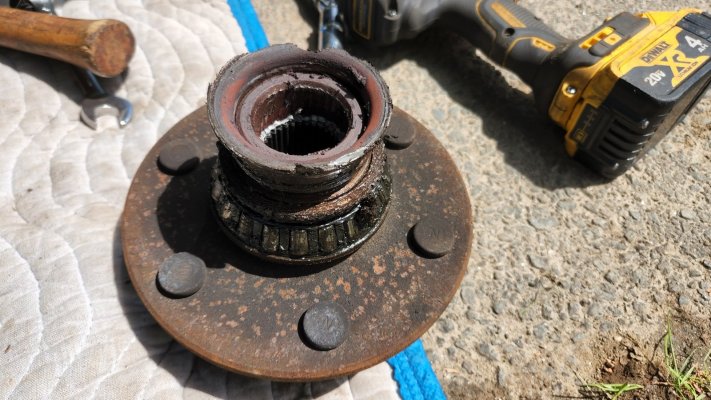

I was getting ABS light/chime and codes, then grinding noise. Followed by complete hub failure.
If you get any kind of ABS codes, it may be a warning sign for pending hub failure.
See what looks like a bearing with the nice ring of roller bearings in the photo? There is supposed to be another full ring bearing above it and both are supposed to stay inside the hub assembly.
Mine pulled apart by hand as soon as I got the axle nut off!
Here are the roller bearings that were originally inside the hub assembly... What was left of them after they got spit out the back side of the bearing seal...
You can live without a CV Axle... But you can't go anywhere without a safe hub assembly.
