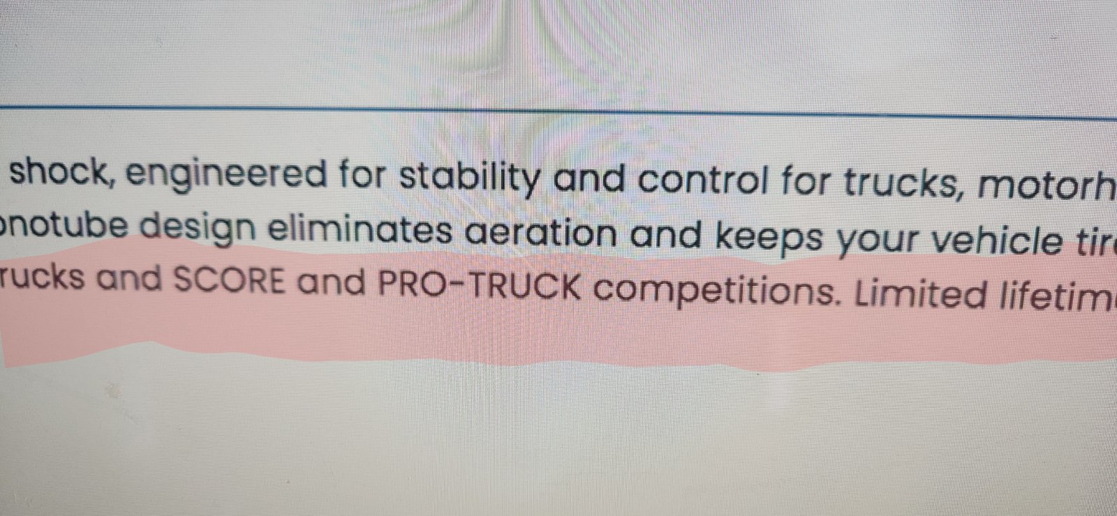

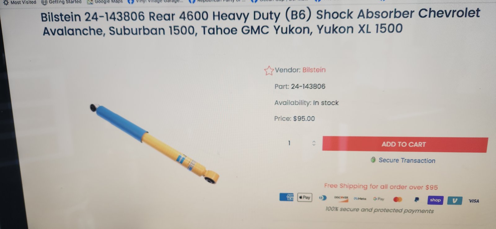

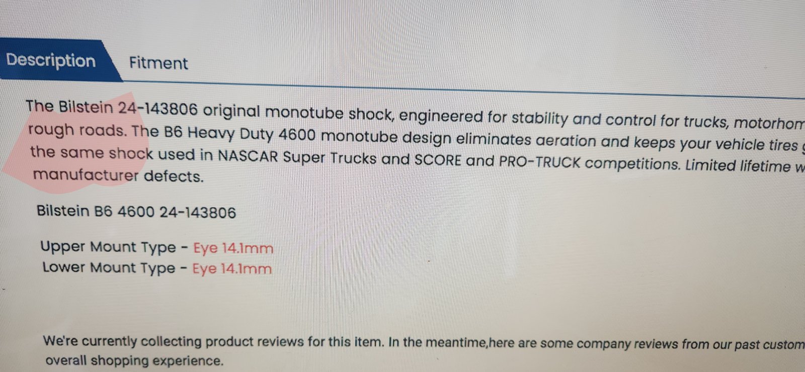

Shock Warehouse : It looks like their VERSION of the SUGGESTED / CORRECT rear shock?
In other words, they don't have anything in stock for a "premium smooth ride". ( Funny.... they have " no reviews " for this specific shock..... I wonder why......
Note the highlighted words"
" heavy duty - rough road" and " SCORE & NASCAR competition.....
I drive on SMOOTH roads..... Seems their shock will feel like concrete??
I want a 'firm' and smooth ride...... Anyone have any luck finding a set that keeps the truck comfortable??

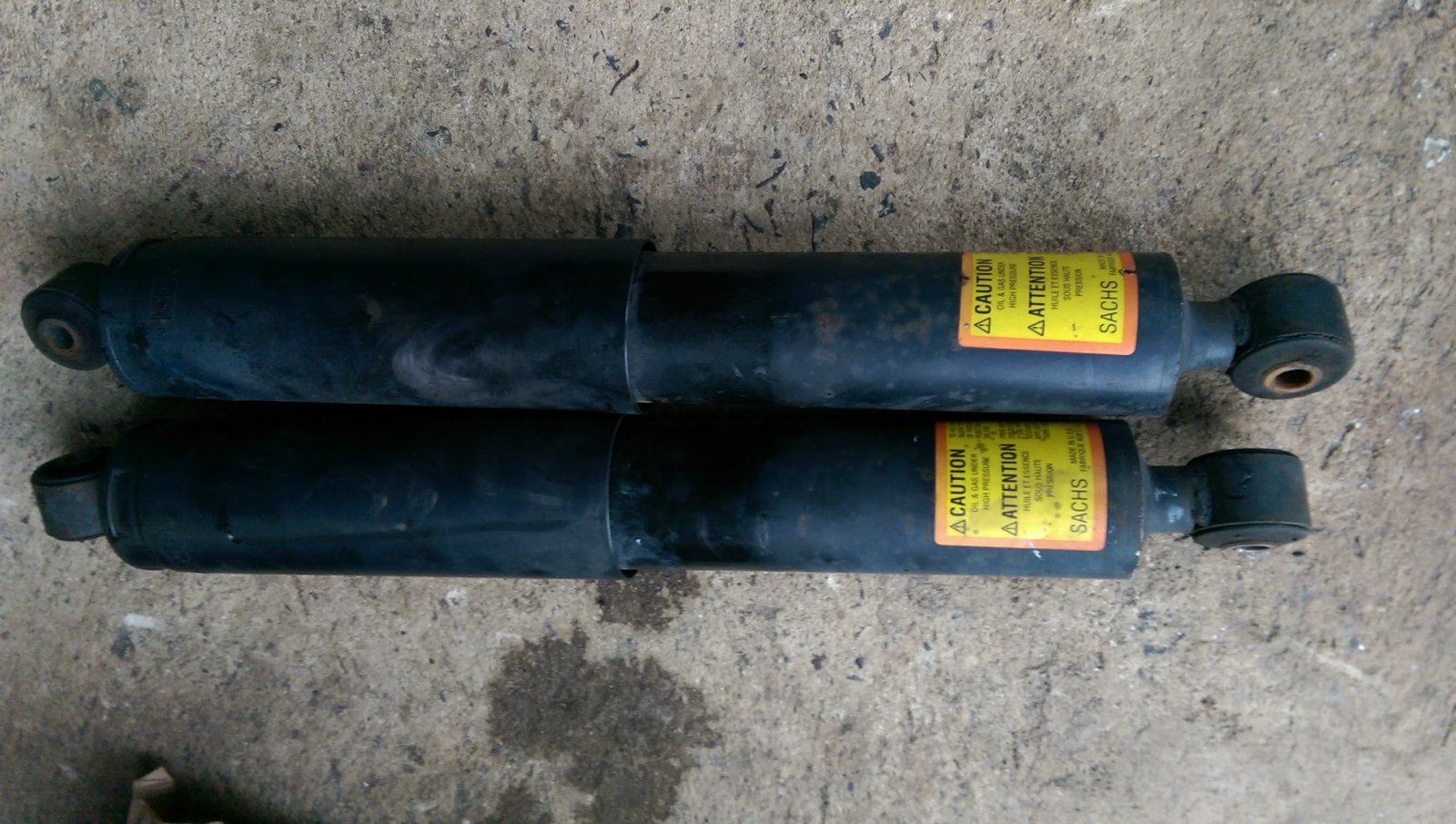

I probably do have those other codes. I haven’t looked at my codes in years. Mine definitely had the Nivomat shocks. I had a pic of them.
EDIT--Found the pic.IMAG1301001_1541794293795_417238532049062.jpgIMAG1300_417276151573631.jpg

Not really sure. They do make a nice ride tho. In the pic I put the kyb next to the Nivomat. Guy said they were a direct reply. Look at the size difference. Guy was an A**hole. Just trying to make a sale.
