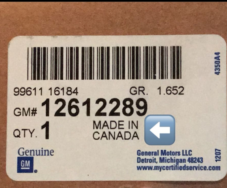

Let me confirm two things. First, which 5.3 do you have, the iron block LMG or the aluminum LC9?
Second, what is the brand and part number of the oil pump that was put in?
Im sorry im not that of an expert. How can i identify which block type i am having.
For the pump part #12612289

The 8th digit of your VIN will be a zero or a three. LMG or LC9. Most Tahoes will have the LMG. If that is the case, you have the wrong oil pump.
12612289 has been superseded by 12710304 which is the Melling M365 and these pumps were made for the aluminum block engines with their increased tolerances. They pump oil at a lower pressure and 1/3 more volume per revolution. The spring pressure is set to bypass at 36 psi or so once warmed up.
The current part number for an LMG or iron block motor is 12710303 which is the Melling M295.
Having said that, I can't say that this is the source of or your only problem, at least not now, just got back from an eleven hour run and am winding down before hitting the rack. There are guys on here who know more about this stuff than me as well. The only other thing I can think of is to make sure that Ford oil is Dexos 1 Gen2 certified.
