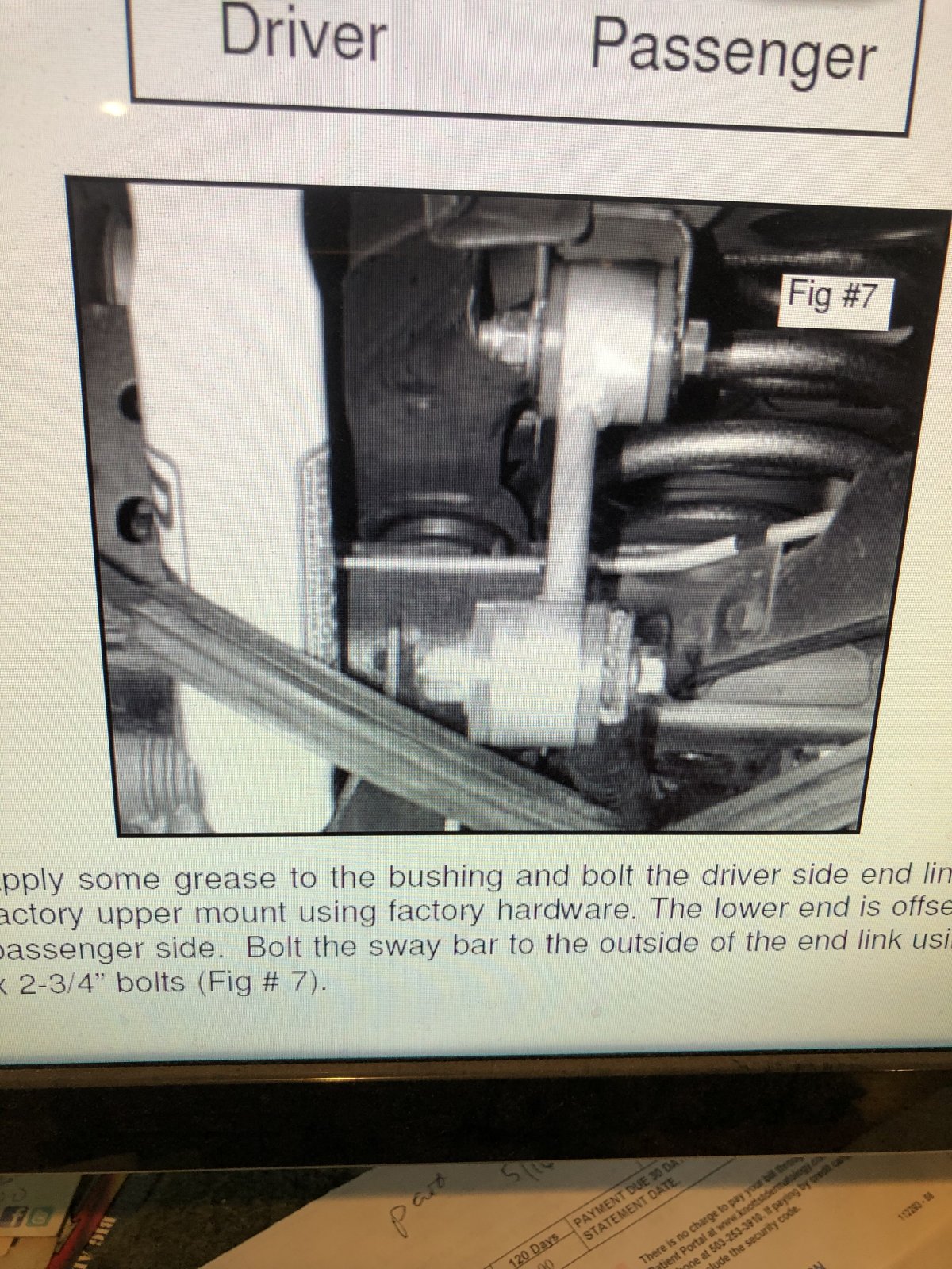

Right as in the picture? Or right as in passenger side?
Both since the picture is taken from the rear. The driver side sway bar is installed on the wrong side of the end link- it’s supposed to be on the outside (left) of it. I can’t tell if the driver side end link is installed correct from the angle of the picture. It’s supposed to offset to the right but only slightly as opposed to how much the passenger side offsets to the right. The sway bar then mounts to the outside of both end links.

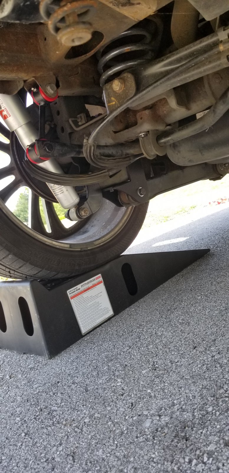

To clear up all the confusion--can you post a pic of yours installed?

Your driver side is wrong. Look at yours, and look at their picture and read the instructions. The sway bar mounts to the outside of the end link.
52,954

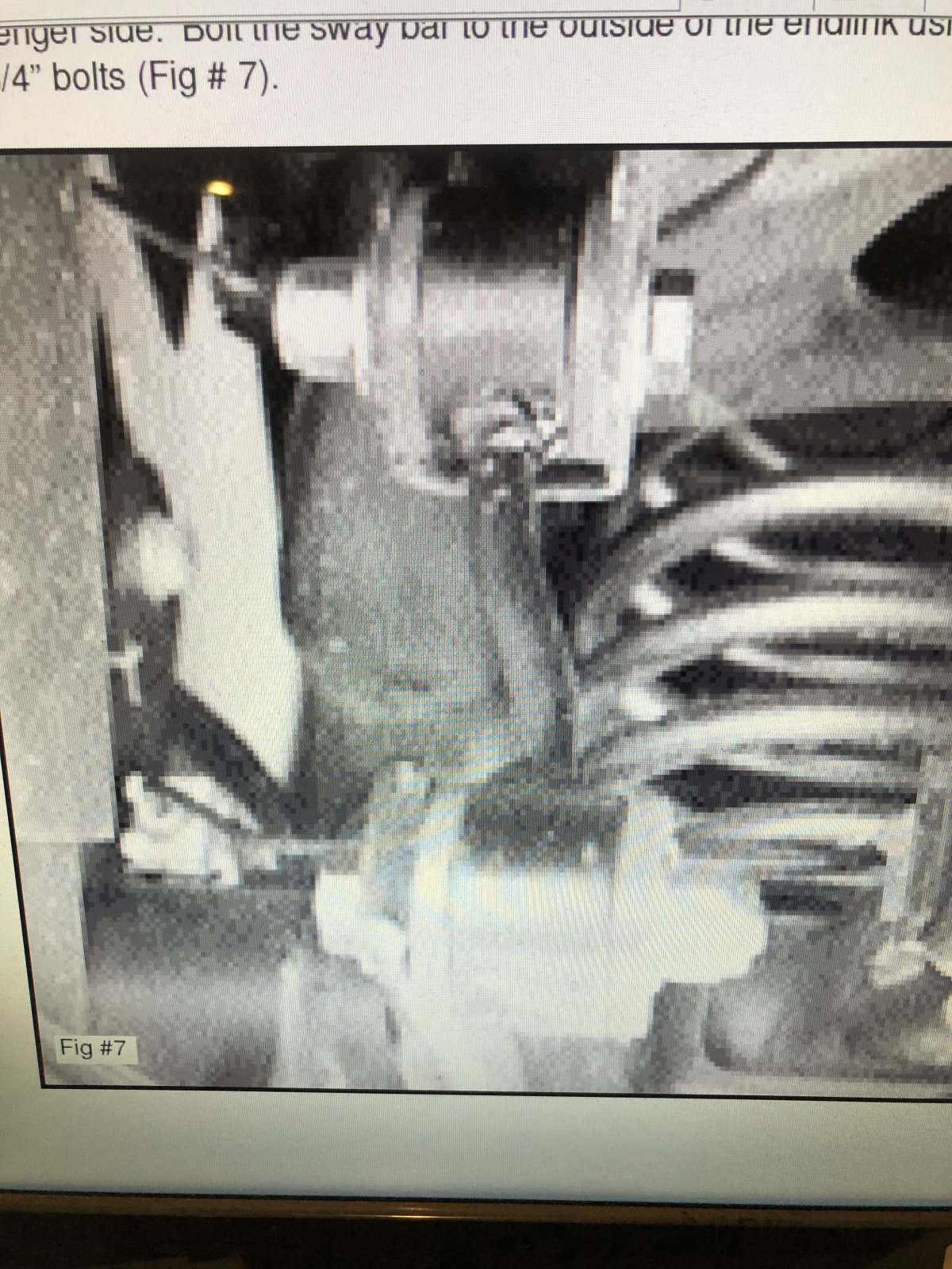

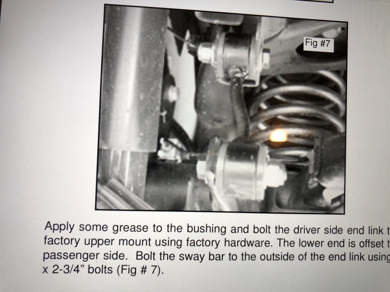

Well after further research, I now conclude I’m as confused as f@ck. If you look at the instructions for the 07-14 the words are the same, they say to mount the driver side to the outside and the picture, blurry as it is, shows it on the outside.
52,954
But on the 00-06 instructions it also says to install the driver side to the outside but the picture clearly shows it on the inside. Also the left end link actually offsets to the left while on the 07-14’s it offsets to the right. I just checked and mine is installed on the inside of the left end link and iirc that’s the only way it works, just like @Byoung1330 said. Frickin DJM. The instructions are wrong and confusing.

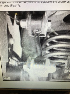

That’s in the instructions for the 07-14, and both end links offset to the right and the instructions are correct. They say to mount the driver side to the outside of the end link which makes sense since the end link offsets to the right. But if you look at the instructions for the 00-06 you can see the end link is a straight bar but look at the bushings- the lower is actually offset to the LEFT so if you try to install the sway bar to the outside it won’t go. But the instructions clearly say to mount it to the outside, just like the instructions for the 07-14. BUT the picture for the 00-06 show the sway bar on the INSIDE of the end link. Instructions say one thing, picture says another, and it only works one way.
52,954
Look at the 2sets of instructions and you’ll see what I mean.
00-06 http://djmsuspension.com/wp-content/uploads/2015/05/RK2000.pdf
07-14 http://djmsuspension.com/wp-content/uploads/2017/10/RK2007v2.pdf
edit: notice the wording is exactly the same, including the part about the left endlink is only slightly offset and the driver side has a greater offset, but doesn’t say the 00-06 offsets to the left. Both sets of instructions state to bolt the driver side sway bar to the outside of the endlink but the picture on the 00-06 says different. Also it doesn’t matter if you turn the 00-06 left endlink upside down, it offsets the same way.
52,954
I think djm has it wrong in the picture but has it correct in the written portion
No it’s wrong in the written portion. It says to bolt the swaybar to the outside of the driver side endlink. Look at figure #7, the picture is right but that's not what the instructions say. Here's what it says about the driver side:
"Apply some grease to the bushing and bolt the driver side end link to the
factory upper mount using factory hardware. The lower end is offset to the
passenger side. Bolt the sway bar to the outside of the end link using 1/2”
x 2-3/4” bolts (Fig # 7)."
Notice it also states the lower end of the driver endlink is offset to the passenger side but it is actually offset to the driver side. Look at figure #6 in the 00-06 instructions. The driver side endlink offsets to the driver side, not the passenger side.
