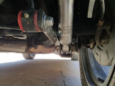

Went about it a little differently. Used a straight moog link and shortened it down to keep everything parallel. Lots of clearance at shock but did have to trim panhard bracket down some for clearance for sway bar movement. Have about a finger width of space between sway bar and bracket. Doesn't seem like much but being a fulcrum it only moves a bit.
