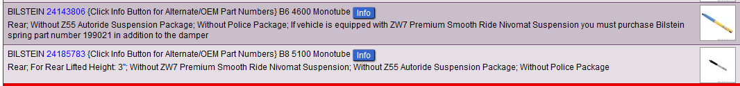

Likely the ones you removed were the Nivomat self-adjusting shocks. Bilstein specifies changing the springs when converting to conventional shocks:
Owners (and members here) have experienced stability issues (read: squirrely handling) when the springs aren't changed.
I’m gonna end up just buying the nivomats and selling my 5100s. They’re still brand new. Less than 500 miles on them. I’m glad I joined this forum. I should’ve a long time ago. When I had my P71s I was on crownvic.net learning everything.
