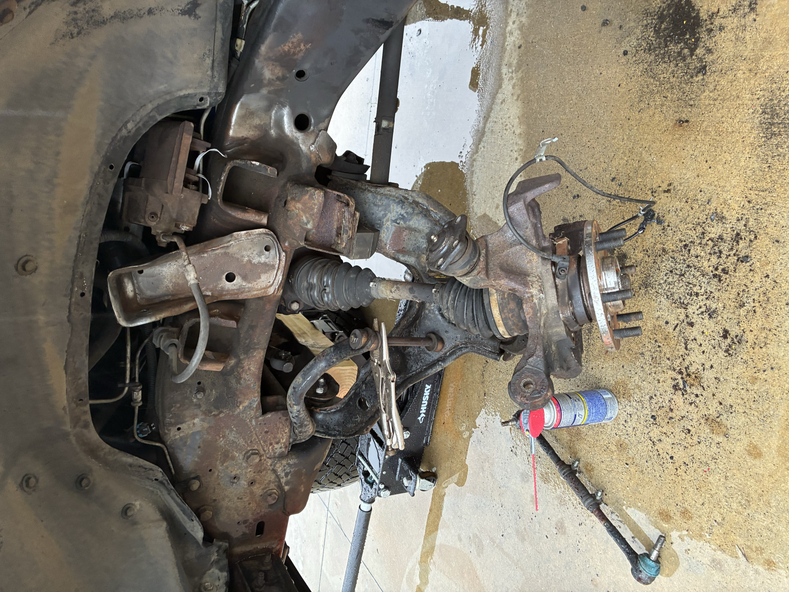

So I've owned my rig for 20 years and the suspension is tired. Ordered new OEM Billstien shocks, 15 piece front end kit, as well as new sway bar bushings, and CV axle shafts. Also picked up some Eastwood Rust Encapsulator just to clean things up a bit. It was a California rig so it doesn't have any serious rust, just surface rust.
Question, I got everything apart except lower control arm. Can I remove it without messing with the torsion bar that runs through it, or do I need to loosen the torsion bar keys so its not under tension?
I'm no mechanic, and I didn't stay at a Holiday Inn Express last night, lol.?
Any advice is welcomed.
Progress thus far.

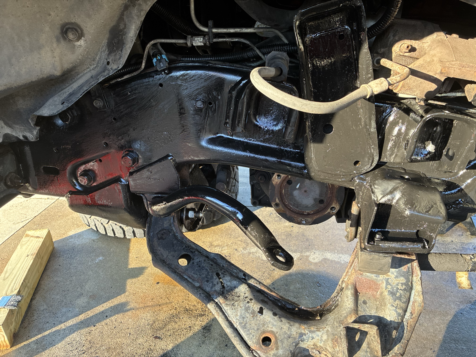

Appreciate it. I was under it today and I removed the key retainer, but for the life of me I couldn't get the actual keys out or the torsion bar to budge. Hit it with penetrating oil, letting it sit until next weekend.
I did let the Eastwood Rust Encapsulator tack up, and top dressed the frame rails with an oil based paint. Bushed it on this time, instead of the spray application like I did in 2008. Like I said, no serious rust, just surface rust. I'm truly blessed in that regard.

Last time I removed the lower control arms on my '97 GT, I did Not remove the torsion bar. Mainly because it was seized in there big time. I loosened the lower control arm mounting bolts, pulled down on the control arm, and that relieved torsion bar tension. I placed a jack loosely under the control arm. Took the mounting bolts out, and used a heavy hammer to tap the control arm forward clearing the torsion bar. The jack just prevents the heavy arm from dropping. Alot of penetrating oil and heat helps big time for jobs like this. How did you get the "2 Door Owners Club" under your user name? Very cool!

On your lower control arms. Yes the torsion bar has to come out. To do that they need to be free at the rear and at the front. I have come across both stuck at different times. One Suburban out of Michigan was stuck so bad I soaked it for days in penetrating oil. Finally got out a 5' long steel bar about 1" diameter. Used it and a 5 pound sledge hammer to pound the torsion bar out of the control arm. Both sides took quite a beating to remove due the rust build up. Once out I cleaned them with a large wire brush on my grinder. They went back in like brand new.
I always put a paint mark on the torsion bar adjuster bolts so I can return them to the exact setting they came out at. Saves time on install. I think that stubborn Suburban was in the garage 3 days longer than it should have been as I figured out how to break the torsion bar loose. Today I have an electric impact hammer that might have knocked them right out but back then it was the 5' steel bar and a 5 lb sledge.
For install and removal I use a hydraulic bottle jack and an adapter I made to fit in the dimple on the torsion bar adjuster. Make sure you are 100% straight up and down as you pump the jack to move the adjuster into place. Not perfect but has worked at least a dozen times for me. I also use a little anti seize on the ends where they slide into the control arm and adjuster so I never fight them again hopefully.

Was beating on the torsion bars today, can't get them to budge in the slightest. Not sure if this would work, as I feel maybe its not moving because its bottomed out on either side. So maybe if I unbolt the lower control arm and move it slightly, could that give an inch or two of wiggle room for the rear portion of the torsion bar to get out of the key?
Only accomplishment today was getting the frame rail completed painted. Figured I'll allow it to cure over night before I begin messing with everything again. I will say that new formula of the Eastwood Rust Encapsulator (plus) stretches really fair. That pint sized jar being brushed on- went really far. Still have half a pint left over. I don't remember the original Eastwood Rust Encapsulator doing that. I was pretty impressed. :thumbsup:
