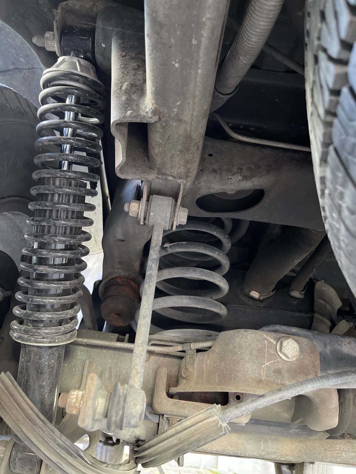

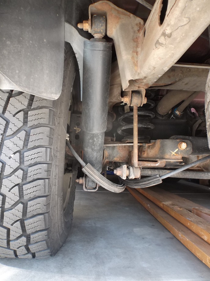

Shoot a pic of your RPO codes on the back of the glovebox lid and post it up here, but not at an angle like your first post. From that we can see what suspension came with your rig. You might have ZW7 (Premium Smooth Ride) and that has special rear shocks that adjust for loads. But we need to see those codes....
And let us see a picture of one of your rear shocks.

So load leveling shocks. Can you take a pic that's more in line from front to back? What do the truck coil springs look like? See this driver's side pic for what the Nivomat shocks look like (you don't have those), and where the coil springs are on top of the axle.

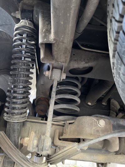

Here's what the RPO sticker looks like:

Look like you had OEM nivomats ZW7 and G65 and they were replaced with whatever that coilover looking shock is to compensate for being a traditional dampener.
I would swap out your normal coil springs with one from a model without Nivomat, Autoride, etc or simply replace the Nivomats although that’s probably a more costly proposition
My observation as well. We can't tell if the springs were changed from the softer ZW7/G65 spring setup to a standard spring. I'd probably just add airbags in the coils and air them up as needed.

I was never a fan of those spring over shocks after I tried them on one of my Squarebody Suburbans. Prefer air shocks or air bags.
