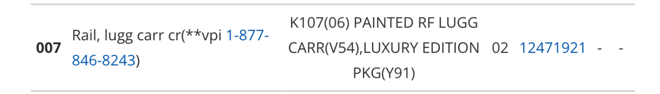

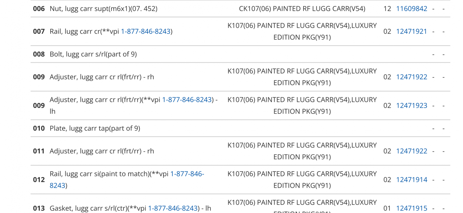

The cross pieces for a two or four door Tahoe/Yukon/Suburban are the same part number (12387475).
But the ones with the Y91 RPO (which I suppose is an Escalade or Denali so check the glovebox for that code) are different. That part number is 12471921. I can’t imagine that they sold a ton of them, so a dealer may still have one somewhere. They can usually check nationwide inventory, so it may be worth checking around.

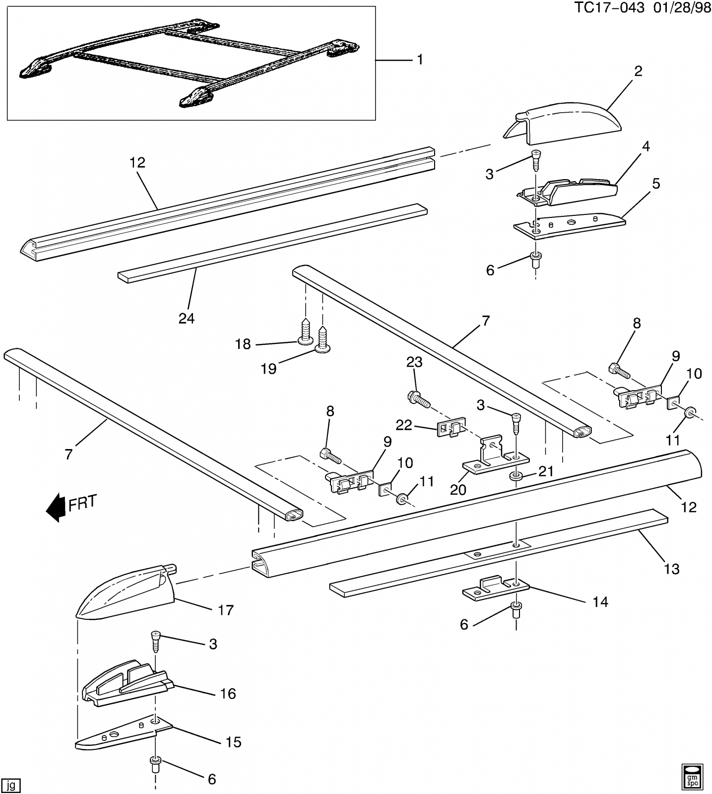

I forgot to post the numbers for the adjuster bracket, here’s that and a photo of a 98 Tahoe in case it helps.

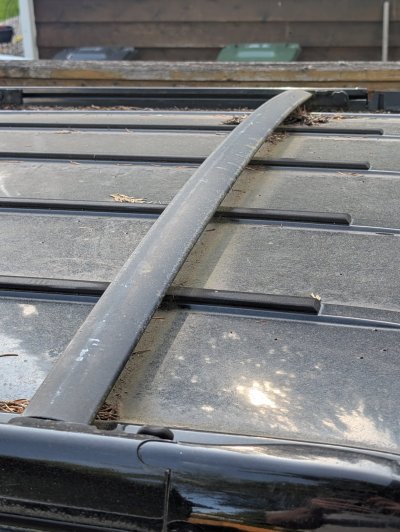

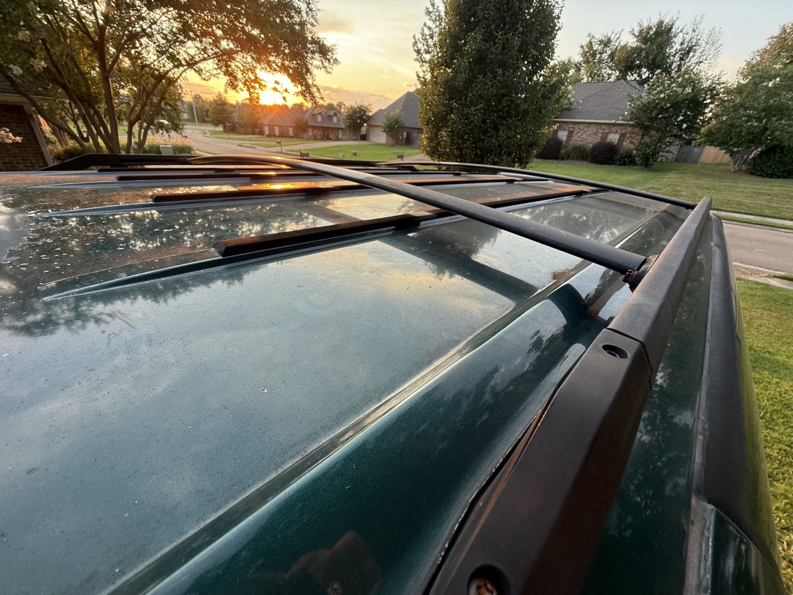

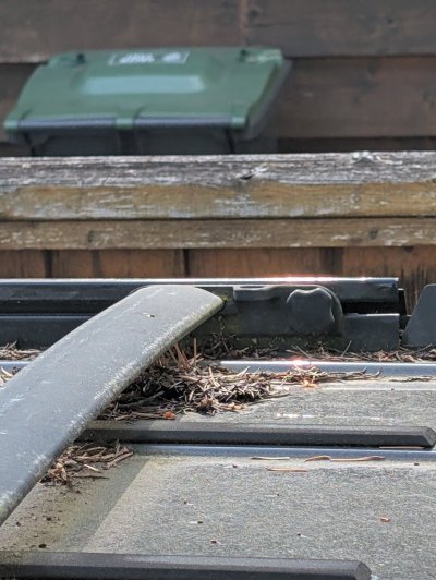

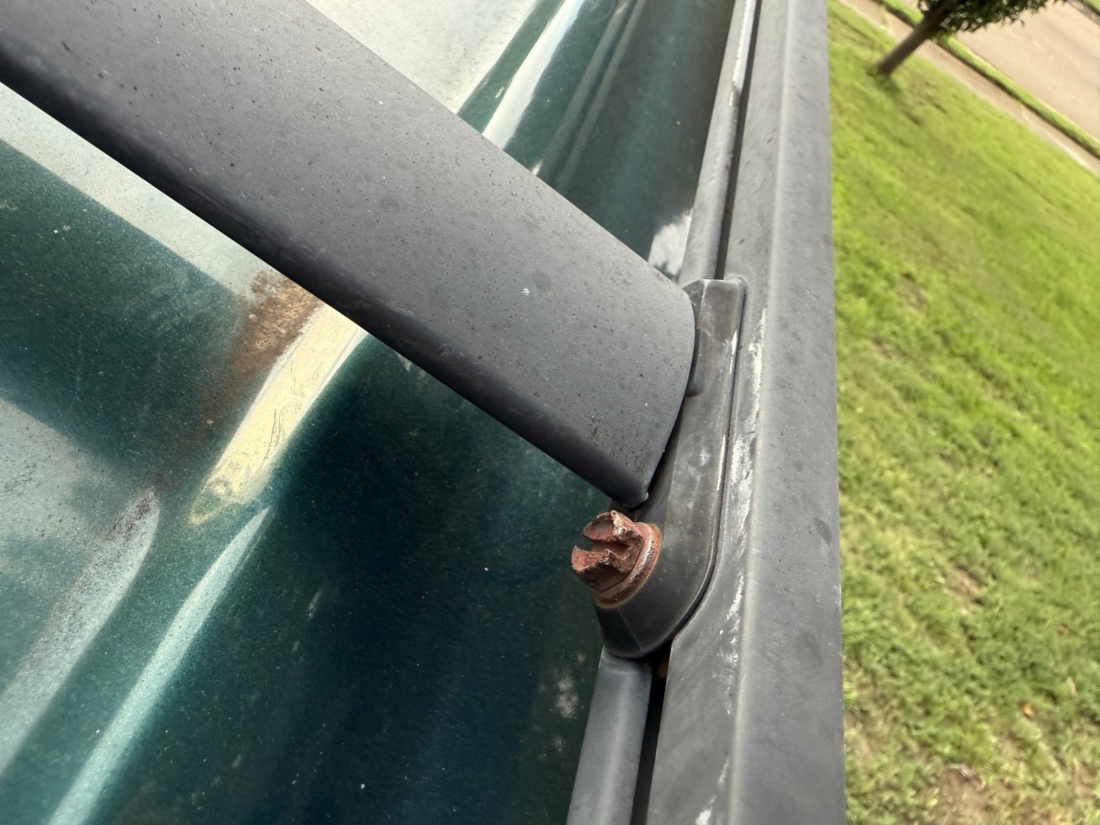

My cross bars look different! I wanted to get 2 extra that are the same so I can mount a roof basket. Maybe those would work but I want them to be the same height as mine. I may have to remove mine and try and match up with some good used cross bars.

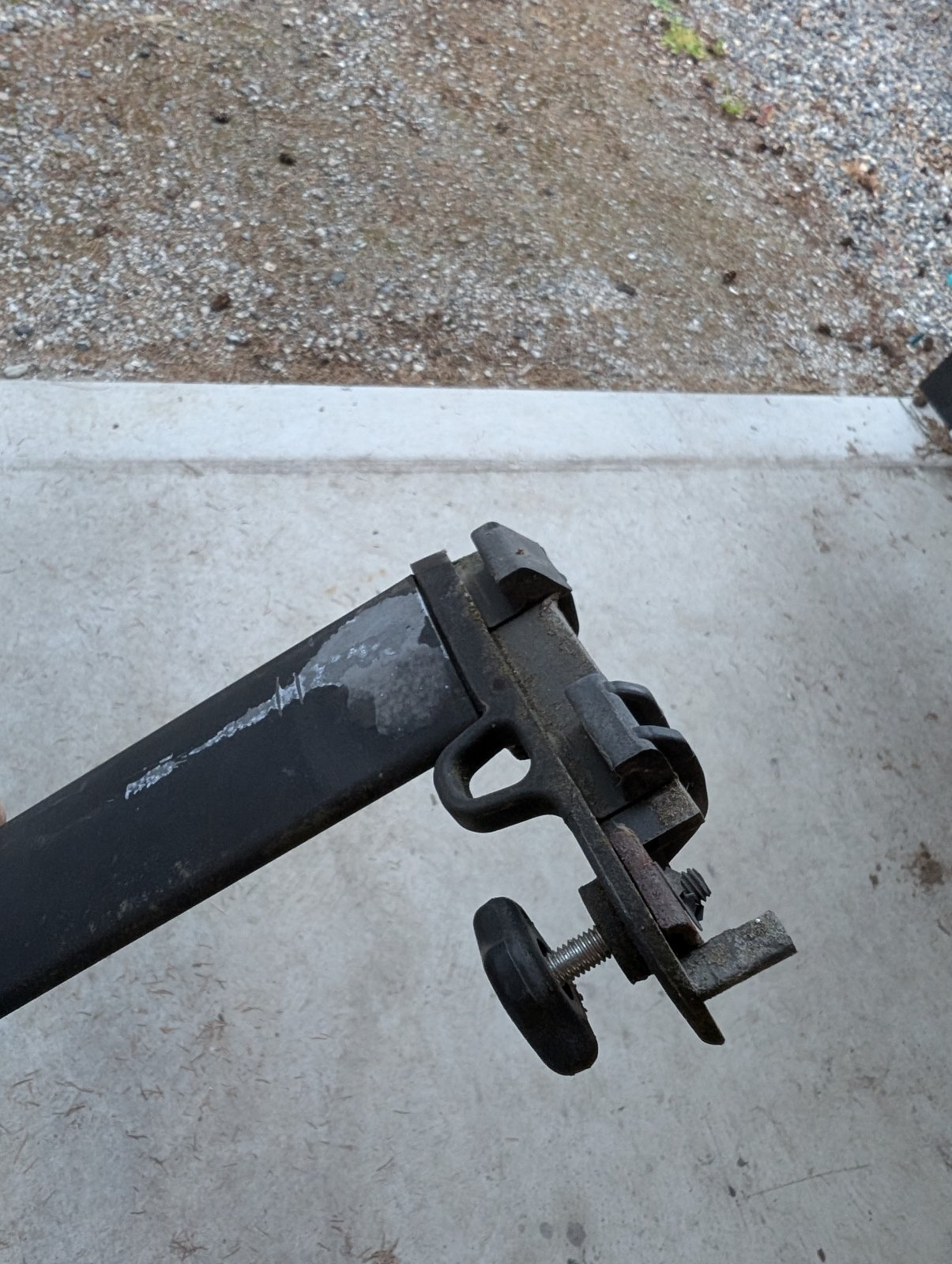

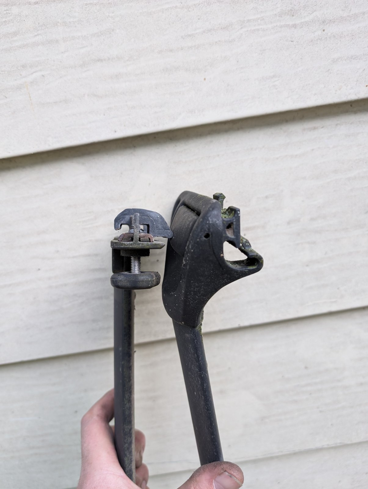

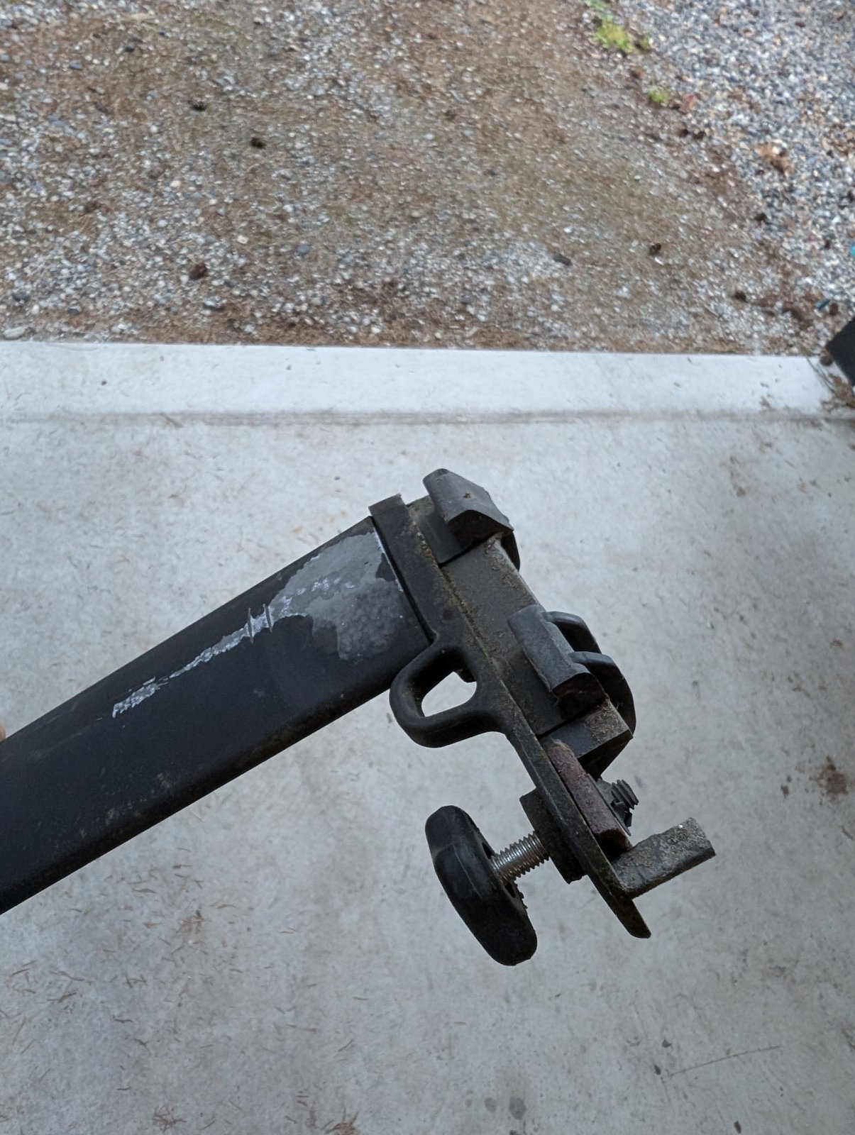

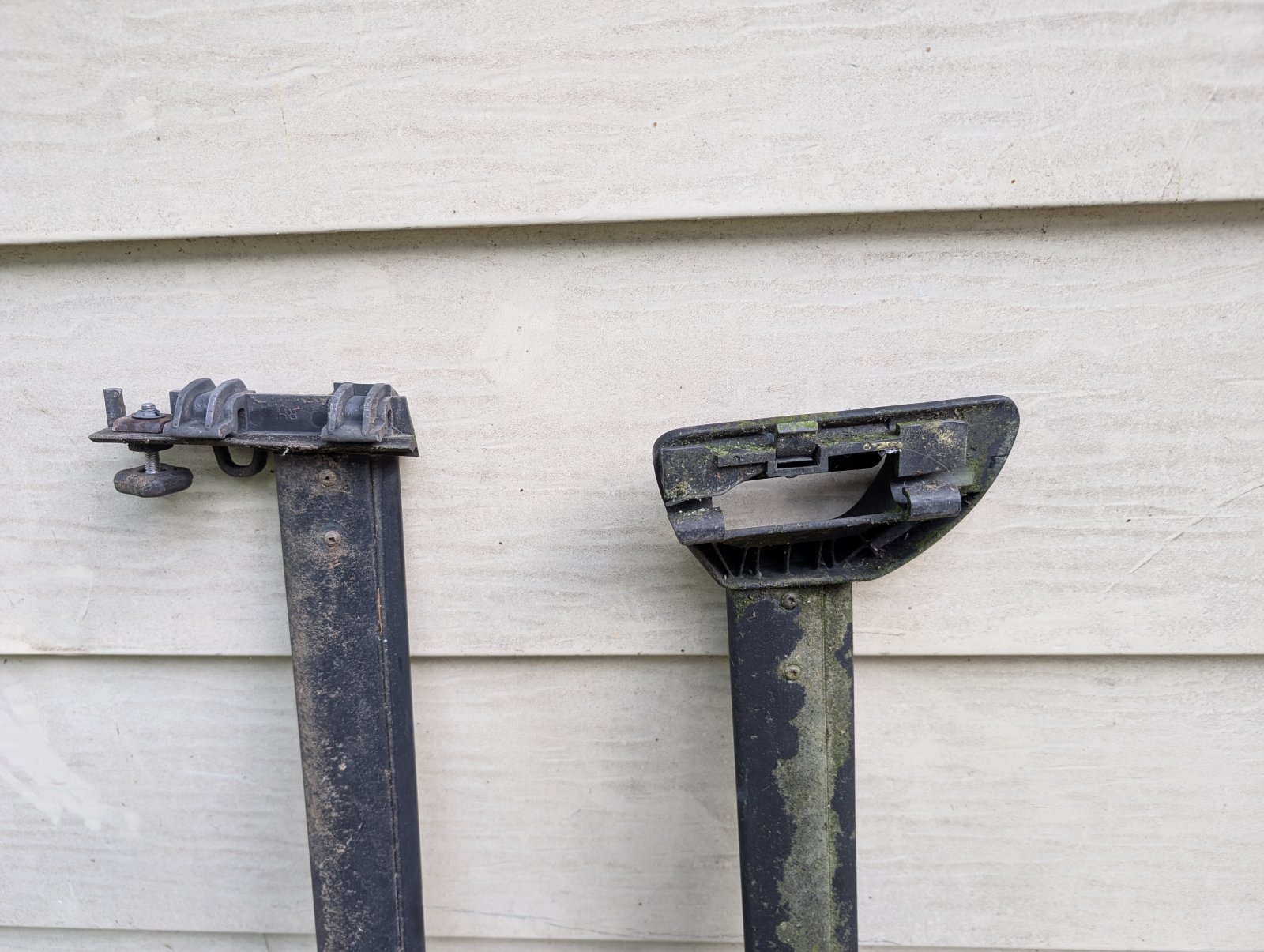

Looks like the cross bars from the 99 Yukon don't fit! Very similar but don't fit. The Escalade ones are on the left side! I'll have to keep looking!

Are you sure those aren’t from a 2000-06? It’s been a few years since I had one, but I remember them being adjustable with a pull-up latch. Mine (98) have the bolt that you loosen, similar to what you have.
@OR VietVet may recognize them, he has one of that style.
Edit: photos below are from an eBay listing for comparison…

Looks like the guy had the wrong description on his market place add! I never saw the truck! He had them pulled off already! Also I should have pulled mine off to compare! My bad!
