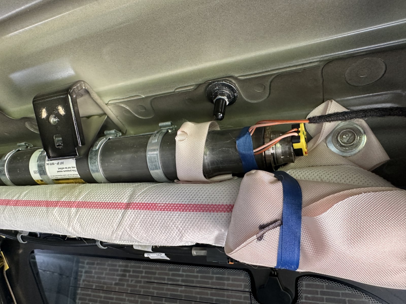

Each rail is held by four bolts like this one. They require dropping the headliner to access.

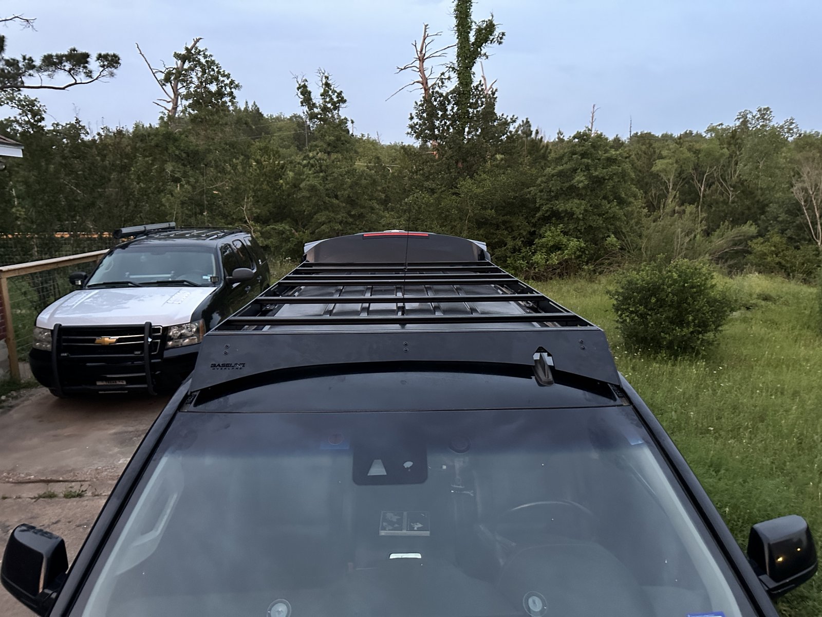

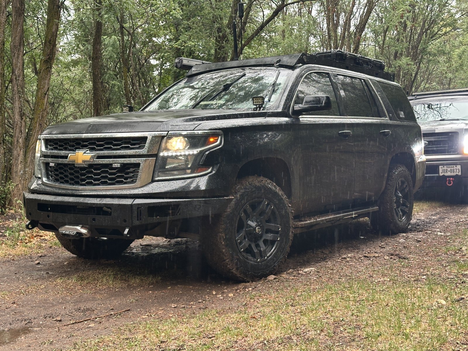

I went with a rack from Baseline Overland. It’s been installed for 2 years now.

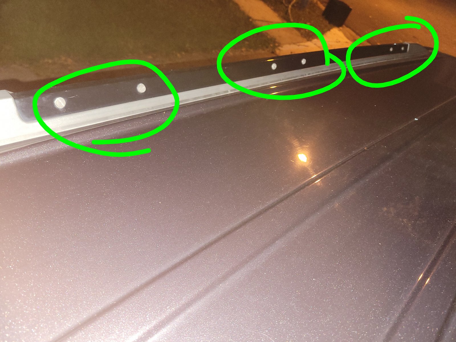

I just looked at the side rails on my roof. They appear to be a bit curved, so I don't think the three cross rails would all be level.
