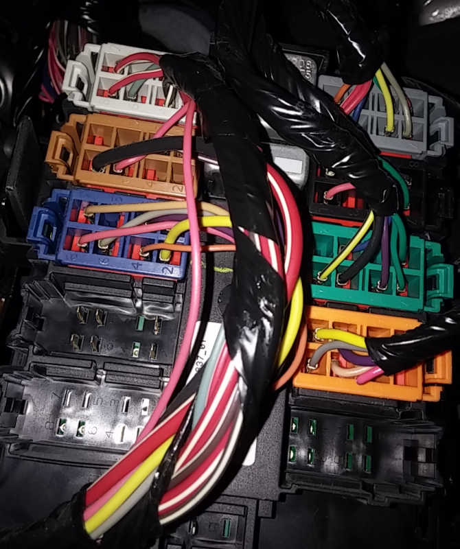

So. On my third Tahoe, an '07 LT, and it has the ebony interior, which I affectionately call the black hole, because it's so dark and absorbs all light. So I got some super bright LED's for the domes, but want to add footwell lights as well and underseat lights under the front seats to serve as floor finders for the second row. 404 Error. Page not found. Nowhere can I find any information on an 07 that is correct, including posts made here. All searches result in all manner of year models, and trucks, and foreign cars.
Here is a photo of what I have in the way of connectors under the dash.
a
Already tried the A-Pillar, and the two grays are actually probably tan-ish, and don't work. Two of the under dash connectors kill the domes when unplugged. I've gone through every pin on those two connectors, and there are no pins that are connected to the dome lights, they all either are 1) independent hots that stay hot all the time, or 2) dead, or 3) very low voltage and barely light up the test light, and still stay hot all the time. I'm looking for the elusive feeder that feeds the current to the dome lights, that eventually dims then goes out. I'm trying to avoid going in through the headliner and hacking into the circuit there, and trying to snake the wire down the C or D pillars.
