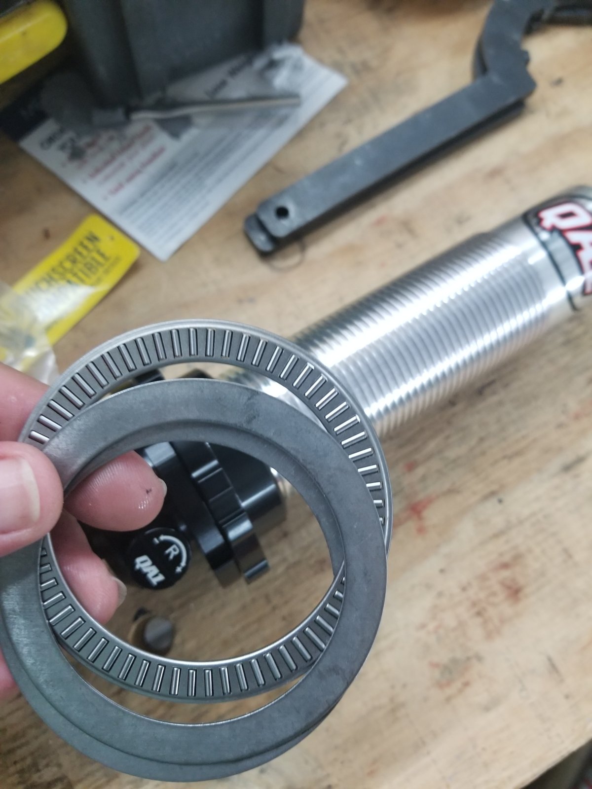

I asked him how much preload am i supposed to set them up with, if he says crank it on down, i'll give it a try...the 900lb are only like 60 bux each i'm going to grab them and go for it
need to set a couple of bolts in the work bench for setting the preload up....kinda pain in the ass tightening the thin jam nut up on truck 1/8th of a turn at a time

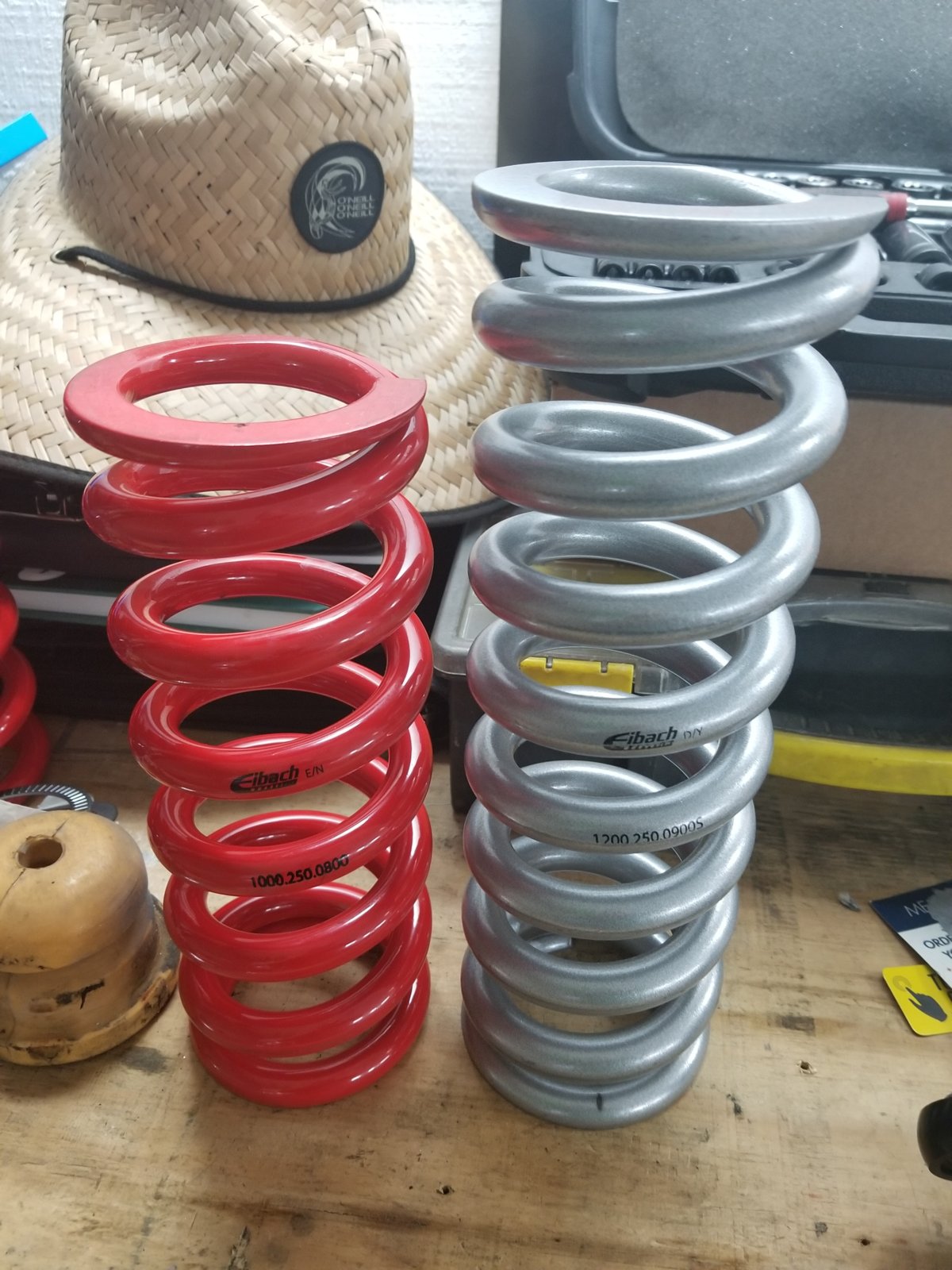

I did pull the stock shock back out today, put in the mounts and measured eye to eye where I want center of hub to be (1 inch down from where I was, or 17" to fender) and got 13-3/4. The shock I have is recommended for 12-1/2 to 13-1/4...but I think it will be fine, will just have a little more compression.

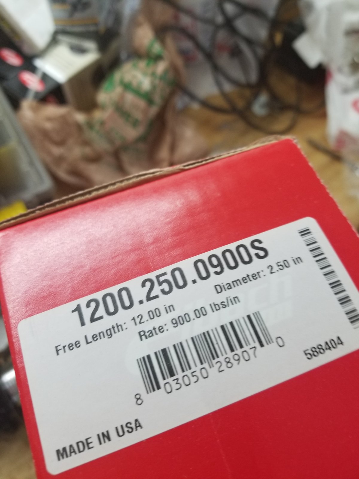

I ordered the 900lb springs, and they came in ,no more red :(
Overall length of the shocks is 15" minus 13-3/4=1-1/4 of compression at ride height ~or about 1100lbs. I've weight my truck with me in it @5900lbs. For the purpose of just making sure it doesn't hit the ground again I'm assuming 3000lbs over the front axle. Minus the 1100, I need to preload about 1000lbs (or an inch) on each coilover
I will probably go over to about 1-1/2 of preload as it's easier to unload it then it is to tighten the jam nut on truck.

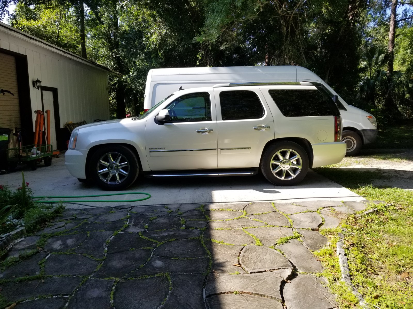

they in...and its lower :lol:
going to ride around a few days and see how much more it settles, Im still back and forth about how low i want it to be, I went ahead and pulled the spacer out from under the rear spring too, not that i mind it being low but function>form lately - as long as it handles better i dont really care what height it is.
At this point i can either swap the spindles back out and use these coilovers which would be "free" and put me about back to where I was with just the spindles but with a better shock/spring - would just take a couple hours, Id need to go get it aligned again asap, etc
get longer shock/spring - easy to swap but more $$

well its not necessarily the springs... the shocks have a height they like to sit at. i could preload the springs a whole bunch and it would sit where i want but the weight of the truck wouldnt compress them at all and there'd be no travel "up" travel.
it's probably sitting about 4/4 drop now. 32" tire (275 55 20) is about an inch from the fender height in the front, 2.5" in the back (it may settle a little more)
driver side was sitting a little lower (me+gas on that side) just cranked another 3/8" on the spring for that side to hopefully pick it up and even it out.

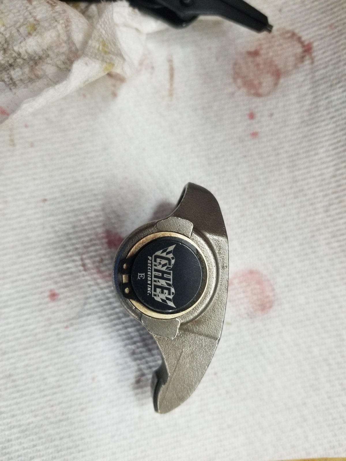

And I pulled the valve covers and rocker arms to upgrade the trunions. Not many pics was messy, covered in assembly lube most the time. The CHE trunion upgrade is very nice everything went back together great

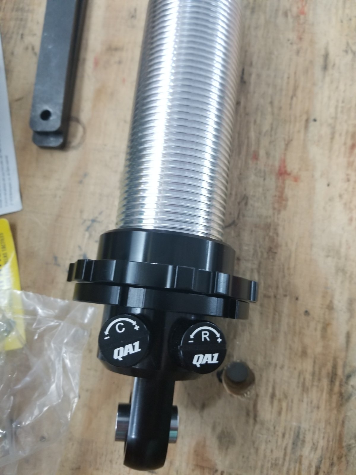

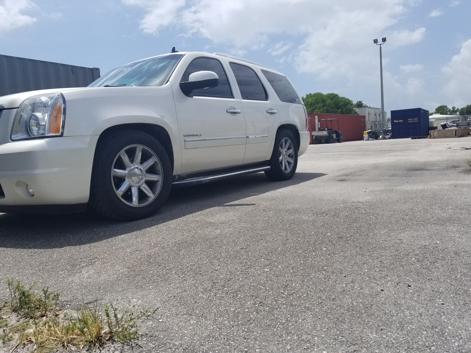

Adjustable shocks.... anything above 13-14 clicks on the rear and its bouncy as hell, where it's set now as rough as i like driving it daily. way more responsive than stock spring/shock
I'm at 8 clicks front and rear right now, might go 1-2 more up front it still feels kind of "lazy" to me . Back I need to do free of and prob go back down to 7...haven't bottomed out with 8 but it's not as comfy
hasnt been aligned yet, debating on whether i want to leave it this low or not, i'm diggin it tho, miss my lowered truck!
i think thats part of why it looked so low to me with the tires even with the fender becuase of the camber pulled way in

trunions werent bad, took prob 3 hrs start to finish hustlin through it. thought there was going to be more to pulling the valve covers but only had to pull the coils/brackets. one of the gaskets stretched out, luckily i didnt replace them when i tore engine down so i had an extra set handy :cool:. I also wanted to take a look at the rocker to valve patterns as i kinda just went with what everyone said and its been sitting in the back of my mind that maybe i should have checked pushrod length but it was all good. LS rockers just get torqued down to 22ft lbs makes life a lot easier.
the CHE are machined to slide into the rocker bodies no pressing anything back in. i have a cheap harbor freight hand crank press (?) not sure what the real name is, but it made quick work of removing the stock needle bearings. then its just new trunion, put on a bushing, retaining clip, slide it in rocker body, bushing on other side, retaining clip on the other side

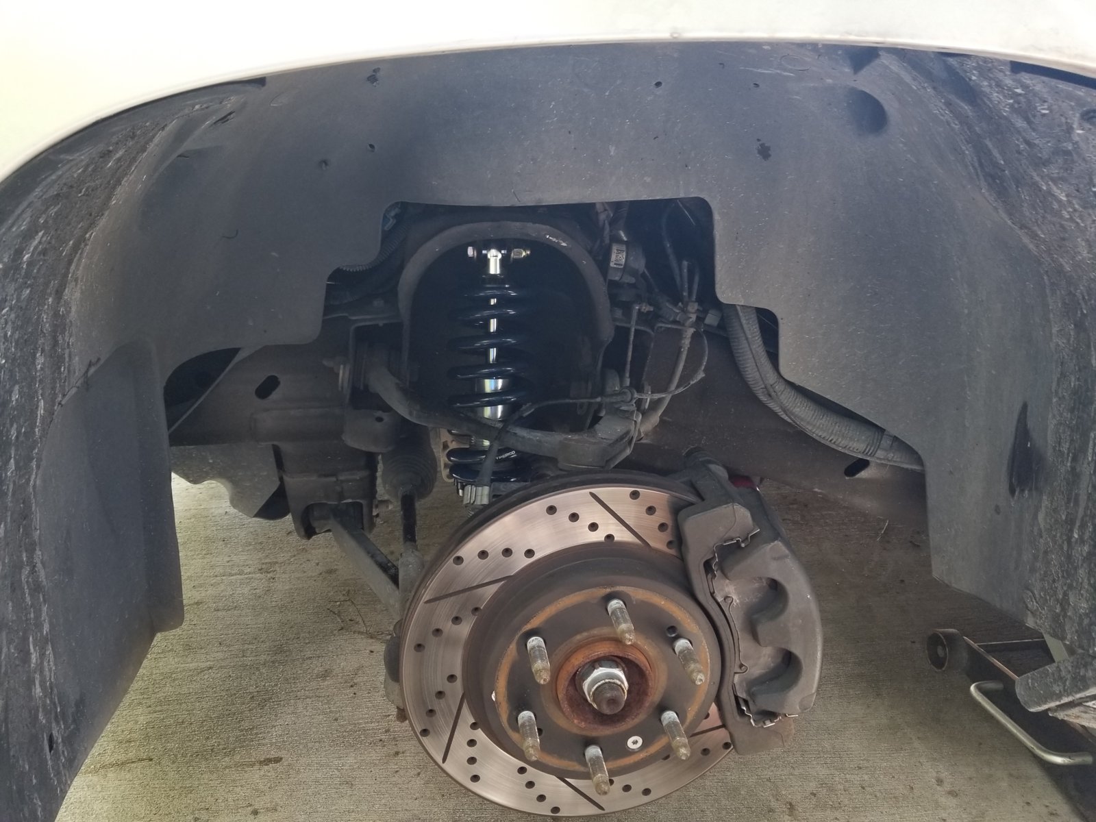

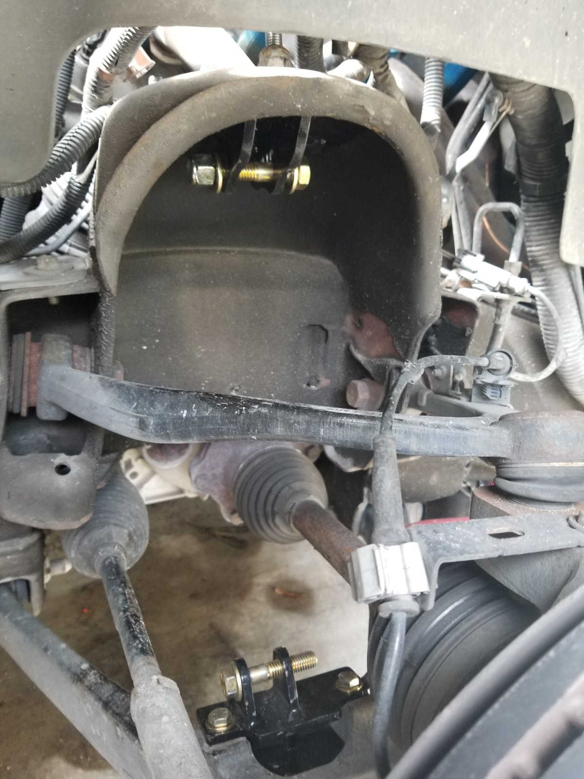

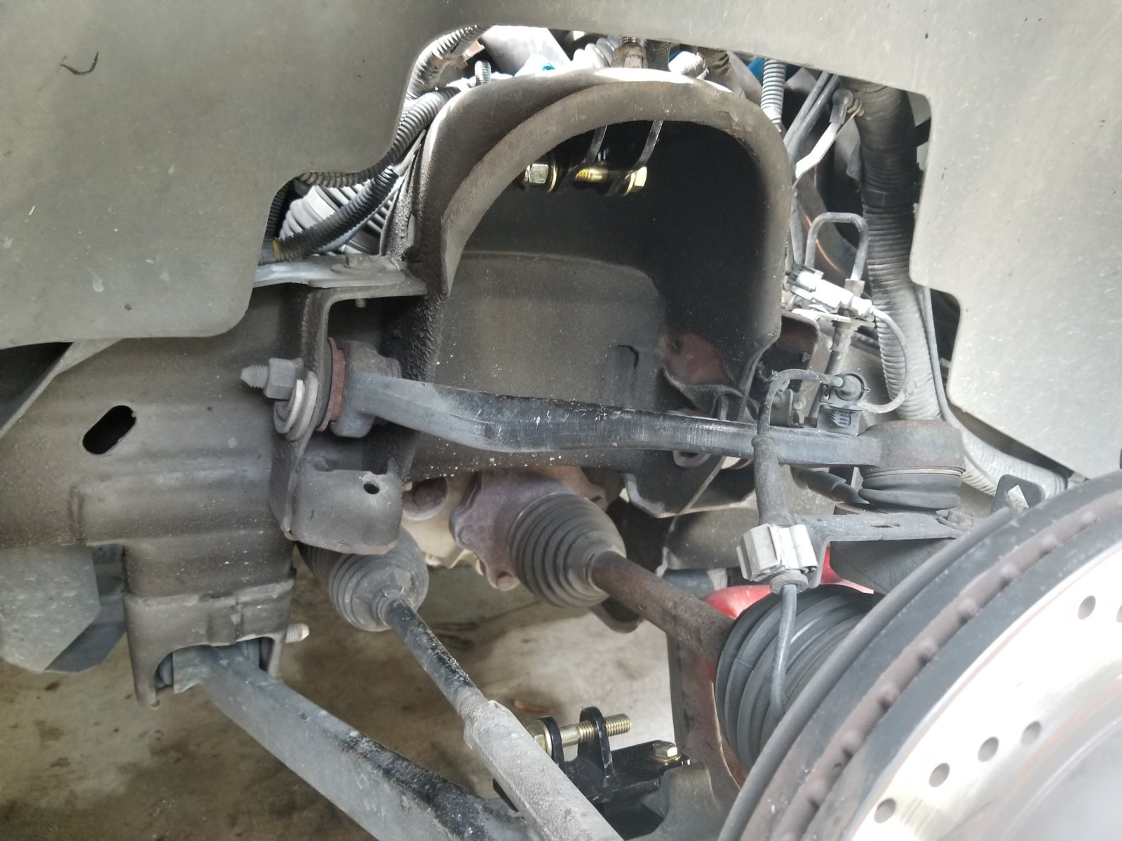

V2 underway....ill see what happens.

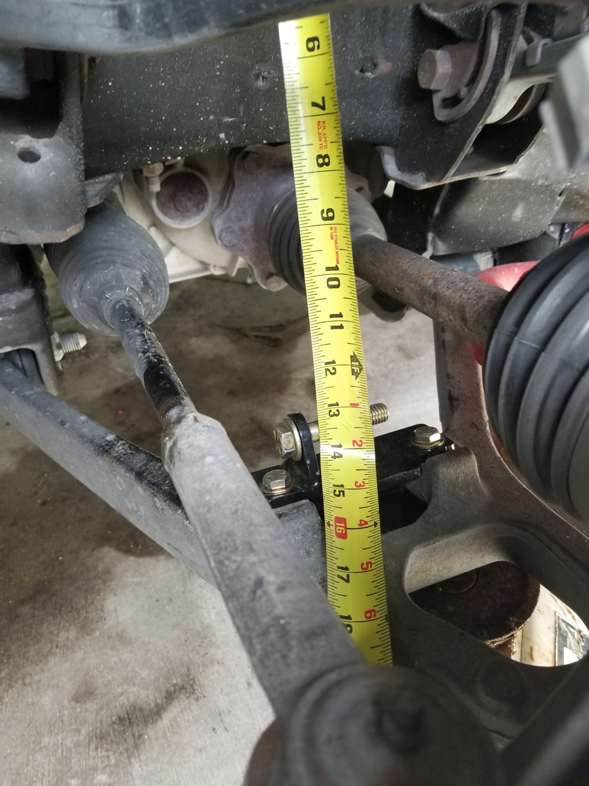

These are qa1 dd501, 12" close/17" open (for ride height 13.5-14.5). Last time I had it apart I measured ride height at about 13.75 eye to eye on the shock mount for 17"center of hub to fender. I'm good with coming back up a little bit. Springs only preloaded about .5" looking for truck weight to drop them about 2" to get to ride height.
opened one of the shock boxes to find the bearing mounts was the steel one i needed to order for the other set, guessing someone bought/returned and lost them or something, shock was still in factory packaging just different bearing kit. and the thrust bearing kit and wrenches i ordered came with enough to do 4 shocks :lol:, so at this point all i have to do when i pull the other shocks out is swap one set of bearings and they can go right back in.
Also front left tire seems to want to roast anytime I get into it (worse than before) so I'll be playing with sway bar lengths, maybe move the battery to that underhood location....try and get more weight on it

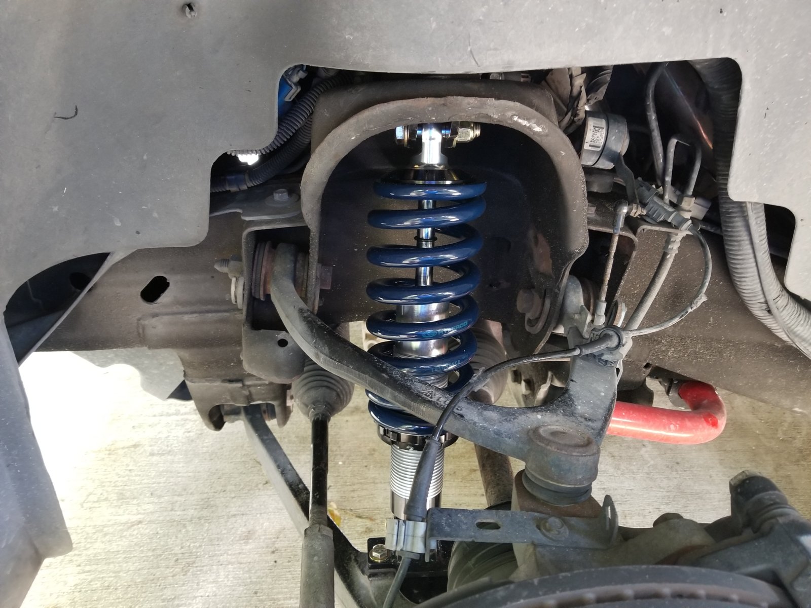

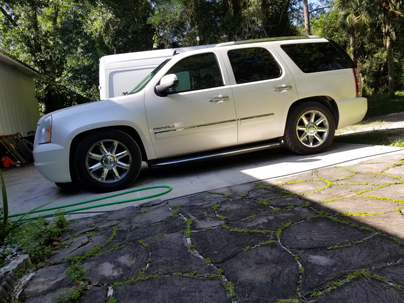

filthy... and ready for wheels i think.
only did short drive seems much better with this set up, could prob have done 750 or 800lb springs for a little more drop but it rides nice for the little bit i drove. time to mess with settings next few days

Probably only an inch maybe inch and a half. Could prob loosen preload a little more but it's good. 750/800lb springs would work nice.
