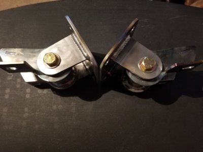

Brackets arrived, awesome fast shipping, powder coated.
bearing kit is wrong. Needs to be 1"wide not 1.5".
The bearing included with the shocks is the right size but plastic/poly. Correct part number is com8t-102pk.

I did do *something* productive today...
Flipped the rear shocks :D
Driverside was getting rubbed by the parking brake cable, passenger side was rear close the the sway bar.
Found out it doesn't matter which way I mount these shocks flipping them frees up some space.

View attachment 200325 View attachment 200326 View attachment 200327
That's a great idea.
Wow, that's crazy. It actually wore some of the material away? Are the bodies aluminum?
My drivers side rubs on the shock as well but hasn't worn through like on yours.
