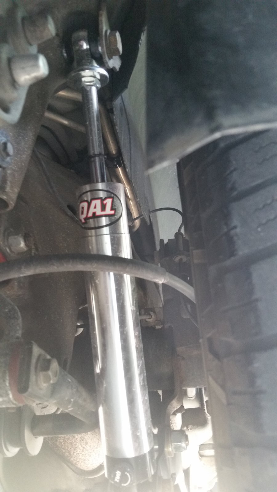

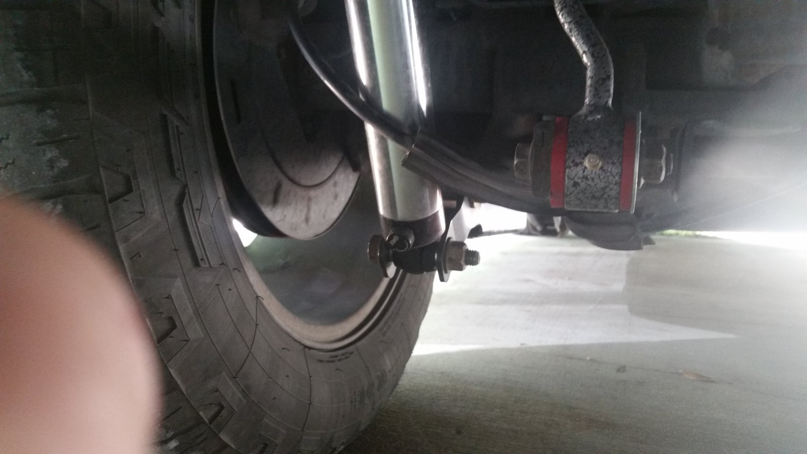

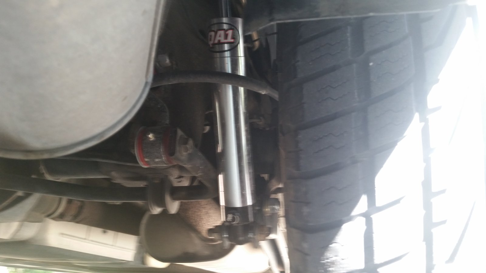

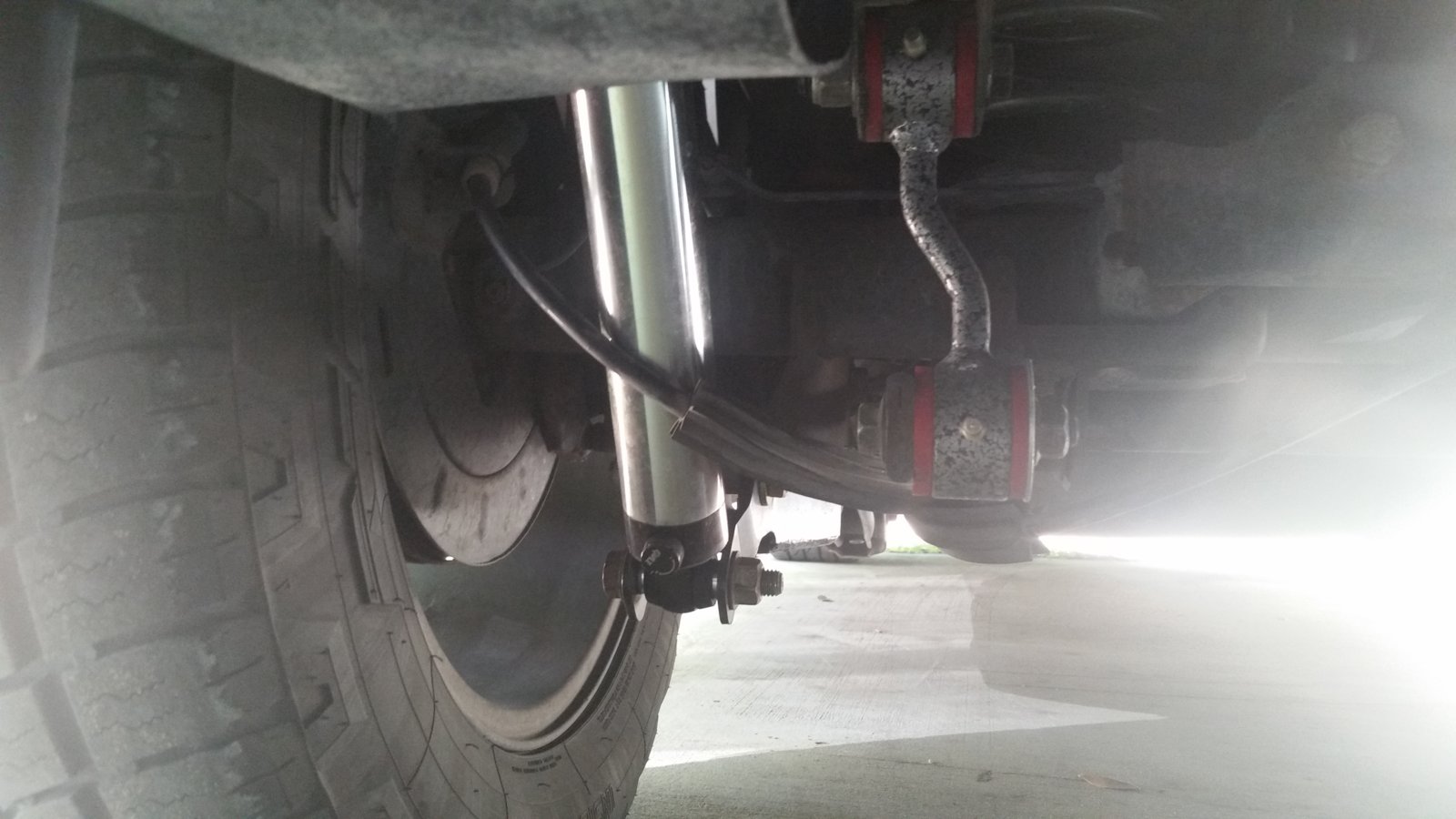

Got all this on earlier to day, everything worked out perfect - i am horrible about taking pictures but i'll crawl under and take some in the morning. The QA-1s come with a bushing in the 3/4"poly (it's "for" a dodge dakota) that is the correct length at the mounts but is only 1/2" - My truck had 9/16 (14mm) so i did grab the correct sleeves, also the ones that it came with have two c clips that keep the shock centered ion the bushing, i couldnt find any sleeves that also had them (ours are pretty well in line i dont know how big of a deal it will be) i will see if it forced it's way to way side and figure something out. QA-1 makes a longer sleeve 2-1/8" iirc that could be cut down that has the indent for c-clips if needed.
removing the air ride shock did seem to drop it some more - i will end up putting the spring spacer in for now until i figure out what i'm doing with the front. Also the panhard bar is kicking the axle over and getting some tire rub so i'm going to go ahead and order the spohn adjustable. i drove around with it on the softest setting and ride was still pretty smooth. anything over like 10 is real bouncy

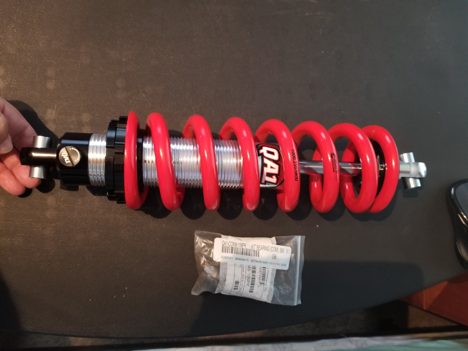

Next up for the front....
Well i was trying not to go much lower, another inch i think would make me happy :anitoof: . These should give me another 2" drop on top of the drop spindles - 800lb/in springs, 900lb/in springs are available and may put me where i want to be. Otherwise i gotta go back to stock spindle, but i think it'll be fine.
I will pull the rear spacer out and probably do the heater hose on the coil to drop the back as far as possible.
waiting on a brackets for the front, I may try and get free mod done this weekend if i got nothing else goin on .
