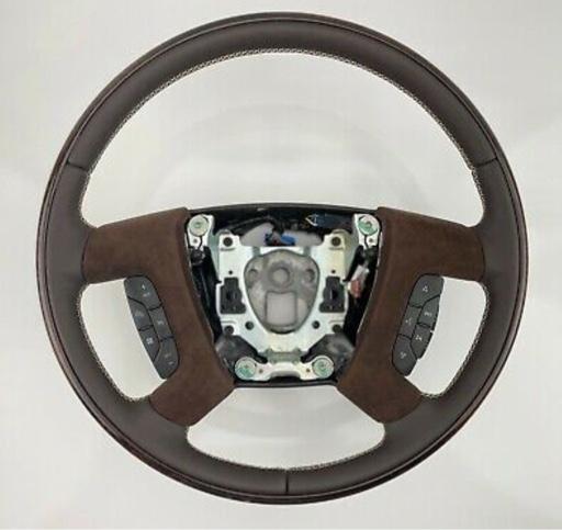

There’s an eBay seller that custom rewraps them
https://www.ebay.com/itm/194047402955?_trkparms=ispr=1&hash=item2d2e2063cb:g:RSwAAOSwlspgfL8t&amdata=enc:AQAFAAACcBaobrjLl8XobRIiIML1V4Imu%2Fn%2BzU5L90Z278x5ickkfKe2vUidqHRg3XM2X2xOVHMdfqctgbp2my7ZoF8LapdOSM3GTwvjhreonl45S8l%2Bp69dmbUC5hY20a5Qxr%2FZ6hJHla9bLeLJ7z8Co4j6X6rHP6w8avROSB5RubucQQqeYPBX6Oy2ZbcQmsEJcnZ5hu8MNo042tIbU%2FkWc89zGKR6L35s2uB90pa6tR1r1%2BJT4f%2Bxbz8n1UTTTLBX%2BJ9MU8VqFEmxaTlIIkFTevOrYQzeNO8gq03Pjy%2B6IAmYguz3AE6pO3V4V61djvwGfIg5hy%2FYkFFjeRg78xzen%2B1RDlPlKq8u5tGiW8y6UpxoZpspqP3S4o0uLjapNgwORku7M4z%2B8fxH%2FiztLgild50VgESch4KbIBrRpTH07j72mpgCQurPWi%2FZTIfxVZHJYLL5jMWge2zfgam85cutgHozBqyTYYVH6ySRyzt3DrVo8JMmXqbMaKuTeg6BS%2FntPAxAlrUygSMB4MIfuQsdWoYMPrCngiwPgOU9vU0RBq7G5dbxIxdqMHEG7mPeRzrOmGhYLNmT7GQX77FRu2%2FuEJE%2BpzEt75Z14tA2wKm7q8mtPdWBuPjqZXhmsyySCbIT3UO%2BT3YiEJk4iOVq3ck7JX6Sq40YqOxB1RGK503UQ%2F2TANKdZwPPug5dzfvuwvPlz54cCtAGfo7FgjWom2WWMwMBPo9xj6h67%2FjpRVX0Uz3OVMMgc7OxUUOw2mlnxSr%2BtZViRmxOtoOQ%2F6kutUeeG1lQ37cphIhJ7i0GB0XcVfPKzs0cVswkNE2fmN98sr09bItrCg%3D%3D|cksum:19404740295543d3b1aa5cfd445eba4bf9266c23da6f|ampid:pL_CLK|clp:2334524
There’s another aftermarket company that has new ones with all the controls too. I’ll post it up later.
