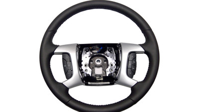

MAYBE an '07-'09 equinox/buick-lucerne/cadillac-dts wheel?
(I don't know if they are any smaller or if the splines match up...)
But the controls look to have the same resistor values and functions..
(buttons themselves look the same too)
Same nut is used also..
The controls are mounted closer to centerline of steering shaft..
So it might put your hands higher up.. and if you tilted it down, you might not see the cluster...
There's a few of these new on ebay.. And airbags are available too for reasonable.. Hmmmm....
