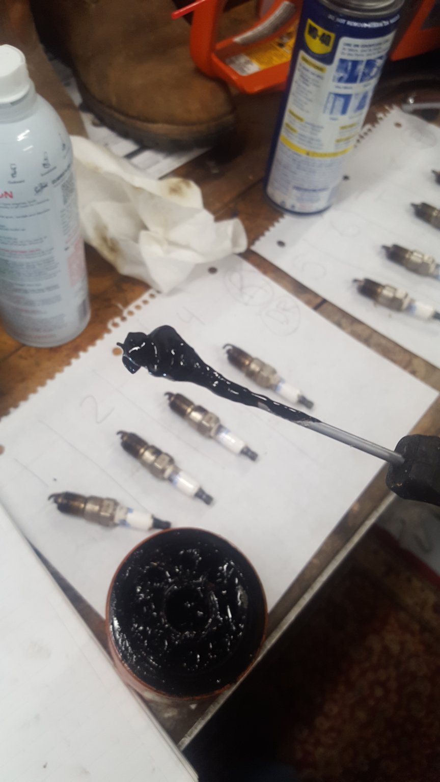

AC Delco oil sensor ordered along with 2 new knock sensors with the harness. going to rent the fuel line flairing kit so I can cut off the old fitting, and put a new one on.

Wow man. Glad you're getting in cleaned out but that's a heck of a lot of sludge. How did you come to find out it was sludged?

I did an oil change, and the filter was completely filled with sludge. That's when the fun all started.
