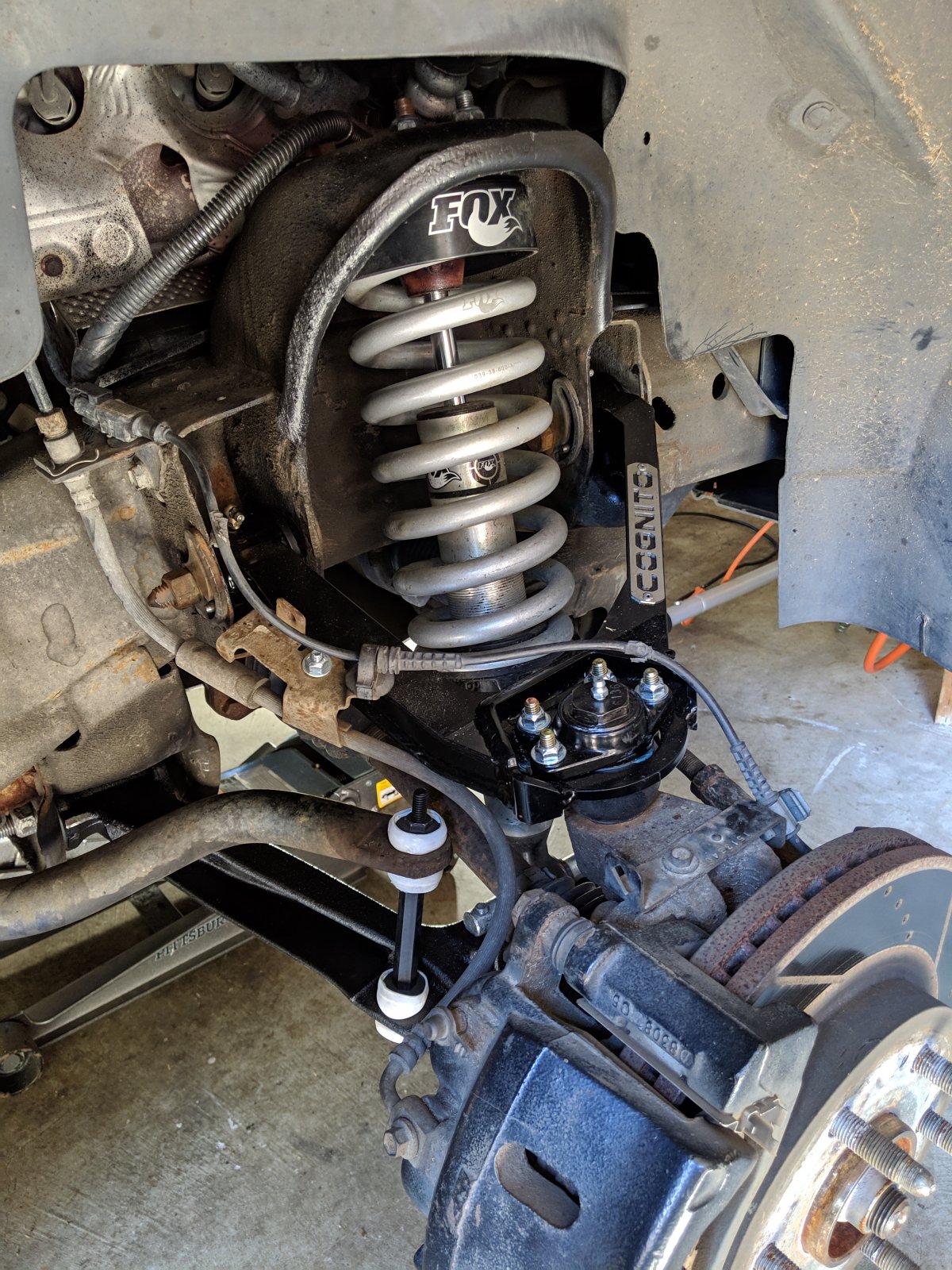

I run the Fox 2.0 setup with a small spacer in the rear. It's a great quick way to lift/level the truck and greatly increase ride quality. Also the front coilovers are adjustable so you can always maintain stock height if you like. They come preloaded at 2" (maximum) lift for the fronts.

Thank you! Here is my build sheet. I'm probably missing something but it's most of the stuff i've done since I created this build sheet:
Fox 2.0 Front/Rear leveling lift shock set
Daystar 2" rear spacers
Method Grid MR309 Wheels, 20x9, 6x5.5, offset: +18,
Backspace: 5.75 MR30929060518
Nitto Ridge Grapplers 295/55/r20: Required extensive trimming
Cognito 110-90295 upper control arms
MOOG CK620956 Heavy Duty lower control arms with problem solver gusher bearings
Mevotech TXMS50820 Heavy Duty Terrain Tough stabilizer bar links
Power Stop K2070-36 Z36 Truck & Tow brake kit (didn't like the pads instead I used Wagner OEX ceramics)
S&B 75-5059 cold air intake
Magnaflow 16564 catback exhaust
Detours of Maine Overlanding Solutions custom built spare tire mount
Tyger Auto TG-AM2C20438 Star Armor side steps
Hypertech Max Energy 2.0 tune, adjusted shift points, rpm, wheel/tire size, disabled cylinder deactivation
Vinyl Wrap matte black for the gray part of the bumper and emblems
Plastidip matte black for the grill
LED headlights and fog lights
Rough Country 72730BL black series LED light bar behind grill
Pioneer AVH-W4400NEX in dash DVD w/wireless android auto and apple carplay (one of the best investments i've made, the wireless carplay feature is awesome)

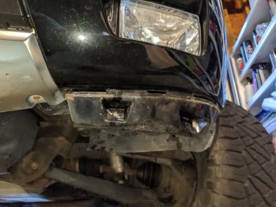

Here are some pictures of the trimming of the front fender well I did. You can see the front lip of the bumper is actually just a cover. You have to remove it and cut the bumper which I did with a dremel tool if you want to delete those giving you better ground clearance, approach angle, and I think better looks also. I cut all of that portion out plus the plastic mount portion behind it leaving the support for the skid plate. Then I used a heat gun and remolded/folded the fender liner up and zip tied it to give it a stock appearance, and so I can still have protection against the mud and dirt from getting up in the fender well.

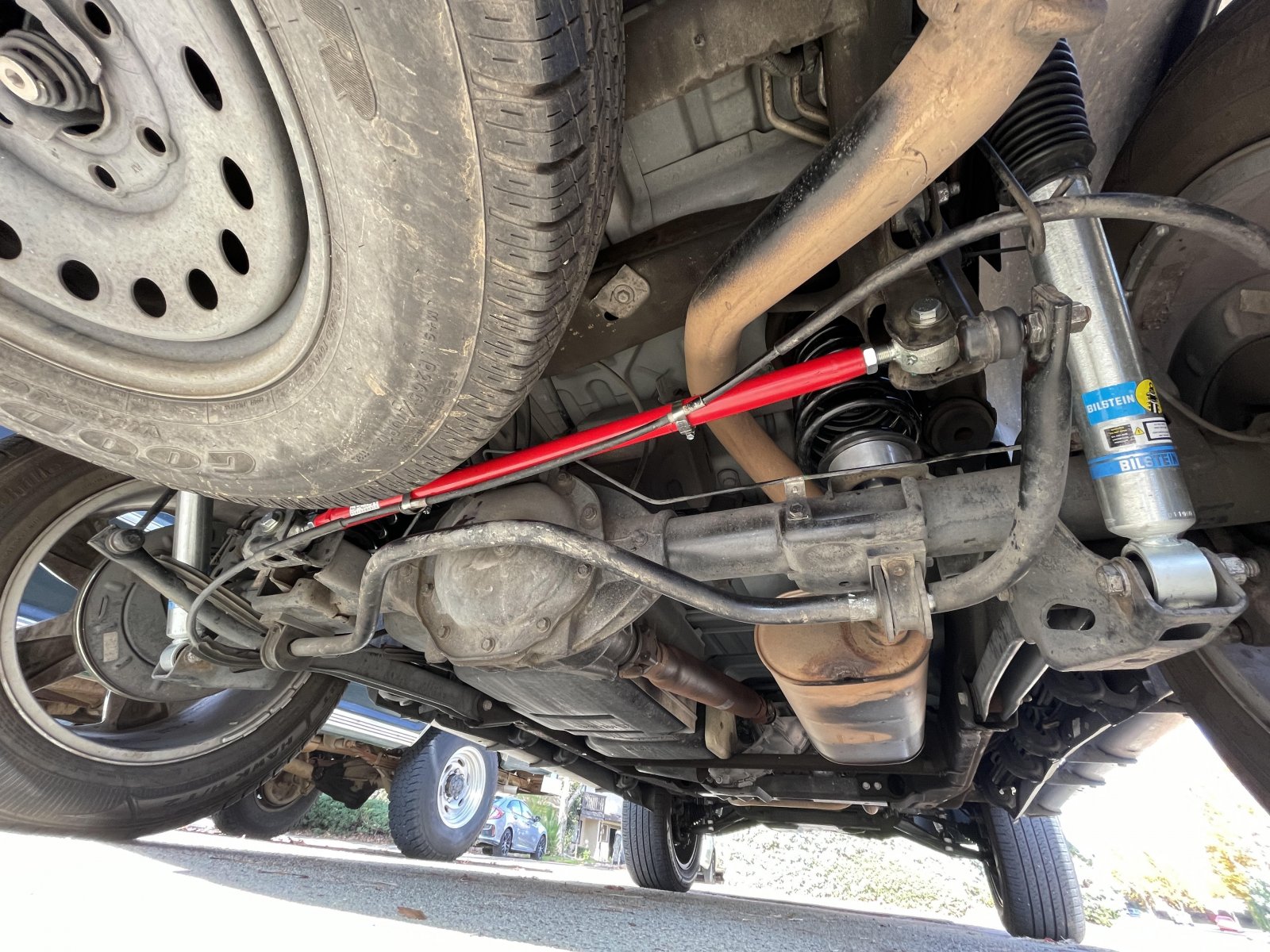

@jcsswix Hey man your build inspired mine and I have just finished putting a bunch of parts on and I had a question about your track bar. I don't think I have much lift installed but my rear axle is already way off center. Have you done anything about your rear track bar or is yours still centered?

Hi Dustin,
Thanks! I'm glad you were inspired to build out your ride! You should throw some progress pics up it'd be awesome to see what you've done. I love seeing other people's trucks it inspires me also. How much and what lift did you do in the rear? I have had no issues with centering of my axle but I only have 2" spacers in the rear and if anything mine is off by 1/4" or less. With any considerable lift it's normal to have the rear axle shift a little bit. It is my understanding that this should not affect driveability or performance. If you feel like it is I recommend buying an adjustable rear track bar. I believe Spohn makes a nice adjustable rear track bar for our models. I'm sure there are other out there too. I hope that helps!
