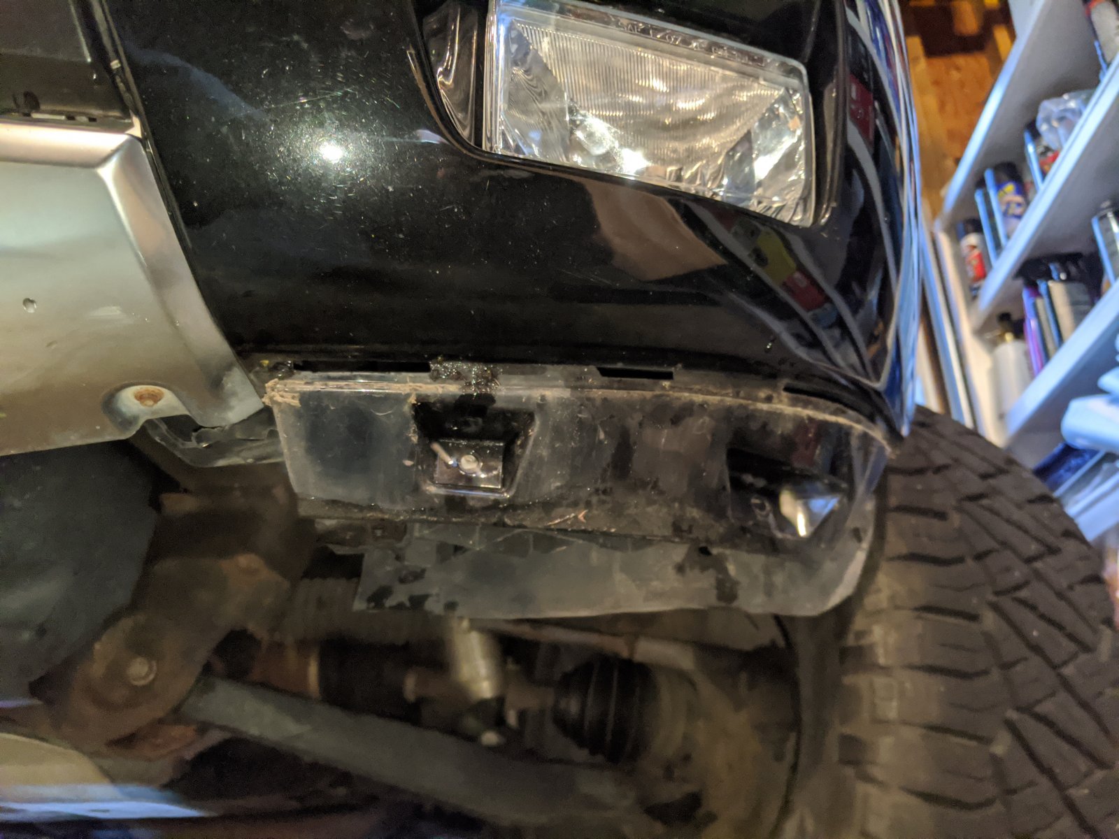

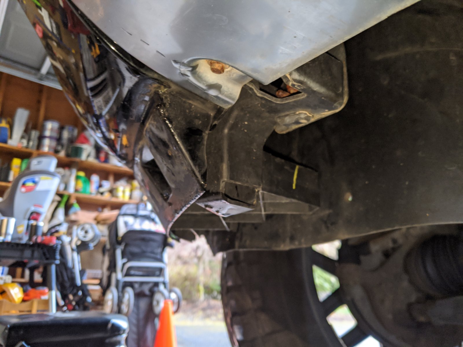

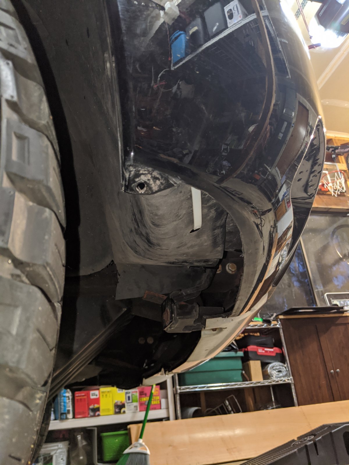

Here are some pictures of the trimming of the front fender well I did. You can see the front lip of the bumper is actually just a cover. You have to remove it and cut the bumper which I did with a dremel tool if you want to delete those giving you better ground clearance, approach angle, and I think better looks also. I cut all of that portion out plus the plastic mount portion behind it leaving the support for the skid plate. Then I used a heat gun and remolded/folded the fender liner up and zip tied it to give it a stock appearance, and so I can still have protection against the mud and dirt from getting up in the fender well.
