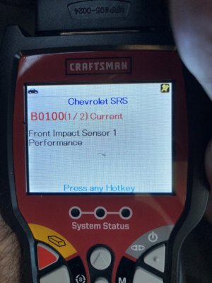

last weekend I removed my front seats to do some work on my center console. After reinstalling them and starting the Tahoe my airbag light came on (battery was disconnected for seat removal).
I check seat connections (no airbag in seats) and use my scanner and get a B0100 code (front impact sensor performance).
I ordered new dorman sensors and replaced both front sensors and after clearing the code the airbag light comes on. So I removed the new sensors and put the old ones back in (swapping left and right) and get the same code.
Any ideas?

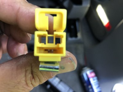

I would double check the pin fitment in the terminals to verify they’re all snug, clean them up and spray electronics cleaner in the female side of the connector and then top it off with some die electric grease, slap it all back together. If there was no issue before you removed your seats then I’d be willing to bet it’s just a loose, sloppy connection. Don’t forget the two wire airbag plug that looks like it does nothing too.

Just went under the seats. The yellow airbag connectors there are nothing!
I unplugged the airbag brain last weekend and cleaned it also.
Any more ideas?
