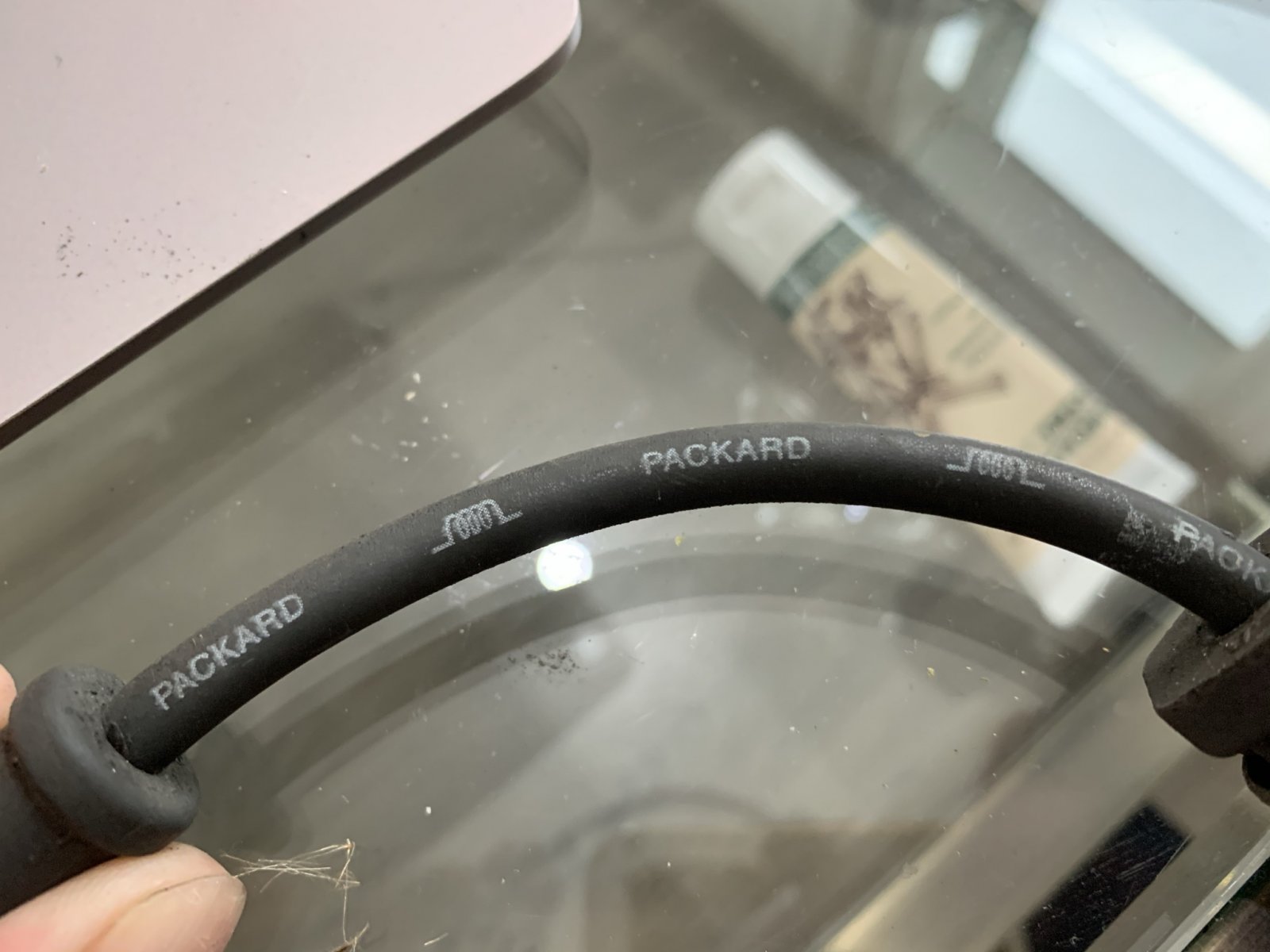

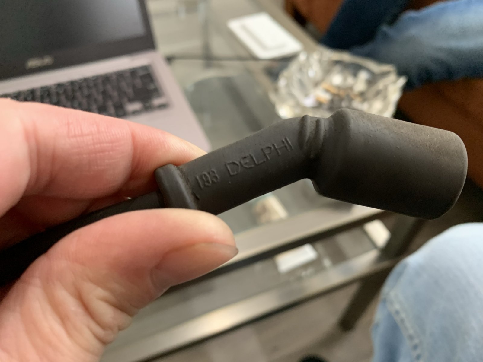

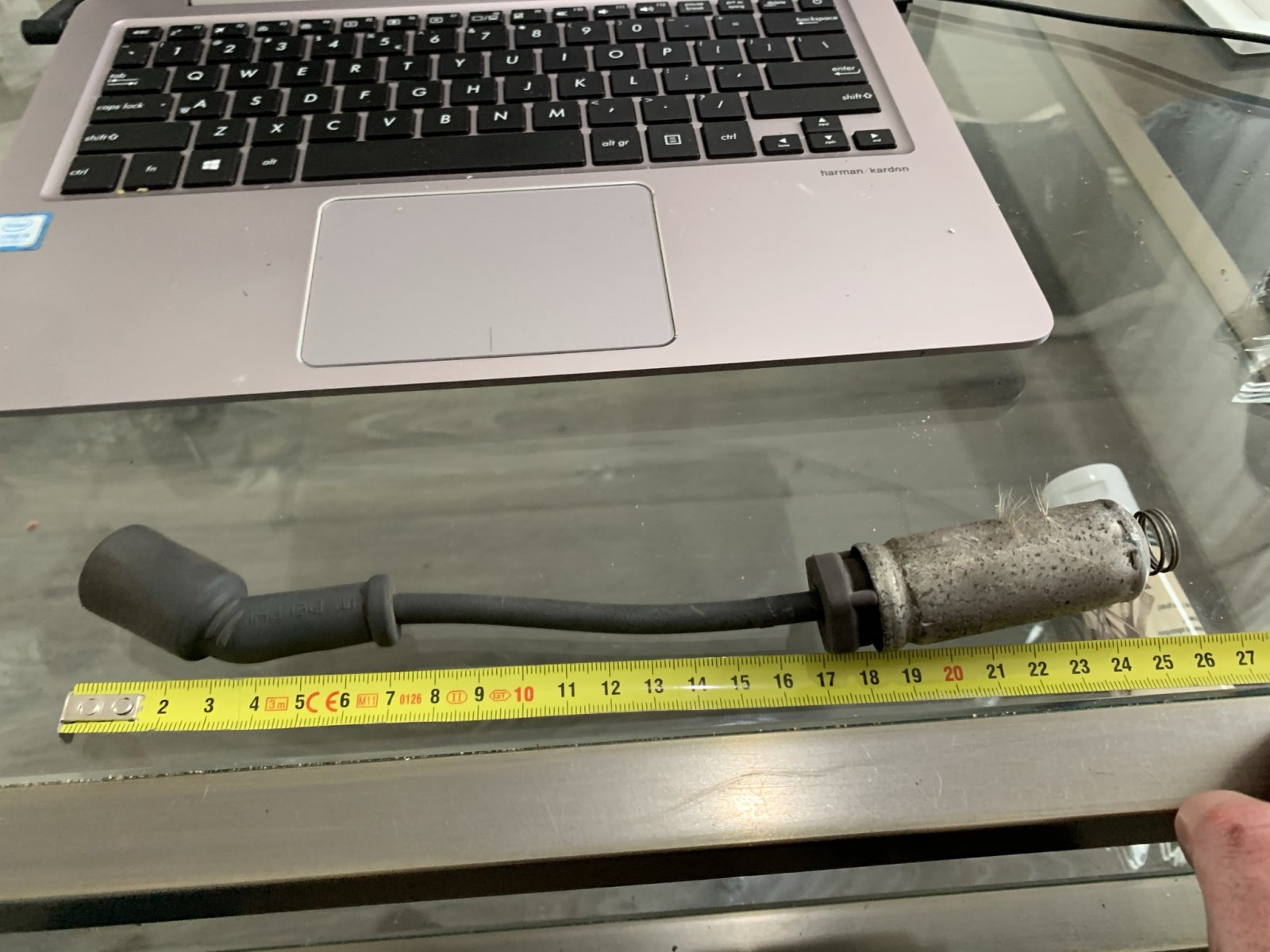

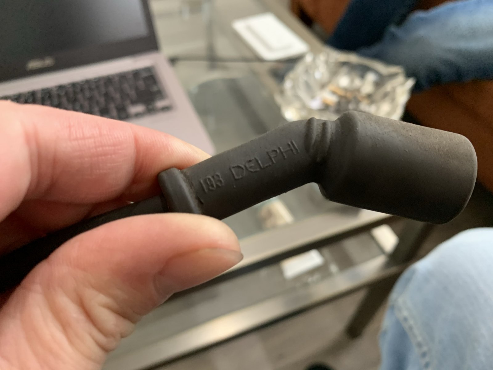

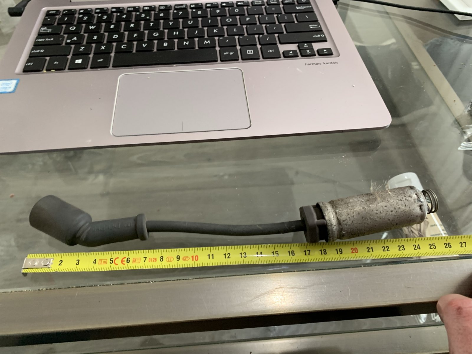

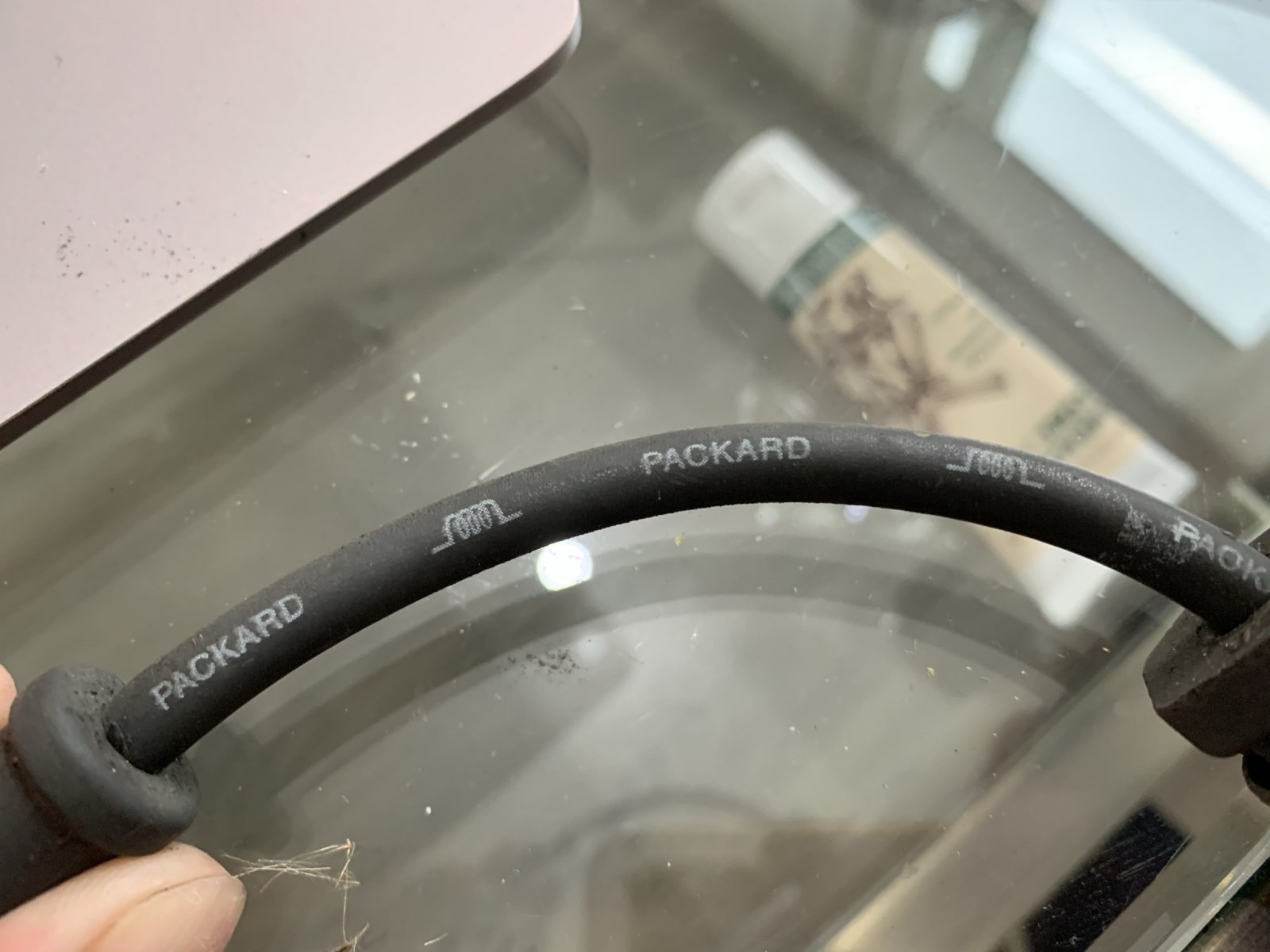

Alright, I don't think these are the factory wires. But because one has been fixed, and did change sparkplugs, oil, filters, gaskets etc. last year.
25 cm is 10 inch long. Delphi 193?!
45,016
View attachment 267428 View attachment 267429 View attachment 267430
Those are the wires that come on them from the factory. It looks like the heat shields are fine. Remove them and slip them onto the new wires. If you can find those exact wires for less than AC Delco, then get them. Here, they're $41 on Amazon: https://www.amazon.com/Delphi-XS10388-Spark-Plug-Wire/dp/B001NYX9KK
There's absolutely NO benefit for you to spend extra money on spark plug wires. If your factory ones lasted so long, then a new set of factory (or factory-equivalent AC Delco) should serve you just as well.
