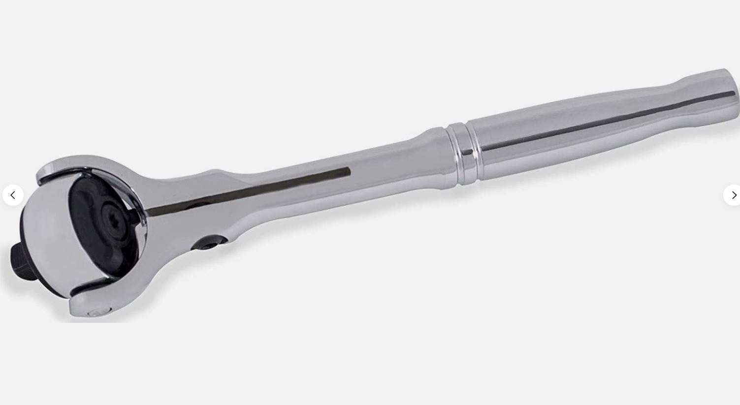

i adapt a spark plug socket down 1/4' then use a swivel head ratchet like this one and a breaker bar over that and easy peasy
the swivel head allows just the right angle for clearance
