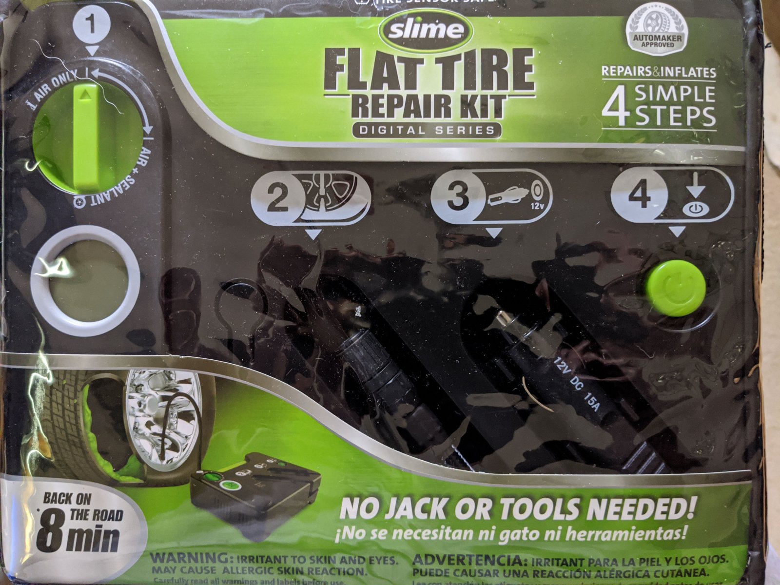

I don't carry a spare, as I had to remove it to install my Gibson Extreme cat back dual exhaust system. Instead, I carry this with me for a potential flat tire.
