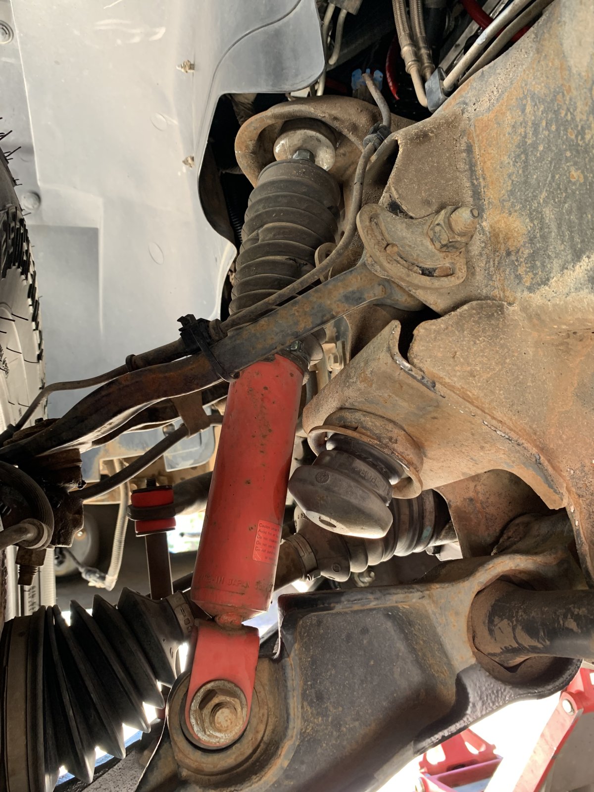

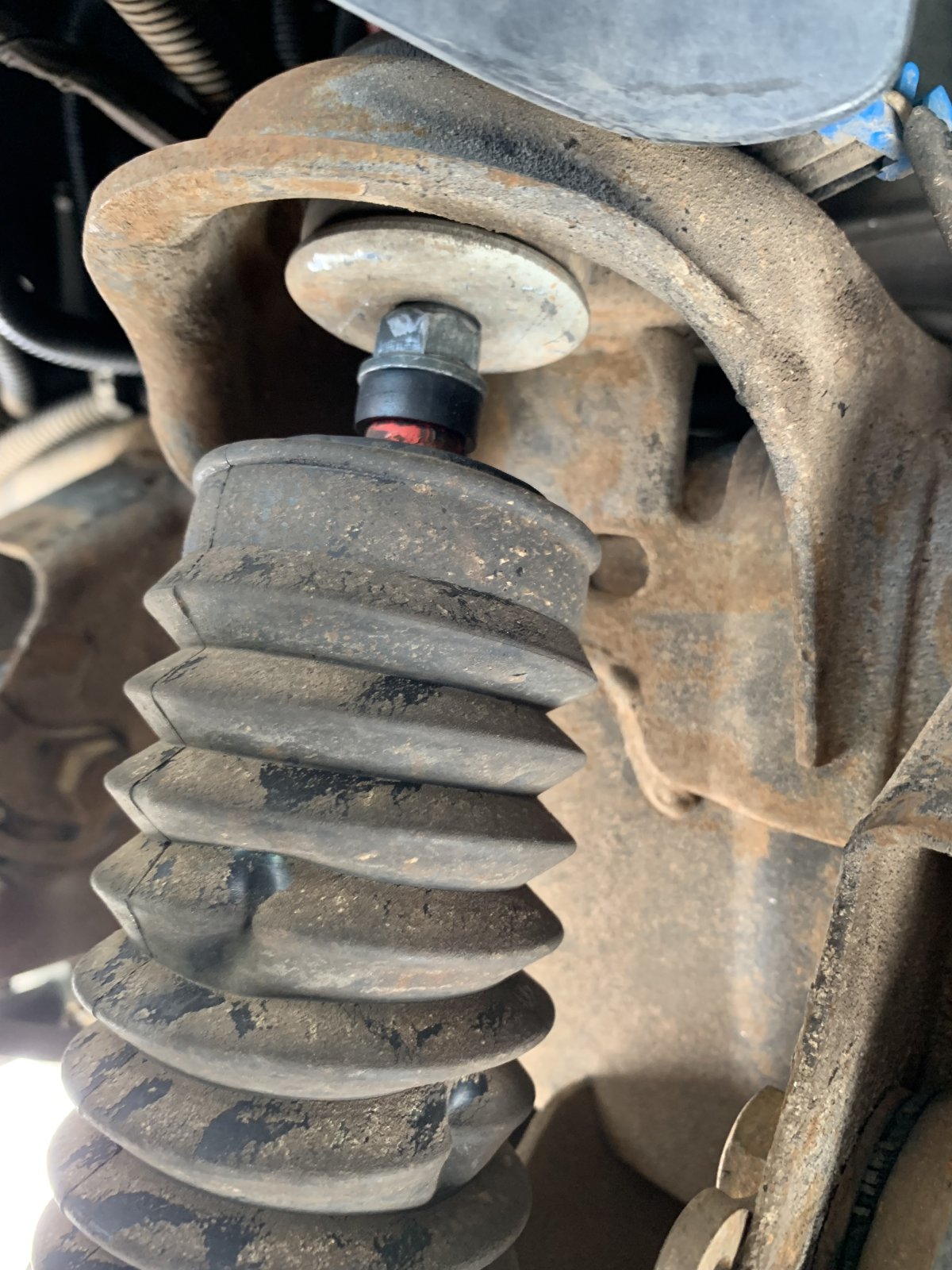

Only thing with the mono max front shocks are they are too short unless you are stock height. I had to space out the front shocks running my 2” front torsion key lift to obtain 100% down travel.
The bilstein 5100 are a little too long up front when you just have a 2” torsion key lift so pick your poison.
The rears are just fine for both brands
I have the KYB Monomax in my '06 Denali with keys/offset arms/cut bumpstops, but I ordered mine for 2-4" of lift. Same cost, btw.
