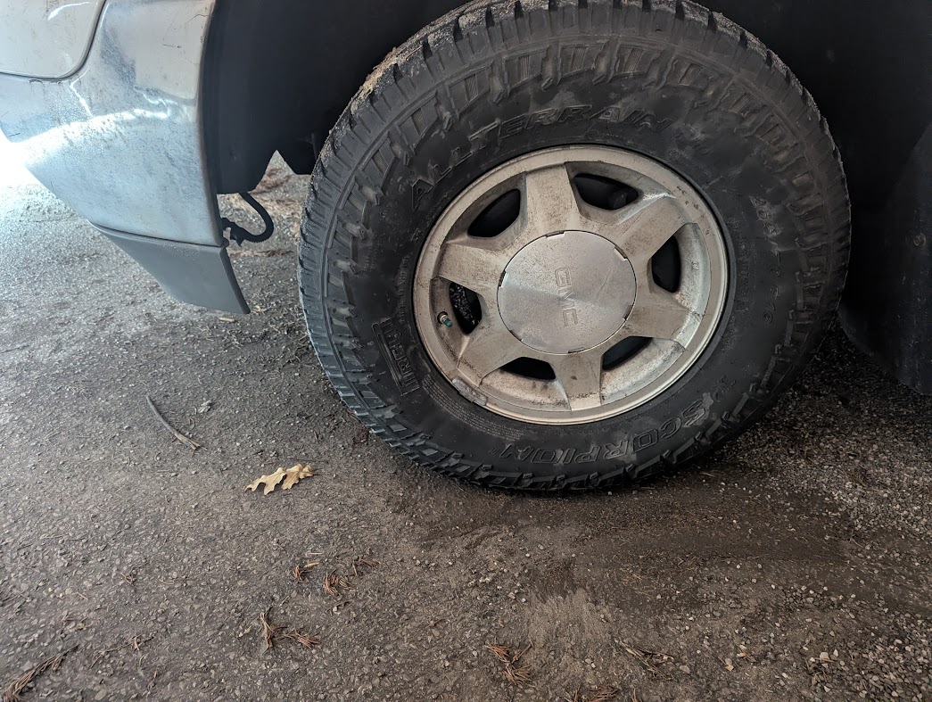

Hi there folks,
I currently run the 16 inch Stock Alloys with Pirelli Scorpions.
265 70R16s
