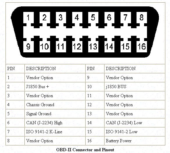

You know at any OBD2 connector you can jump 2 terminals with a paperclip to turn on the fuel pump, right? Or you can use a bidirectional scanner if you have one to command the fuel pump on too or goto fuel pump relay and pull it and jump the 2 terminals at the socket that attach to the relays normally open contacts which are #30 & #87.
GM fuel pump pin is Pin#9, jump it to ground with key on and pump is running continously.
