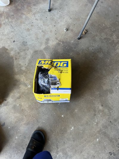

I just ordered another hub. Sending this shit back without a sensor. Idc Amazon can shove it for sending me 2 broken ones back to back
Not only is the abs light on, the brake light is on too.

LOL this is why my hubs keep arriving broken. The sensor seems to be intact on this one though
I also assume the hub takes more abuse on the road then in shipping

Replaced hub today and didn’t mess with the sensor. That fixed my ABS problem. Never would of thought aftermarket hubs would require their own sensors.
