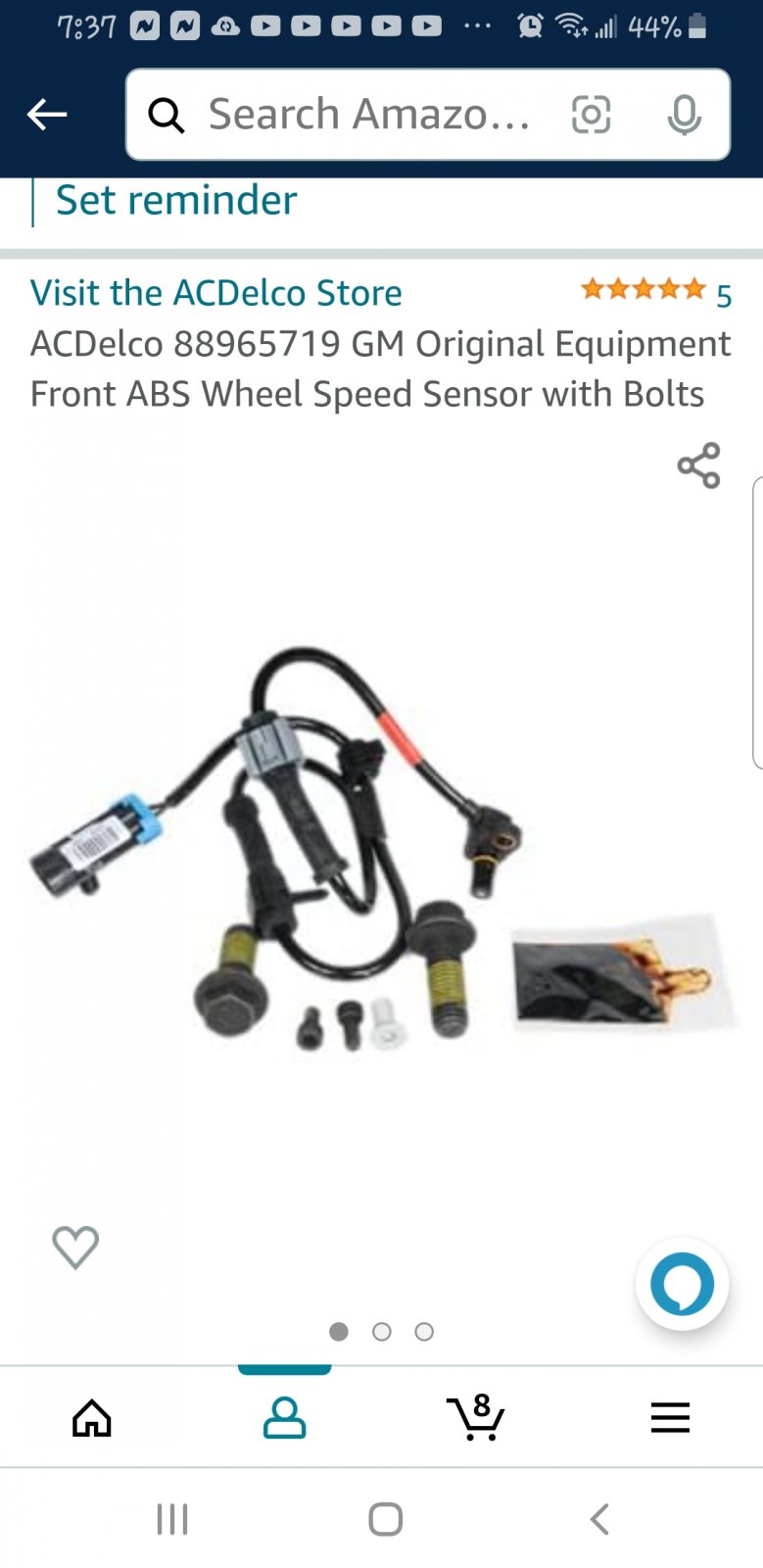

Same issue with my 03 Tahoe. Replaced the hub and an abs code popped up--never had an abs code before--replaced with original GM abs sensor and the same issue. Screenshot_20221006-193706_Amazon Shopping.jpg

Same issue with my 03 Tahoe. Replaced the hub and an abs code popped up--never had an abs code before--replaced with original GM abs sensor and the same issue. View attachment 382243
That’s annoying as f*ck. Im gonna replace it again I guess. I didn’t yank on the plug or anything so i don’t think the harness is damaged

I've replaced both sides and moved them around--same shit, no change.
Yup changed sensor today and same shit. Really frustrating as I didn’t have an ABS light prior to this. Wondering if the ac delco sensors aren’t compatible with MOOG hubs. But I don’t know why they wouldn’t be
Are you sure the hub is good? You never know....
Did you look at the magnetized end of the sensor? Also, how does the relucter--the gear looking thing--in the hub look? Any metal fillings around?
Just got off the phone with moog. They’re not compatible with OE speed sensors… wtf? Couldn’t give me a part number either. They want me to have another hub sent out. And either take the speed sensor off that hub or replace the whole hub just so I don’t have to tamper with the sensor.
Makes sense because the driver side is fine with the speed sensor provided by moog. The passenger side which I replaced the sensor because the one was cracked on a brand new hub. Is the one giving me problems.
They also told me all aftermarket hubs do this. Not just moog. So that might be your issue also
Well that sux. I replaced with a Timken, but that doesn't explain the other side. I haven't changed that one yet.20221011_175701.jpg20220624_151632.jpg20220624_151625.jpg

Well that sux. I replaced with a Timken, but that doesn't explain the other side. I haven't changed that one yet.View attachment 382605View attachment 382606View attachment 382607
So when I had my NBS I had like 9 ABS codes. They were most likely linked to a failed ABS module (from what I read online). But at $500 for replacement I just rode out with them lights the entire time I owned it lol
I just ordered another hub. Sending this shit back without a sensor. Idc Amazon can shove it for sending me 2 broken ones back to back
