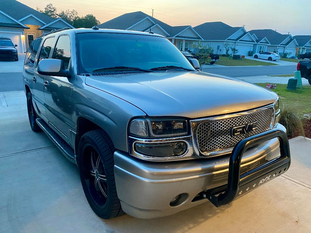

2003 Yukon XL Denali LQ4 VIN "U", 209K, stock tune.
Took it to the store yesterday and noticed a misfire on the way home at around 1K RPM then got the flashing CEL. Eased it on home, hooked up VCM Scanner, and pulled the code: P0300 Random. Since I didn't have a specific cylinder code, I cranked it back up and started hitting the manifolds with an infrared thermometer. I couldn't get a discernable difference in temp, likely due to the engine being warm so I decided to wait until today to reassess as it will just be sitting in the driveway until then. It did not misfire on the next startup after I got back home.
Now, before I start blasting this thing with the parts cannon, I want to go through everything that I can to narrow down the issue. The plan for this evening is to:
- check spark plugs
- check injectors
- check grounds
- check MAF (clean if necessary)
- check TB (clean if necessary)
- check all associated connections and harnesses
What else am I missing? I want to be as thorough as possible and I know a lot of us have had this code and it ended up being from different causes. PFA. Thanks
