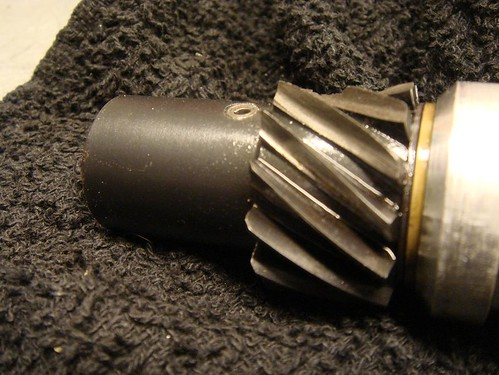

Pull the distributor and look for excessive wear on the gear. The teeth can get worn similar to what is seen in the pic below. My '98 2500 I had, had this issue. It cost me a lot of dough and time before I finally figured it out.
Got it. I will check that tomorrow after work and will report back here. Hopefully once I'm done this won't be the 350 of Theseus.

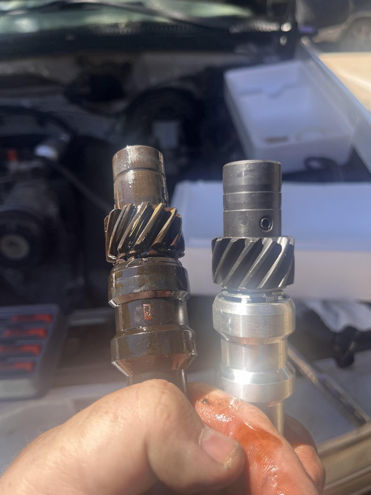

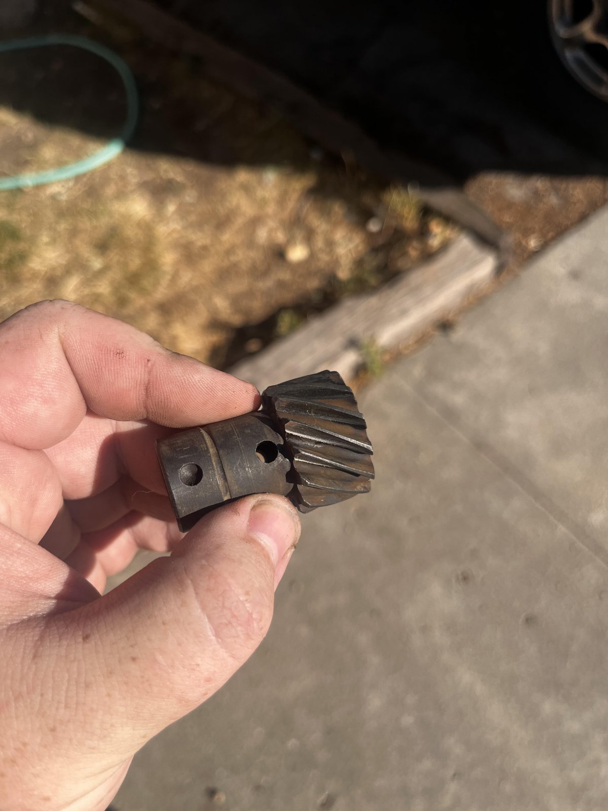

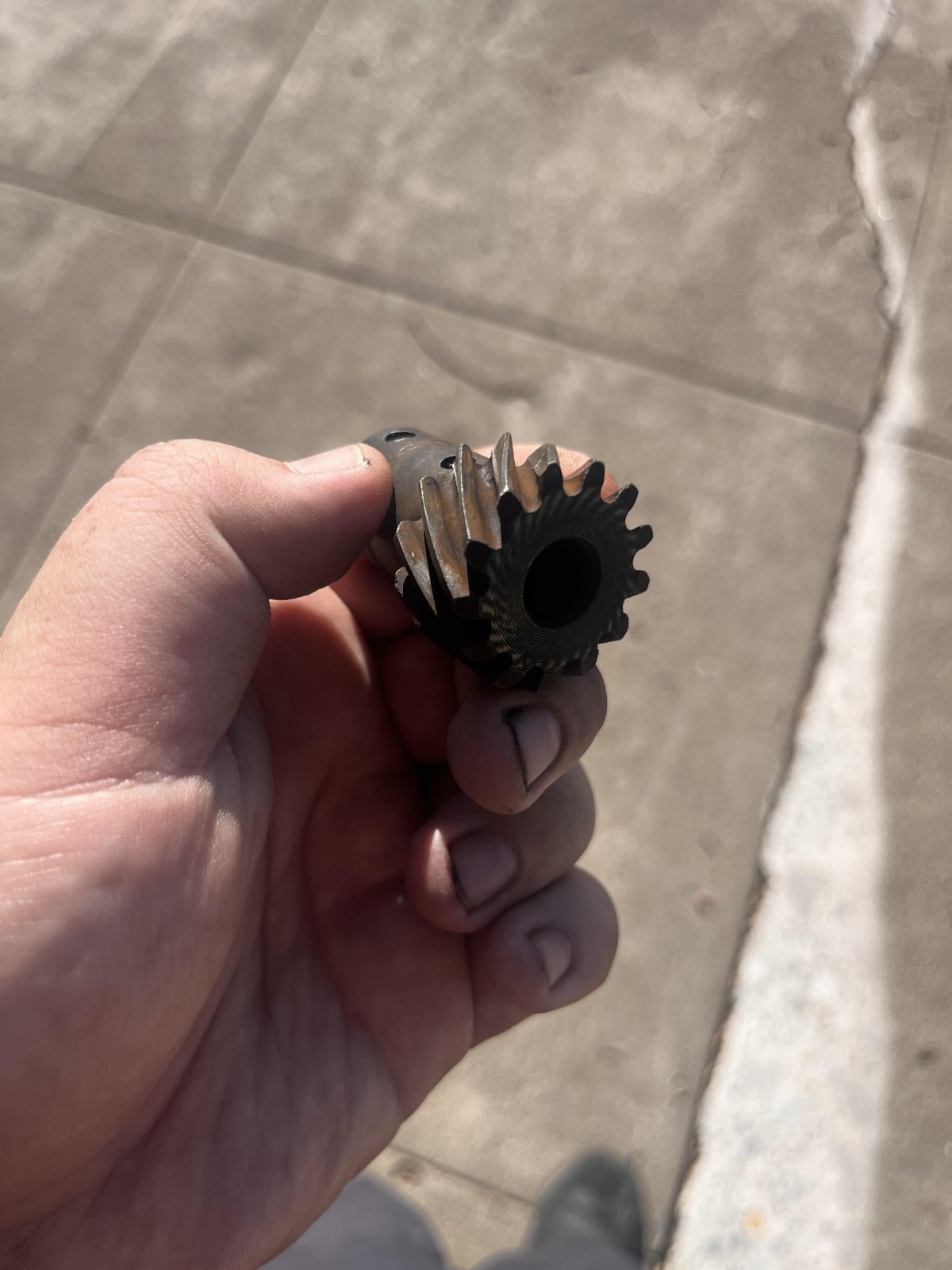

SOLVED!!! Thank you to user Hoesgottaeat2 for providing me with the exact information I needed to fix my problem. Thank you to everyone else who helped me with this problem, you are very much appreciated! It was in fact my distributor gear that had worn down and caused my timing/rough idle issue. It just so happened to be cheaper and faster to replace the whole distributor than it was to just buy the gear haha.
