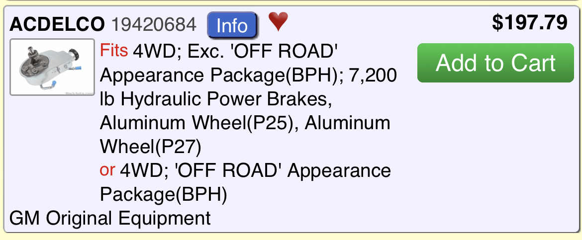

In the event that this test comes back with less-than-ideal results is this the power steering pump everyone would recommend? I’ll also be changing the two lines in the process but I have the BPH RPO code so this and the AC Delco website were slightly confusing.
If there are other recommendations for PS pumps I’ll be happy to hear them. I’d like to stay away from remanned units if possible but if there is a consensus I’ll listen to the crowd.

I personally stay away from reman products. Got burnt too many times years back......it sucks doing the same job twice and sometimes not able to get paid for the second time.
Find a good name company that offers new with warranty. I've used car quest and napa in the past and had decent luck. Lately though I have been going more to the OEM stuff whenever possible. Having online competition has made the OE stuff more competitive price wise.
