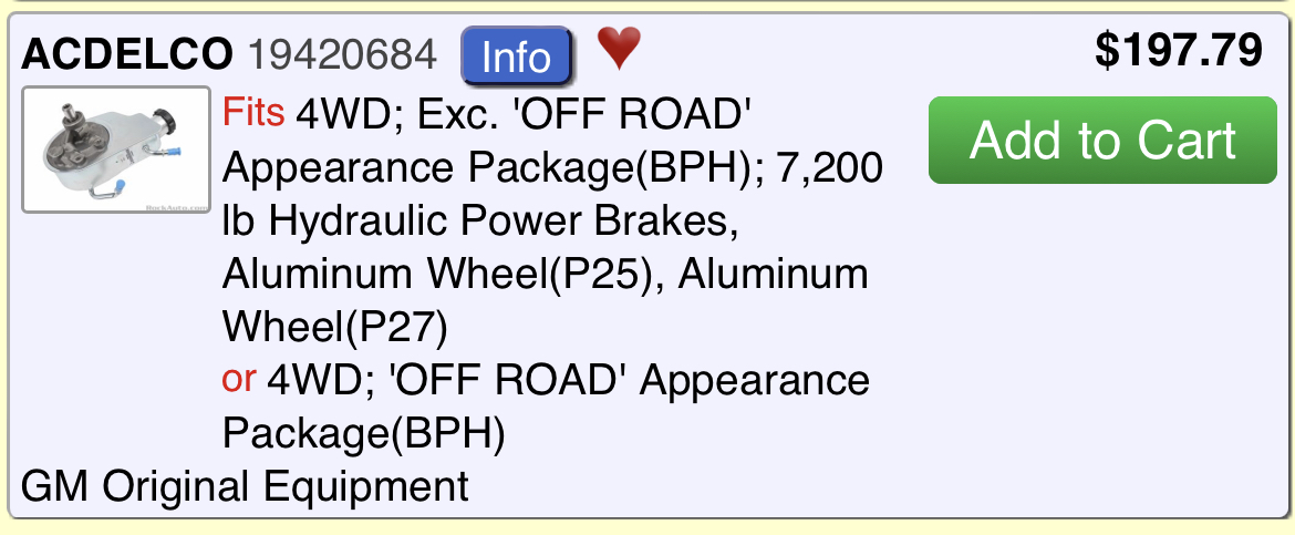

Thanks for the catch. I didn’t note that I also bled the ABS module with my scan tool twice as well. I’ll go back out and bleed the module and corners one more time at some point before Monday and see if I get any improvement.
N
nick0789
Aug 22, 2017
186
148
Update: there was no improvement in pedal feel with additional ABS bleeding and bleeding at the corners afterwards.
I’ll be testing the power steering pump pressure as I have also been feeling some still steering wheel response when in the parking lot.
In the event that this test comes back with less-than-ideal results is this the power steering pump everyone would recommend? I’ll also be changing the two lines in the process but I have the BPH RPO code so this and the AC Delco website were slightly confusing.
If there are other recommendations for PS pumps I’ll be happy to hear them. I’d like to stay away from remanned units if possible but if there is a consensus I’ll listen to the crowd.
Thanks again!
