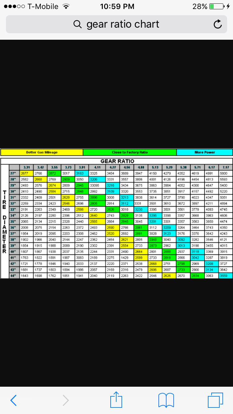

What size tires?
The 5.3 isn't a bad motor but it's not the most powerful offering either. And jacking it up and adding wider tires isn't helping.
285/65/18 Nitto Trail Grapplers on Moto Metal wheels...I never thought it would make that much of a difference.

do you know your gear ratio?

i am not an expert on gearing. but vehicle weight + those tires. I think you may have found your culprit.

That has alway kind of been on the back of my mind. I think that 3.23 is way too high from the factory for a vehicle this heavy anyways. I will check my glove box in a little bit to confirm gears.
