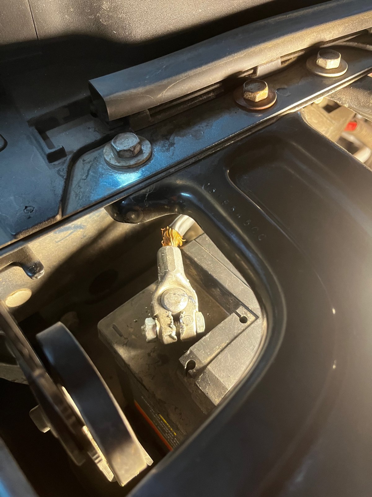

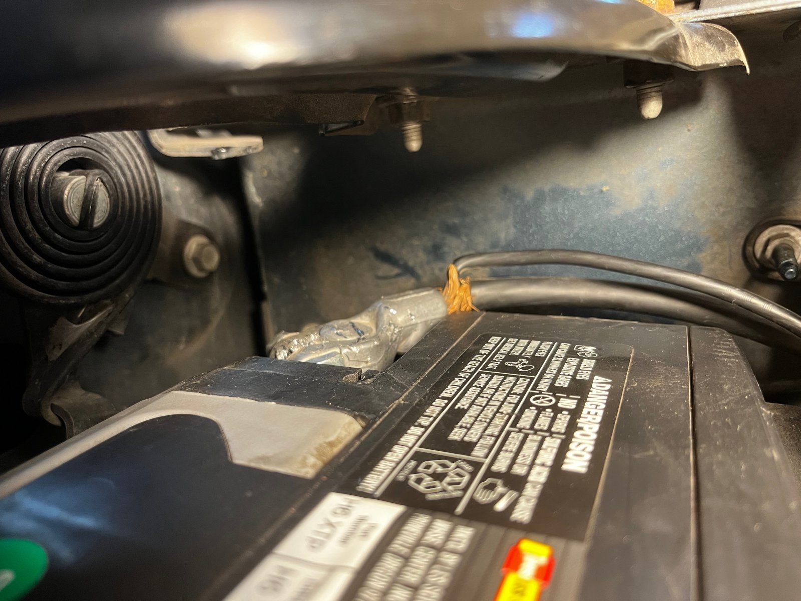

My 2009 Tahoe, 5.3, cranks slow, especially when cold. It's been that way since I've owned it, but that's only been about 2 months. I had the battery load tested - tested good and it's only 2 years old. Battery shows 12.3V with key and engine off. Engine running I see 14.7 or so at the alternator and about 14.3 at the battery. Seems like that could be enough voltage drop to cause a slow crank condition? I noticed my negative battery cable is looking pretty sketchy at the post terminal. Even if it's not causing the slow crank, I'm going to replace it. I don't have any other electrical anomalies, though.
Thoughts? Would the starter itself be going bad?

That battery cable absolutely needs replacing. Might as well do "the big 3". Lots of posts on here about how to do it and which cables to buy. But if time and money are tight, replacing just the negative cable in your case will probably solve your woes.

While you are at it, check the grounds on the engine block and any other grounds in the engine well. A corroded ground is common on these trucks.

Yes, what has been said so far and the voltage drop is fine. IMO, do both cable assembles and read thru threads here and do the Big 3 asap, especially if live in a state with salt on the roads. If you want to have a little fun. Get a helper and crawl under the engine and measure the voltage at the starter now. Then do the cables replacement and measure again. Please report back here with results. Plus, if you can afford it, replace the starter since it is likely the original. I did mine, had no problems with it, because I knew eventually it would give me a problem when away from home. https://www.rockauto.com/en/moreinfo.php?pk=4394409&cc=1442911&pt=4152&jsn=927
Pay attention to all choices for the battery cables because Genuine GM cables have a few options.

Thanks for input, everyone. I'm assuming the "Big 3" are positive and negative batt cables plus the braided ground strap from engine to firewall on drivers side? I've looked at the connections for all of those and the only visible issue is the negative cable at the post (pics that I posted above). There's not a spec of corrosion on any of them. So I'm going to replace the negative cable first and see what that does. I'll replace the starter if I need to, but not without first trying the cables. I'm in SW Washington, bought the rig in Portland OR - neither state salts the roads so corrosion is not as big a problem as it is for other areas.
Here's the cable I'm purchasing, AC Delco.

the proper way to test the cables is to do a voltage drop test
put a lead on the battery ground and a lead on the starter positive connection and check the voltage reading it should be the same as the battery or very close to it.
then have a helper start the engine and watch the voltage while the starter is engaged
if the voltage drops below 10.5v then replace the cable
I would check the ground ohms also from starter body to battery negative.
usually low voltage will just make the starter make a clicking noise or not even engage at all.
as others noted it could be the starter is tired. If you end up replacing it I would get oem or better (higher kilowatts)
