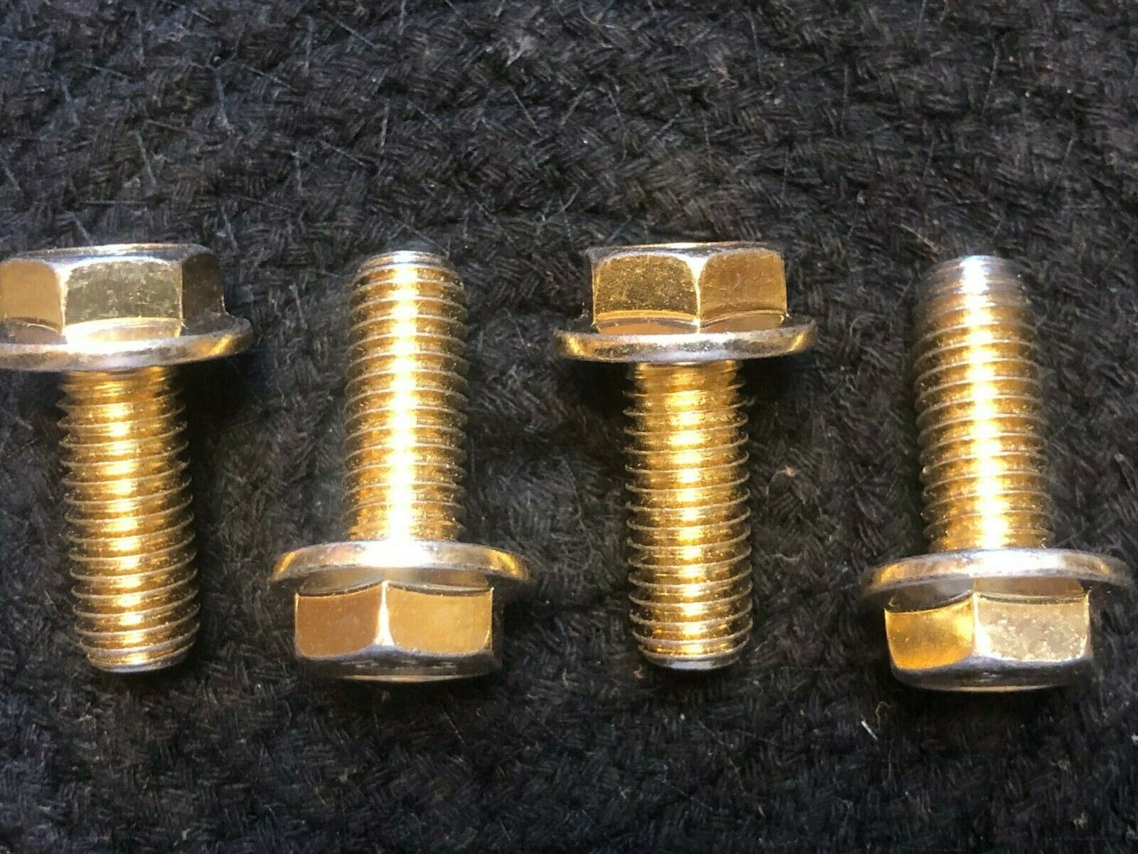

These are the 4 bolts i found on eBay which are aftermarket but are a replacement for the OEM part number 11518341. These are said to work for the transfer case skid plate as per another GM Parts Website, although I am not sure if they are the same bolts required for the front skid plates or not. They are selling for $17.99 + tax on eBay. There must be a reason that the thread pitch isn't listed otherwise I too would just go to the hardware store and buy some bolts for mere dollars.
The holes in frame are not tapped so that why I went with body bolts they will self-thread and also have large washer on them like factory bolts in plastic cover. The bolts you are looking at I would run bolts that came with vehicle first take out then install bolts you are looking at.

the oem bolts are self-taping, usually nothing else will fit. you might get the aftermarket bolts to fit after inserting oem self taping bolt first.
other than that DO NOT OVER-TIGHTEN, they will strip easily and then you are stuck trying a find a larger bolt which will also not fit.
get them snug and walk away.

I just found a post on another forum, gm-trucks.com, that states the factory skid plate bolts are the following;
11518341 - BOLT, HEX, M10X1.5X25, 14 THD, 28 OD, 6202M, 7114M, TAP, TR-PT (ENG SHLD)
M10 = 10mm diameter
1.5 = thread pitch
25 = 25 mm length
28 OD = 28mm diameter SEMS washer
TAP = Tapping (self tapping)
TR-PT = Tapered Point
It seems as though your 8mm bolts are too small and lowes does not carry a 10mm option.

I think I'll get a 10mm tap and some hardware store bolts and send the $20 4-pack bolts back!
