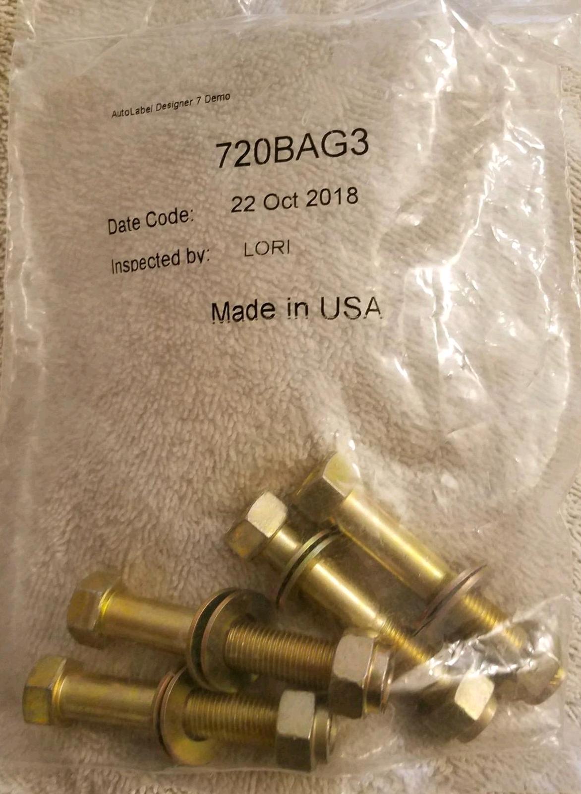

No I DID NOT AND WOULD NOT.... all of the weight of the front end would be resting on those 4 bolts...
I bought the Grade 9 hardware that Rough Country sells with there 2" lowering kit... it was around $20 if my memory serves me.
Part number for the bolt kit is on the bag in this pic...
Rough Country part #720BAG3

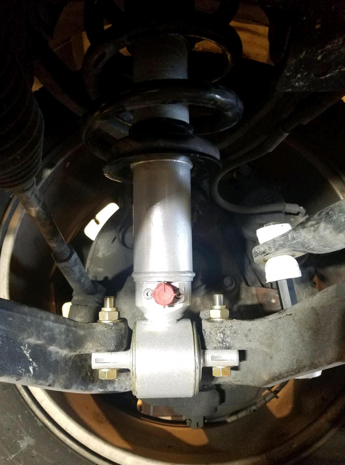

Here is a pic of my Rancho 9 way adjustable struts mounted using these bolts to give you an idea of the bolt length...
Hope this helps.
