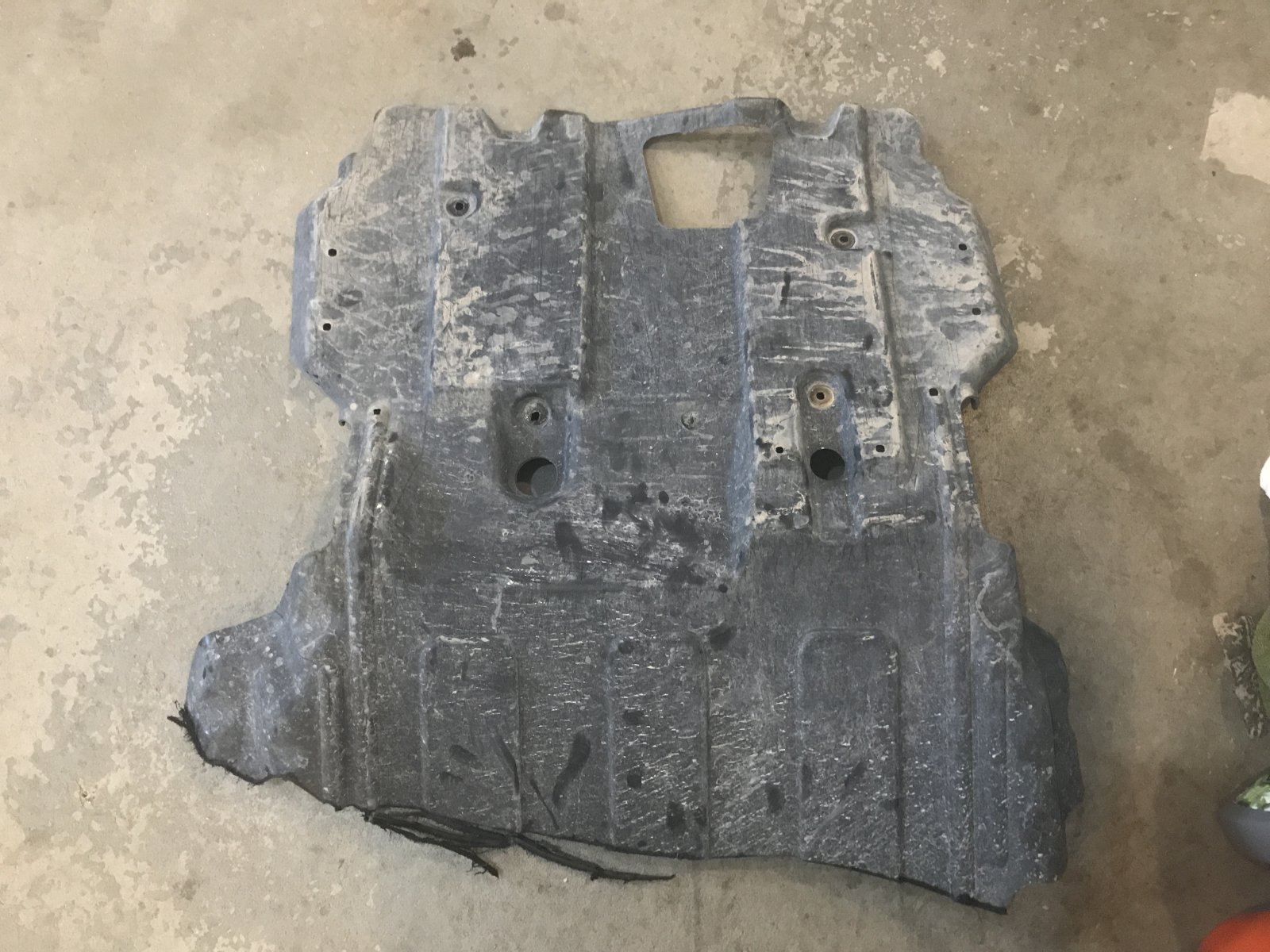

I’ve read through some of the skid plate forums and am not quite finding the info I’m after. Recently had my OEM plastic cover (part number noted above) fall off and grind a good chunk away on the pavement. Not real keen on spending a ton of money replacing it, are there replacements besides the $200+ GM Parts Direct option?? Looks like some folks recommend skid plates that involve tapping new holes, I really just want to protect that area again for as cheap as possible.
2015 Suburban LTZ 4x4. In Michigan if anybody wants to sell me their OEM cover :)

local fab shop, have a piece of sheet metal cut and bent to the rough shape. drill, paint and install. too many get hug up on actual appearance and fancy rolling's.

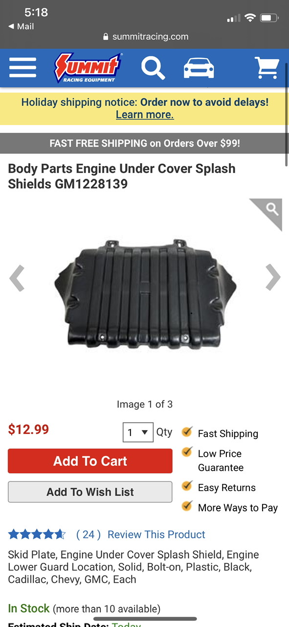

I had to replace mine and got mine from Summit Racing for $13. A perfect fit!

Sorry...the one I posted only fits up to 2014. But you might want to try Summit. I’m sure they have it for your year.

The plate is there to increase gas mileage by preventing turbulence in the engine compartment and insuring a smooth flow beneath the underbody. IT is in no way a skid plate, at least not against anything harder than the plastic itself. The same goes for any of the factory metal ones either for the base models or for the models with the "off road" package that have the metal 'chin' plate further forward. They will not protect against strikes on fixed rocks . . . they offer some protection against bouncing rock no larger than your fist.
NONE of the OEM items . . . INCLUDING THE Steel TRANSFER CASE "SKID PLATE" functions as a real skid plate! In order to function that way it would have to be very close to stout enough to jack the vehicle from that point.
Replace it with the cheapest thing you can find, pref. the OEM plastic, and your mileage will go back up slightly.
