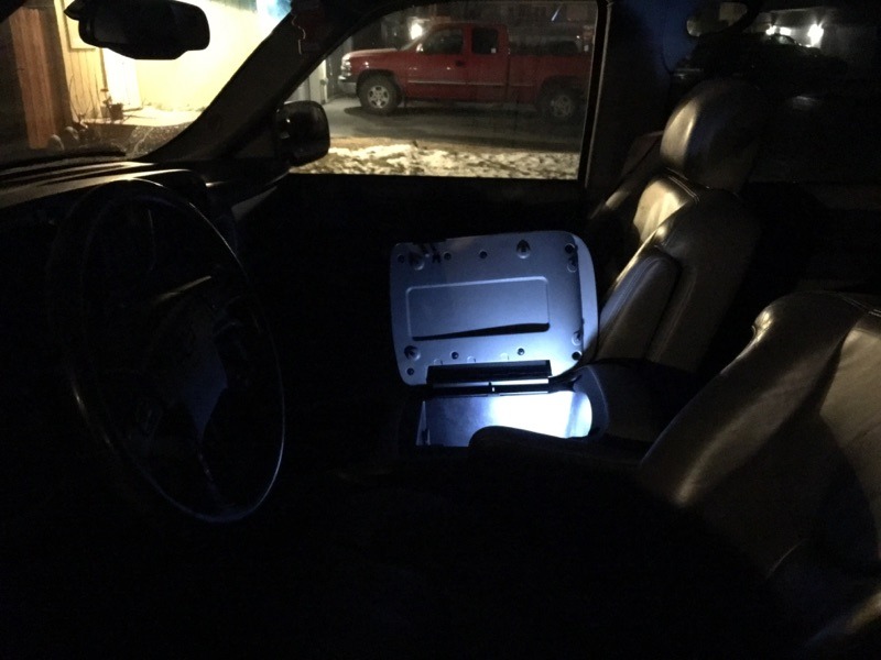

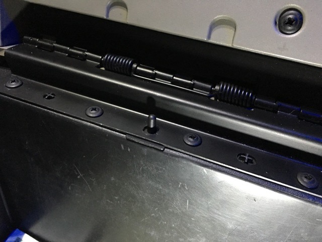

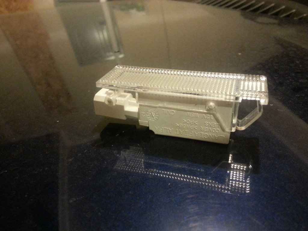

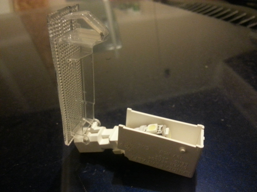

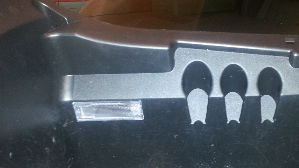

Let me start with one. For some reason none of the tahoes came with center console lights, even the fully loaded one...which i have, so I added one. I did check the esky and denali center console to see of I can just swap out the liner but that was a no go. Either way I had fun doing this mod.

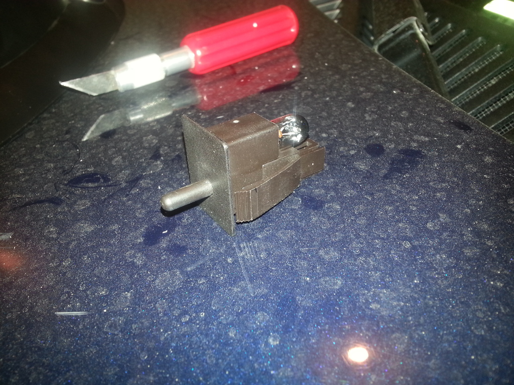

I put the light housing on the drivers side so it shines somewhat twords the passenger side with no distraction to the driver . Used a pressure switch from a nbs glove box for on/off wired directly to the battery.
I went to the salvage yard and picked out a interior light housing that fit my needs. I wanted something low maintenence and the bulb (194) can be replaced instead of with a strip if one light goes out the whole thing is toast or just looks ugly.
If I remember this particular housing came out of a mid 2000 vw.
Used a empty led 194 base as a lead from the pressure switch

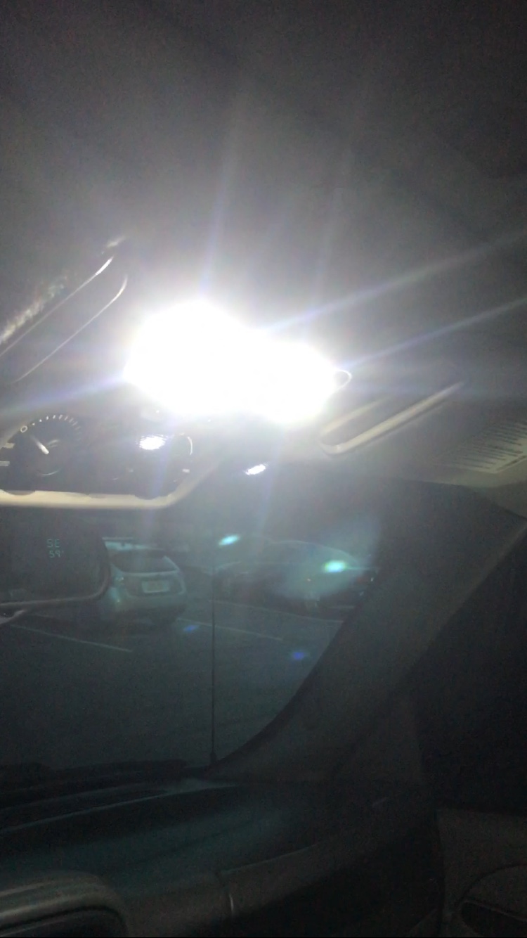

the photos don't do it justice but I did eagle eyes in place of the traditional map lights. They're one of my favorite mods so far. I did the rear ones too but they're less impressive.

I'm lost what does that mod do?
So your rear dome light have 3 bulbs right.
The middle one only comes on with the doors open.
The outside two are separate on off map/reading lights for passenger that can only be turned on with a physical button pushed.
This mod allows all 3 to light up with doors open. But still have the convienence of being able to turn one light on with the button if a passenger needs it.

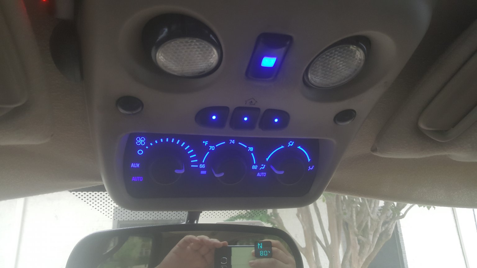

Still in process of converting the interior lights but here is what I have so far... drivers door controls except seat heaters. Full dash except radio and front a/c (on the list for this weekend), everything in the overhead console cept the map lights. That will happen soon. Still need the 3 other doors and rear hatch, center console mod, ext mirrors and I'm going to put strips under the steps and under hood. I want to put lights under the front seats as courtesy lights too.
I need to take pics. This is all I have. I'll add some later.
