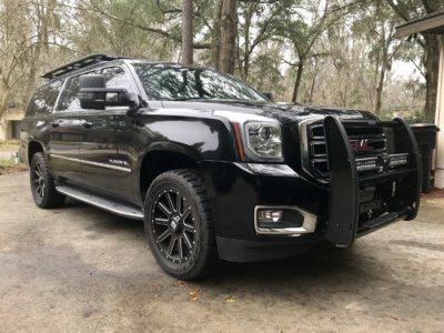

Went with the GoRhino push bar. Really happy with the fit.
Very tight but clears the bumper. Not too bad on the install either. All hardware and instructions were clear. Opted to Replace the stock front plastic fascia with correct GM insert allowing openings for tow hooks and push guard brackets.
Purchased The Westin parking sensor relocation kit for the 2 center sensors. Everything plugs right up to factory but have not found a sweet spot yet to make them happy. Getting intermittent alarms from all front sensors during low speed driving.

Curious how much attention I’m going to pull from LE with this setup. Not looking to imposter undercover suvs or slow down traffic. Time will tell. One thing is for certain, she’s looking mean!!!
View attachment 192827 View attachment 192828 View attachment 192829
What Mirrors are those that you have? Do all the power functions work properly when you switched mirrors.

+1 @jay67chevy tell us more about those mirrors! Are they from 1A Auto Parts?
Yes. These are 1A Auto mirrors. I did not opt to wire in the extra features the mirrors offer. As far as tow mirrors they do the trick. And I have basic control my orig mirrors had. If you want to tap into the proper turn signal and reverse backup wires under the steering wheel all the features should work no prob. I never had the features to begin with so under utilized is fine with me.
Hey that looks amazing. Im looking to add a push bar to my yukon and had been considering the setina bar but I think it sits a little too high above the hood whereas yours is perfect. Do you happen to have the part number? Go Rhino's website doesnt mention tahoe or yukon...
As far as parking sensors, im going to try something that another company does, they sell little rubberized sticker things that just cover up the offending sensors and apparently that tricks them...
