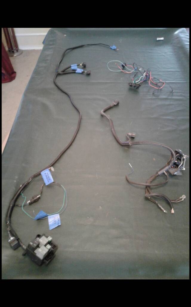

Ok I can breathe a little! I got the 03 back from the frame and alignment shop after they actually finished performing what I paid them for. Aside from getting it back together, I climbed under the hood to finish of the E-fan swap. I will tell you that some corrections need to be made to the main write-ups! While this is very popular with the 00-02 crowd....us 03 and 04 guys want these fans too! There is a bunch of info for the earlier years as well as the later using aftermarket harnesses but nothing for 03 and 04 guys using the oem harness. Yes blue pin 42 and green pin 33 is all over but which flipping wire goes where??? The main write up states green wire to green plug and blue wire to blue plug but after combing the internet with a comb there was ONE guy that said to reverse the colors! After I re-read all of the threads I noticed that every time someone like me started to ask @bottomline2000 would chime in and tell them they were either asking the wrong question or they needed to be reminded of the instructions for 00-02 or something but the questioning never progressed to the answer that I was looking for!! So....after tearing apart a perfectly good 05 Z71......THE ANSWER IS GREEN WIRE TO BLUE PLUG AND BLUE WIRE TO GREEN PLUG DAMNIT!

That's weird. In this YouTube video of a guy installing a Nelson harness the green 33 is going to the green connector and the blue wire 42 in going to the blue connector. Why did you need to reverse them?
What you just said is EXACTLY why I had such a problem getting this install done correctly the first time go round! All of the aftermarket harnesses I guess color coded to the corresponding plug! BUT....if using the factory harness....it was the opposite. Oddly the 03-04 guys are in small numbers. This was a big mod on 00-02 and for some reason not the later. Then to make it worse all you can find is info pertaining to the A/C trigger and so on. I was just grateful to have access to the 05 to rip it open. On a side note one thing that everyone mentioned was how difficult it was to remove the pain in the arse grey plastic covers from the ecu plugs. I got that one down flawlessly and should probably post that info somewhere to help others out.
Here is the ONE guy that changed everything for me!! For a good laugh....fast forward to the 4:10 mark and listen to how he describes where the wires go. His description sent me into a panic! HAHAHA
52,949
That was kinda funny. This is he first I've heard of this but I did my 02 and used an aftermarket harness. At this time I have a factory harness ready to go in but I need to use a relay for the second wire. There's a member on here (@ScottyBoy please chime in here) that's what I would call a guru on this stuff and he sells OEM harnesses and fans and helps out with install instructions so if this is something that needs to be addressed (and it sounds like it does) then I suggest we need to get this info into the tech section where it can be easily found.

I just looked at his tech article that he wrote on using the factory harness on an 00-02 and he does show the green wire going to pin 42 on the blue connector. Also, there probably isn't a blank space at pin 42 on the green connector nor pin 33 on the blue connector, correct? Is this what clued you in to look for the answer?
Just reference Scottys harness thread to keep things simple..just for reference my Nelson harness has a blue wire for the pcm tap and green ac wire tap.
Yeah what @ScottyBoy offers to forum members is awesome. A harness from him was actually on my list until I stumbled upon a complete low mile set up at the yard. The conversion work is cake but properly removing the harness from donor cars is work! Then to clean them up and offer a great product is just awesome of him to do.
As far as what made me try to figure this out was the fact that I knew enough about my install after reading A LOT was that both wires needed to go into the pcm. I remembered 42 and 33. When I finally installed my setup and went to connect the wires it hit me that I never found info pertaining to exactly what went where. I left the garage and spent 2 hours scouring the web and all I could find was the one video that I posted and he did not give me the complete confidence I was looking for! I knew I had the 05 to inspect but that truck was outside in 20 degree weather in the dark and my neighbors do not take kindly to me wrenching AT ALL! I quietly went out with tools in hand and a headlamp and started digging!

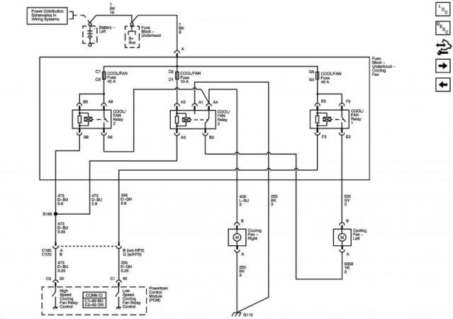

I know that I am late to the party, but it looks like you got the fans all figured out. The blue wire is the AC trigger and goes to pin 33 which is in the green connector on the PCM and the green wire is the temperature trigger wire and goes to pin 42 on the blue plug on the PCM.
THE ANSWER IS GREEN WIRE TO BLUE PLUG 33 AND BLUE WIRE TO GREEN PLUG 42 DAMNIT!
Actually that info is wrong. That's why we have conflicting information because people are used to using aftermarket harnesses which have the cord backwards. The blue wire is the AC wire/high speed fan trigger wire and goes to pin 33. The green wire goes to pin 42!! On your harness that I converted, the blue wire goes to the AC compressor wire.
On a lot of aftermarket harnesses, I think they reverse the colors for ease of installation. Because blue to blue and green to green is FAR easier to remember. Plus on the 99-02 trucks when connecting to the AC compressor wire, that wire is green. So splicing another green wire into it is a lot easier to remember how it goes. But the OEM harness is the opposite.

Look at my install thread, I covered all this back in 2011 when I installed my Efans.
http://www.tahoeyukonforum.com/threads/i-installed-e-fans-on-my-2001.28336/
Here is a diagram for further clarification as well. I know it's hard to read, but the green wire goes to connector 1 (C1) at the PCM pin 42 and the blue wire goes to connector 2 (C2) pin 33
HOWEVER, in the case of a 99-02 where you are using the AC compressor to trigger the high speed, then you would wire a relay to the blue wire like I show in my install thread linked above.
