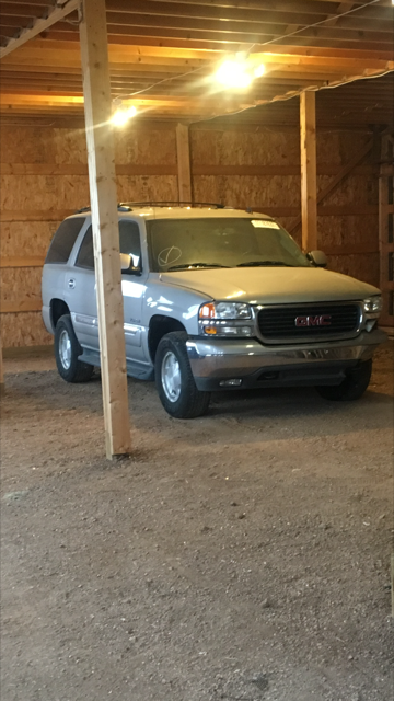

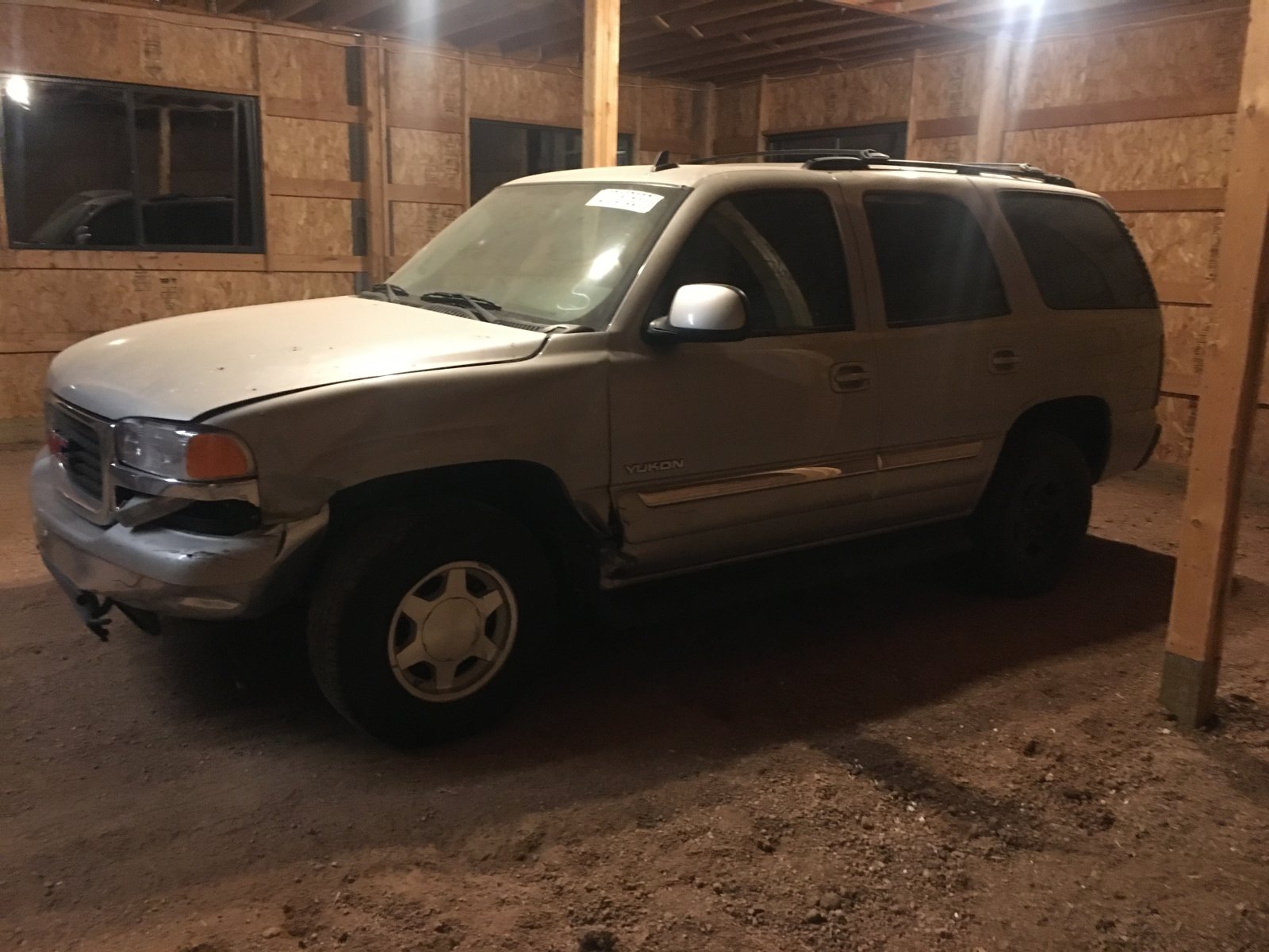

The silver 06 Yukon with 75k miles is going to be for my wife and will be replacing her 15' Honda Pilot. (I absolutely hate that thing!) It too is pristine with the exception of the obvious!.

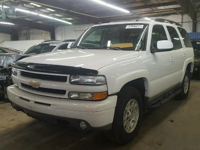

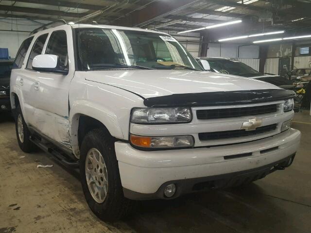

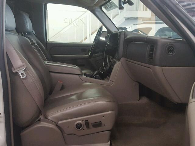

The white 05 Z71 is what I picked up for my brother in law and you guessed it....it has 75k miles on it!! I honestly do not know how I came across Colorado NBS trucks with the same low mileage but then again...that is why they are in my possession!
What I want to point out is that while I have saved vehicles that were complete wrecks...I am not ambitious about that kind of work anymore. When I do uni-body wrecks I typically pull in the tolerance numbers tighter than how they left from the factory but like I said....I don't want to deal with that anxiety anymore so I opted for the easy fender benders that appeared to be very well taken care of from the beginning.

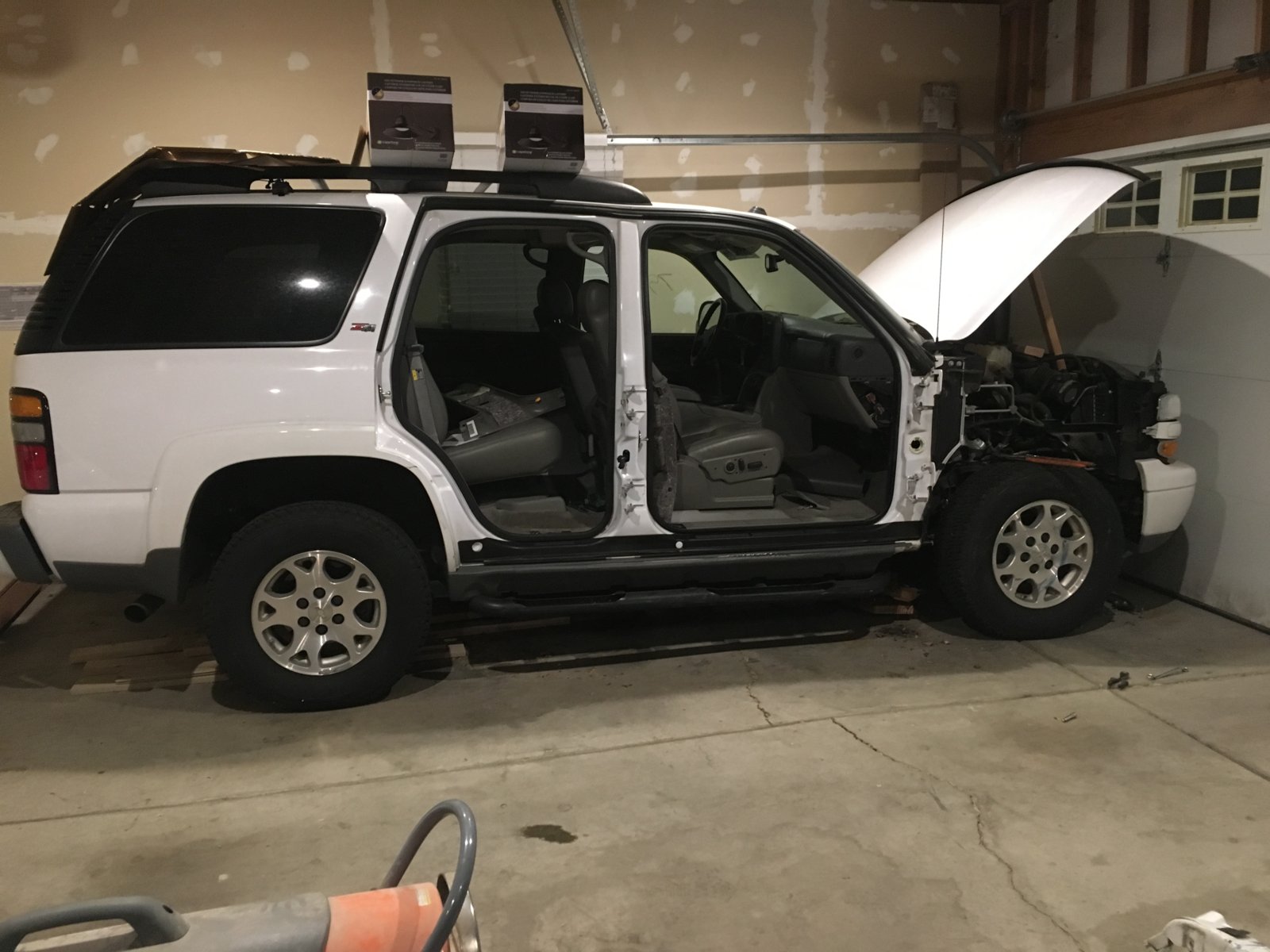

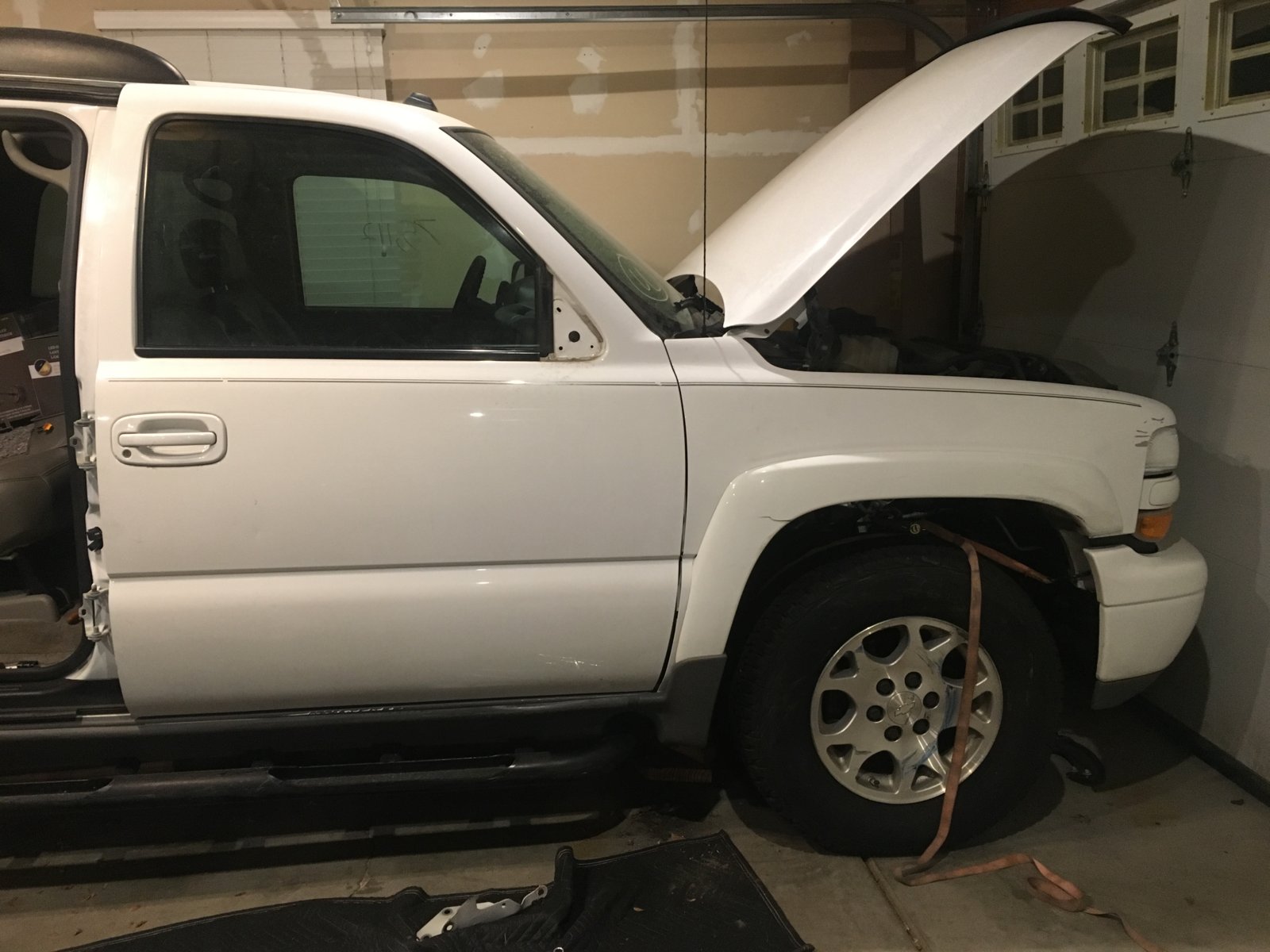

Here are pics of the Z71. The Z is getting repaired before the yukon.

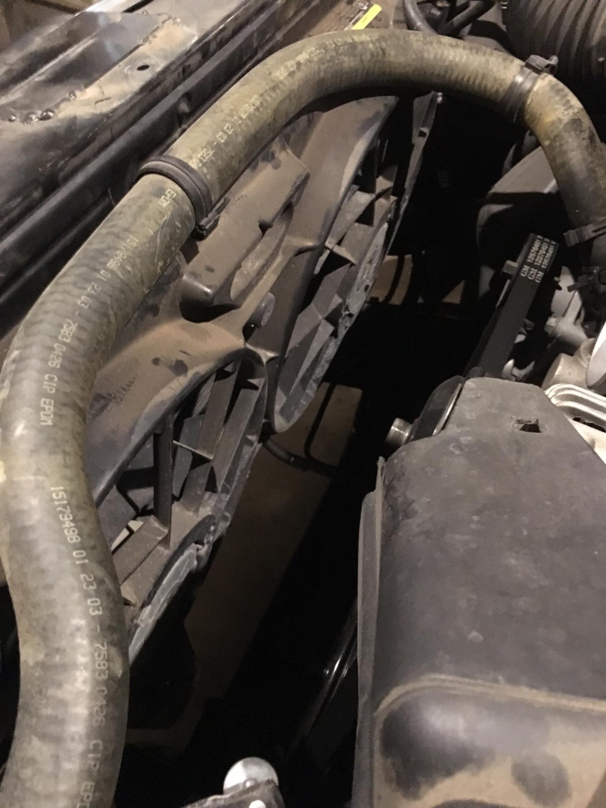

Aside from just fixing the 03....my first mod was the electric fan conversion. I managed to score the complete set up with harness from an 05 Yukon with only 60k. I stripped and cleaned the harness and added new wire loom. Unfortunately I didn't get the pic of the final product on the harness. I have to go back to the yard to get the pins out of the donor ECU and then get a tuner to activate them.

quite a collection! defiantly need more info on the fan swap
What do you need to know? I've done it. There's write-ups in the tech section. You can either use the OEM fans and harness out of the 05-06's or buy new fans and use an alternate harness although there's been issues with the aftermarket harnesses, as in melting. There's a member here (@ScottyBoy ) who sells the OEM harnesses and fans. Either way you need to plug a wiring pin into the PCM connector and have that pin activated so the PCM knows to control the fan.

Sure, I'll help you with a link to the tech section article. Read up. There's another one too from Scottyboy in there. All you have to do is stroll through the tech section, you don't even have to search. I have no idea about HP Tuners. I had BlackBear turn my pin on.
http://www.tahoeyukonforum.com/threads/how-to-install-e-fans.9400/
