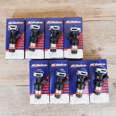

Are these injectors still in the your engine?
"Got a set of injectors on Amazon (prime) so I could get them quick,"

Be careful when buying parts on Amazon. Lots of counterfeit ("inexpensive") parts. You get what you pay for.
For now, swap the injector with another cylinder to see if the misfire follows (as @Mudsport96 recommends). That way you'll know if it's the cause. Don't introduce new parts until you can determine one is bad.

If these are OEM injectors, this is a hell of a deal...
Can someone take a look and verify?
The price tells it all. No way they're Genuine GM @ $10 each.
